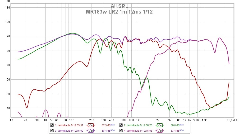

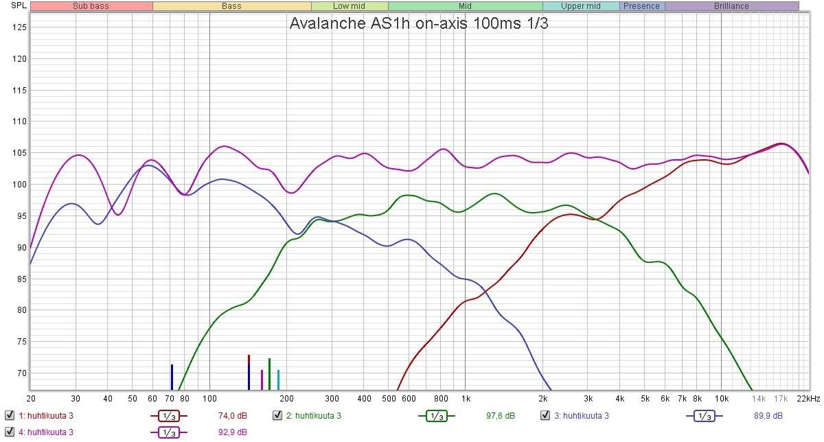

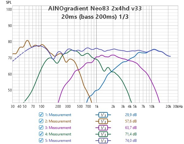

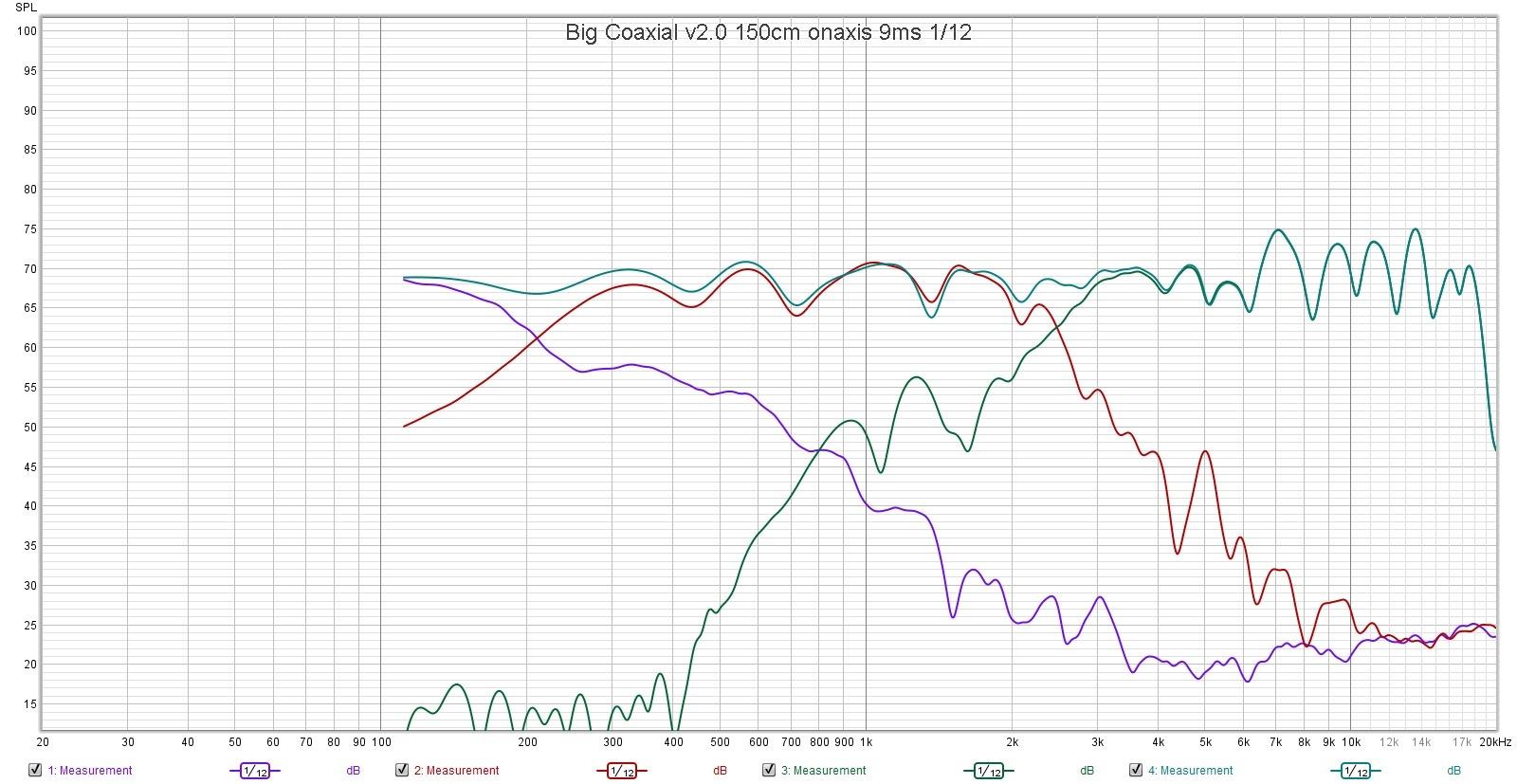

on-axis resposes of some of my latest actives. Basically acoustic LR2(elliptic) or LR4
