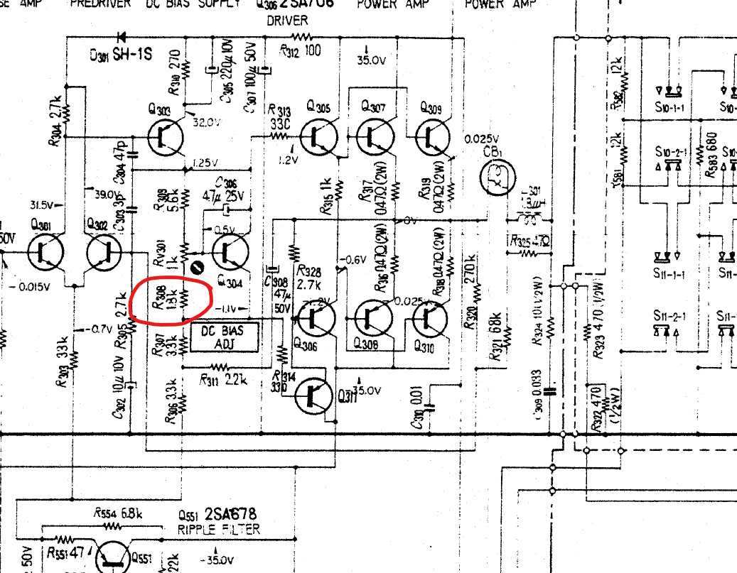

How bright should the DBT be? Or, at what voltage should the variac be at to measure voltages at those output transistor collector connection points?
Should I increase the voltage past 50 volts before making the measurements?

The DBT is there to protect. If a diode in the bridge is failed for example then nothing bad will happen, if the output stage were conducting (if the transistors were fitted) then again nothing bad happens because the current is easily within the capabilities of the transistors.
Take it to the point the bulb stops increasing in brightness and/or the point the rails stop increasing. A 40w bulb is pretty low in the scheme of things, a 60 or 100 would be more the thing to use for a power amp... just don't overthink it at this point, just try and get a handle on what is going on and where the current flow is occurring.

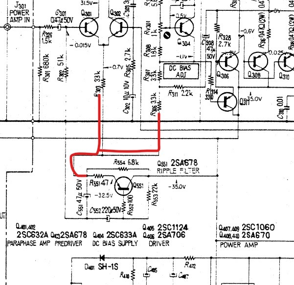

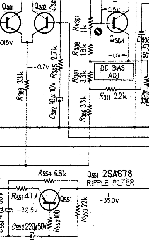

The service manual described R551 as 47 ohms and the diagram depicts it as the emitter resistor for Q551. Q551 is described as Ripple Filter. I pulled Q551, checked it and it was damaged.

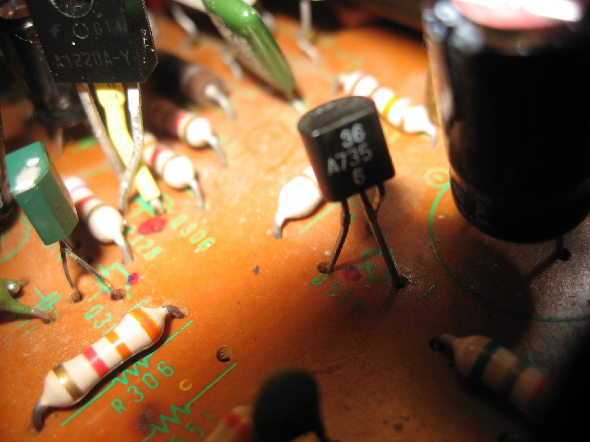

The Q551 transistor I removed from the board was a 2SA735. The service manual says Q551 is a 2SA678. There are other 2SA678's on the board so I do not think the substitute originated at the factory. I guess it was done at a later time.
Searching for 2SA735 data produced none that I could find. I am going to assume it has the same pinout as 2SA678 because it was in place for the entire time the amplifier worked while in my possession.
I am not knowledgeble enough to imagine why it failed and burned up R551 in the process.
My understanding is that KSA1015 can replace 2SA678 and I have those at hand. Also at hand are 1/2W 47 ohm resistors to replace R551.
Would it be wise to install those two components and continue the output transistor replacement?

That ripple filter only feeds into high impedance nodes. It will also feed the same points on the other channel.
I would say only a dead short on that line could do this, the 33k and 3.3k resistors it feeds can't draw anywhere near enough current through the 47 ohm to make it burn.
It has to be either a physical short on the output side of the 47 ohm or C551, which is the 47uF in the ripple filter is faulty or (if you have replaced it before) it is fitted wrong way around.
Measure across the cap and see if you read a short. If not replace the cap anyway. If the cap has been replaced before do not assume the PCB marking are correct. Check by looking. The positive end of the cap goes to ground for this one.
The KSA1015 should be fine but in any case, this part of the circuit is 'only' a filter and the amp should still work even if the transistor was linked out. Voltage and voltage out are essentially the same, it just filter ripple and noise.
Reactions: 1 user

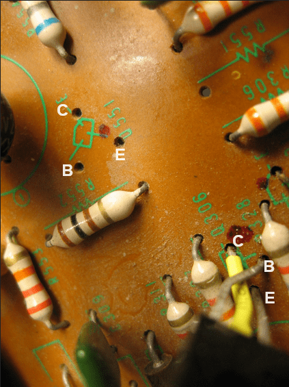

I was about to install a KSA1015 at Q515 but am hesitant until I understand just how it needs to be oriented.
It does not surprise me that something I assumed is not so.

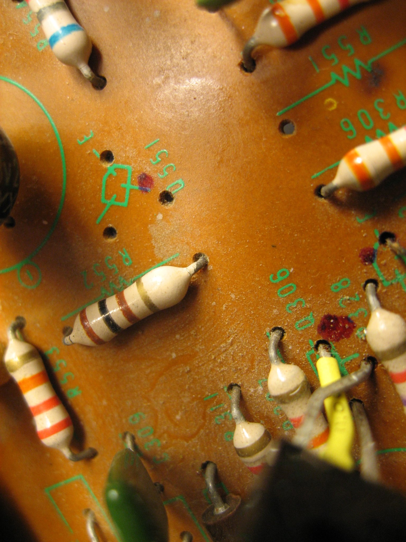

My assumption was that the 2SA735 at Q551 has the same pinout as the 2SA678 which is supposed to be there but I was wrong.
2SA678 has a pinout of E-C-B. the 2SA735 has it's centre leg in the hole marked "E" Therefore it must be C-E-B or B-E-C and I do not know which because there is no data sheet for a 2SA735 anywhere that I could find. There is mention made of it but absolutely no details.
So I cannot duplicate it's positioning with a KSA1015.
The silkscreen printing of the transistor outline which is supposed to show how to orient the transistor confuses me. The original 2SA678 has a beveled corner and the diagram depicts that. And the hole by the beveled corner is marked "E". But for some reason, I cannot with certainty decide which way the transistor should face. It be easily be made to fit in either direction.
I can't settle on if the Collector leg should go in the hole nearest the red dot or if it should be the Base leg. I think that is where the Collector leg should go but I am not certain.
And I cannot explain the red dots - I did not put them there.
Well that is a bugger because you are right.
Whoever applied that red dot may have done so to identify the Emitter and the factory silksecreened "E" is wrong.
So now, because I replaced at least two other small transistors and I used that letter "E" as a guide to orient them, I need to reinspect them to see if they are installed wrong.
I beleve that they too were originally 2SA678.
EDIT: In case it's significant, I measured the voltage at all three solder pads of Q551 and read around (-)42 volts at all of them That was when using a 100W DBT.
The diagram shows (-)32.5V at Collector, (-)35V at Emitter and I don't see what voltage is supposed to be present at Base.

To be 100% sure for any of the transistors first look at the circuit and identify key parts that go directly to the leads of the device.
For example for Q551 physically identify which hole connects to directly to R551 which is the Emitter, identify the hole that goes to R552 which is the Base and the hole that goes to R553 is the Collector.
The Emitter is always the one with the arrow on the diagram. The collector should be the most negative for a PNP transistor like this.
