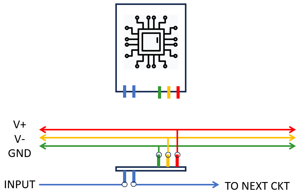

I captures some nascent ideas on how to connect a series of vertical daughter boards on a motherboard in the attached image. A cartoon of the board is shown at top. Connections are blue for signal IO and green orange red for power supply connections and these are made on opposite sides of the daughter board. On the motherboard, traces run front to back next to each other and cards plug in along the way. When a card is not needed the signal IO connection is simply bridged by a jumper.
If the signal goes through all boards in a set a stack is a good possibility.
I inderstand that ultimately the signal has to get back to the motherboiard (the 'dangling' wires), but they would be as long if they were tracks, so that wouldn't be an issue.
And you can always twist a signal wire with a ground wire from the top of the stack back to the motherboard in a quasi-balanced mode.
@rayma's way would also work but probably have longer wires/tracks in case the signal goes through a series of boards.
But in the end, with such a small board, it's probably not making a difference anyway and you can select what is easiest to handle for assembly/replacement.

Just for complete information, I would like the design to feature up to 16 "lanes" (assuming the daughter cards on edge concept) with each lane accommodating up to 4 cards in a "row". So in total that is 64 daughter cards. Each lane is a trace that runs more or less all the way from front to back of the motherboard PCB with 4 spots to either plug in a daughter board or jumper/byapss. Lanes could be connected to the overall input or to other lanes, to allow for various signal routing configurations. Not 100% sure how to lay all of that out, but I think it is doable on a board with a single layer on each side....
Next up, how to distribute V+, V-, and PS GND to all of those cards??? Seems like a lot of PS related tracks running around. Maybe use lots of local decoupling? Two sided PCB with one side having a signal track layer and a signal ground plane, and the other side having PS V+ and V- tracks and PS ground plane?

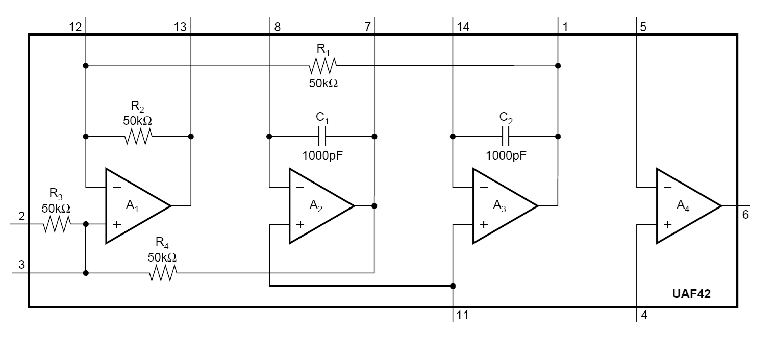

There is precedent for this: for example TI's UAF42. See circuit diagram, attached. It's a DIP-14 IC.
I could use SMD components and then it might resemble something like a discrete op-amp. The larger components like caps would be off board. But that would be a way to make the "daughter card" very small indeed.

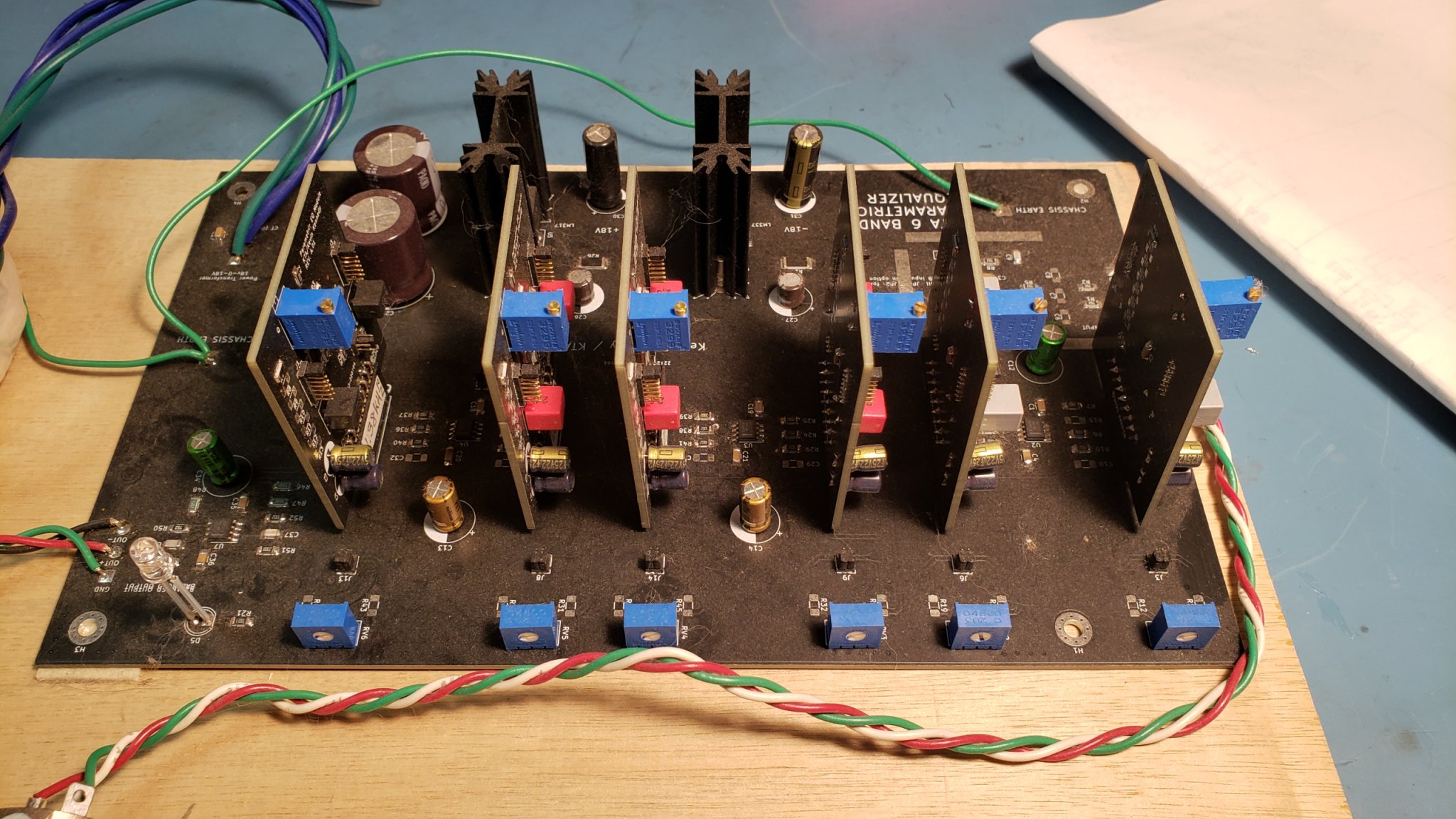

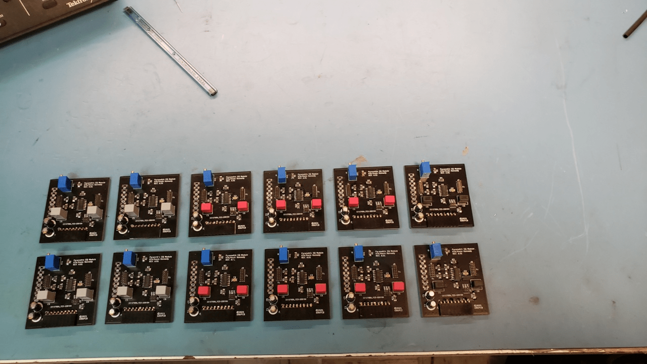

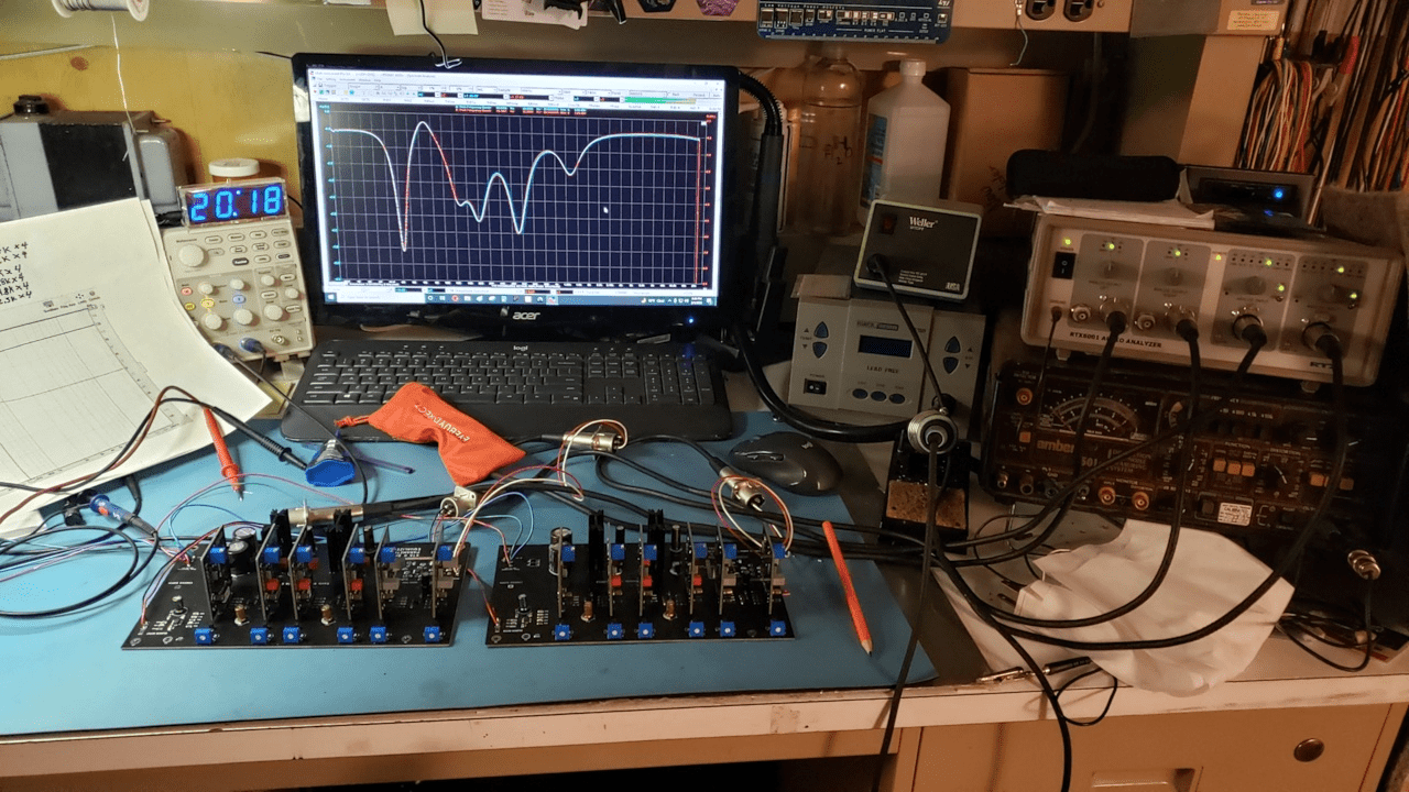

So a few years ago I designed a last gasp parametric speaker equalizer before I conceded that it was time for DSP. Mother board and modules all 4 layer PCB. Worked well and met its electrical design objectives, but proved unequal to the task.
Probably as a much a hint about what not to do as anything. I like the idea of plug in modules, but would recommend 2 rows of pins rather than the single row. Gold will be more reliable in environments like mine on the edge of the ocean. Had this continued in use rather than languishing with its companion in a dark corner of my listening room/lab I would have secured each board with a small puddle of hot melt glue. (Sorry for the dust filled pix.)
Soldering is more reliable but less flexible.
The cards are just basic SVF filters with options for LPF. HPF, BPF outputs jumper selectable as is the filter frequency setting which was inconvenient to say the least. (The cards were built to cover specific frequency ranges which could be adjusted over a limited range by moving jumpers.
There are 3 lanes each with two cards, the second and third lanes and one card slot in each of the 3 lanes can be bypassed by jumper setting, allowing for 1 - 6 cards as desired. The lanes are sequential (series connected).
Lots of dust. Mono, balanced I/O.
