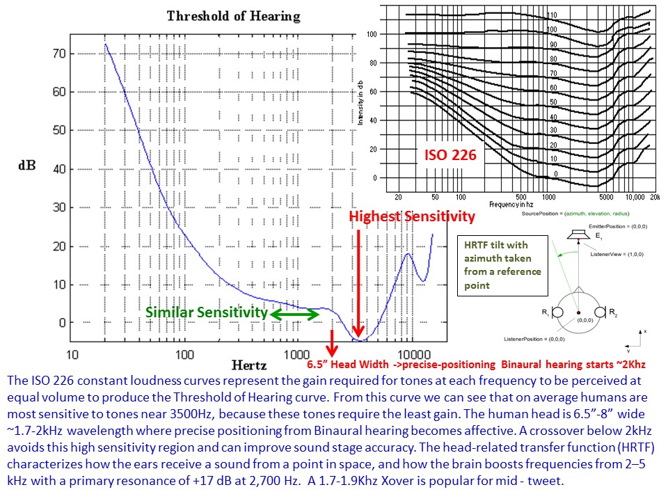

You want BASS. The WinISD simulation in post #22 shows that a ported volume of 2 - 2.3 cuft is desired for the 10" SB29NRX75-6 woofer. Your work with speaker standmounts should confirm that a maximum 24" high cabinet is desirable. SO, run a few dimensions through a spreadsheet and a 24" high x 15" wide x 16" deep is one good option for 2.3cuft empty. I selected a 15" width because: (1) the speaker frame is 11.4" diameter; (2) to reduce the air pressure between the rear cone and cabinet walls. Ports can be located on front, rear, side baffle.
Do you favor different cabinet dimensions?
I selected a ~6" diameter midrange with a "low sensitivity" crossover between 1.7 - 2 kHz because of exceptional reviews for Xairos, Aldephos, Kalasan, Music&Design.... to maintain constant directivity with the tweeter, to attenuate cone breakup distortion.
