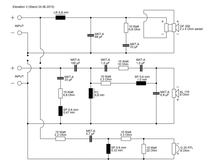

As mentioned the unique way your enclosure has a very low mounted side facing sub woofer
works out since the bass is non directional.
The real trick would be a very low crossover point to make the distance work out.
And the midrange also needs to be crossed over low enough for everything to work.
I would just use the Sub, Midrange, Tweeter
From a Visaton Elevation 3
The baffle Size, Driver Size and Midrange/Tweeter arrangement is very similar.
Ironically the tweeter is mounted in a similar matter.
and the Sub that is being used is also a 8" driver mounted low.
It is not necessarily a "kit"
But the crossover design and parts list is available.
GF 200 - 2 x 4 Ohm
AL 170 - 8 Ohm
G 25 FFL - 8 Ohm
