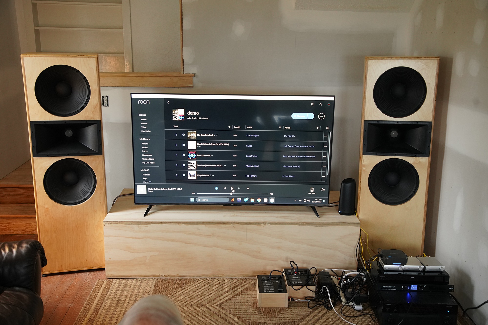

Like these?
https://www.reddit.com/r/audiophile/comments/cj120x
Something like Paul Carmody's Classix 2.5 or Tarkus 3 way would be worth looking at, although the cabinets are higher than you want, about 900mm. I second the suggestion to look at Speaker Design Works' projects. Wolf's Zingers have received excellent reviews, they're an 8" two way.

Hallo FrederikI hope that you can give me any suggestions.
I've been thinking for a long time about what I would recommend for the "first time".
In my opinion, @Spillingvoid did everything right his “first time”.
He built two small full-range transducers into two surprisingly large boxes. (The two large boxes with the small transducers left and right in the photo in posting #9)
https://www.diyaudio.com/community/threads/first-set-of-floor-standing-speakers.412255/#post-7678560 (#9)
Do it for under 100€ for the two transducers (Sd ~ 50cm²). Build two boxes as big as feasible (50 Liter ;-) ). Do not Helmholtz! Fill the boxes with really big loads of fibrous stuff (before glue up). Place them as close as possible to / at the wall behind the TV. Use your Onkyo A8820.
Now you have 500€ left for active subwoofer(s). Place the sub very close to your sofa (behind/under).
