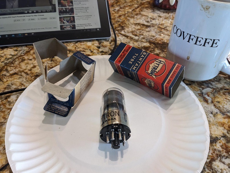

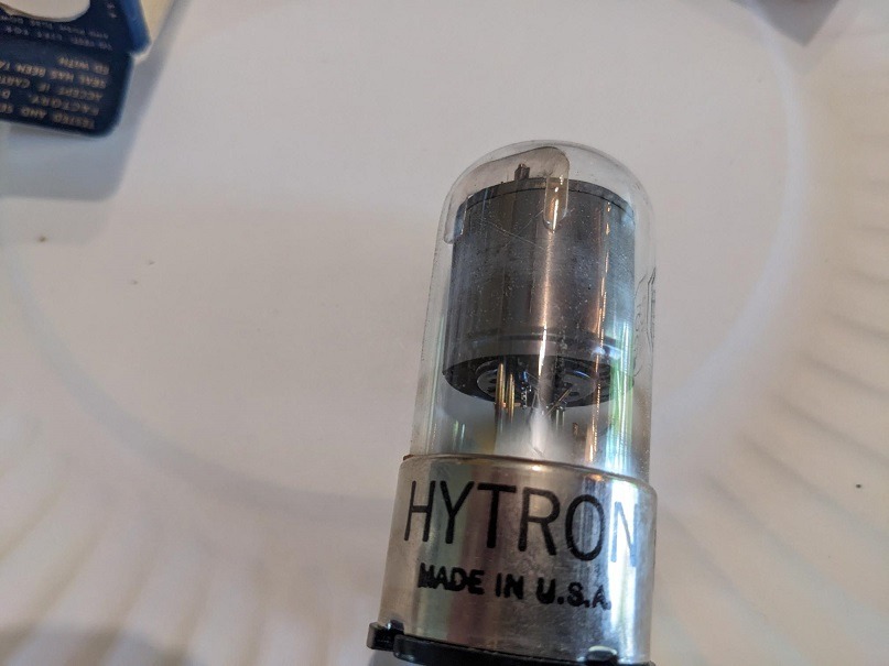

The 6c5 is a 6sj7 wired as a triode at the factory. That means it has the screen grid and shield of a pentode.I picked up 25 NOS in boxes 6C5 (Hytron) tubes a while back, pristine, even the boxes look like new. 6C5 is the predecessor to 6J5, it is very cylindrical, looks like a church bell hanging over the rather beefy cathode post. It has extra mica supporting the cylinder. I haven't tried them yet but I would think a cylindrical bell-like plate might be more prone to pick up vibration.
View attachment 1307677 View attachment 1307678

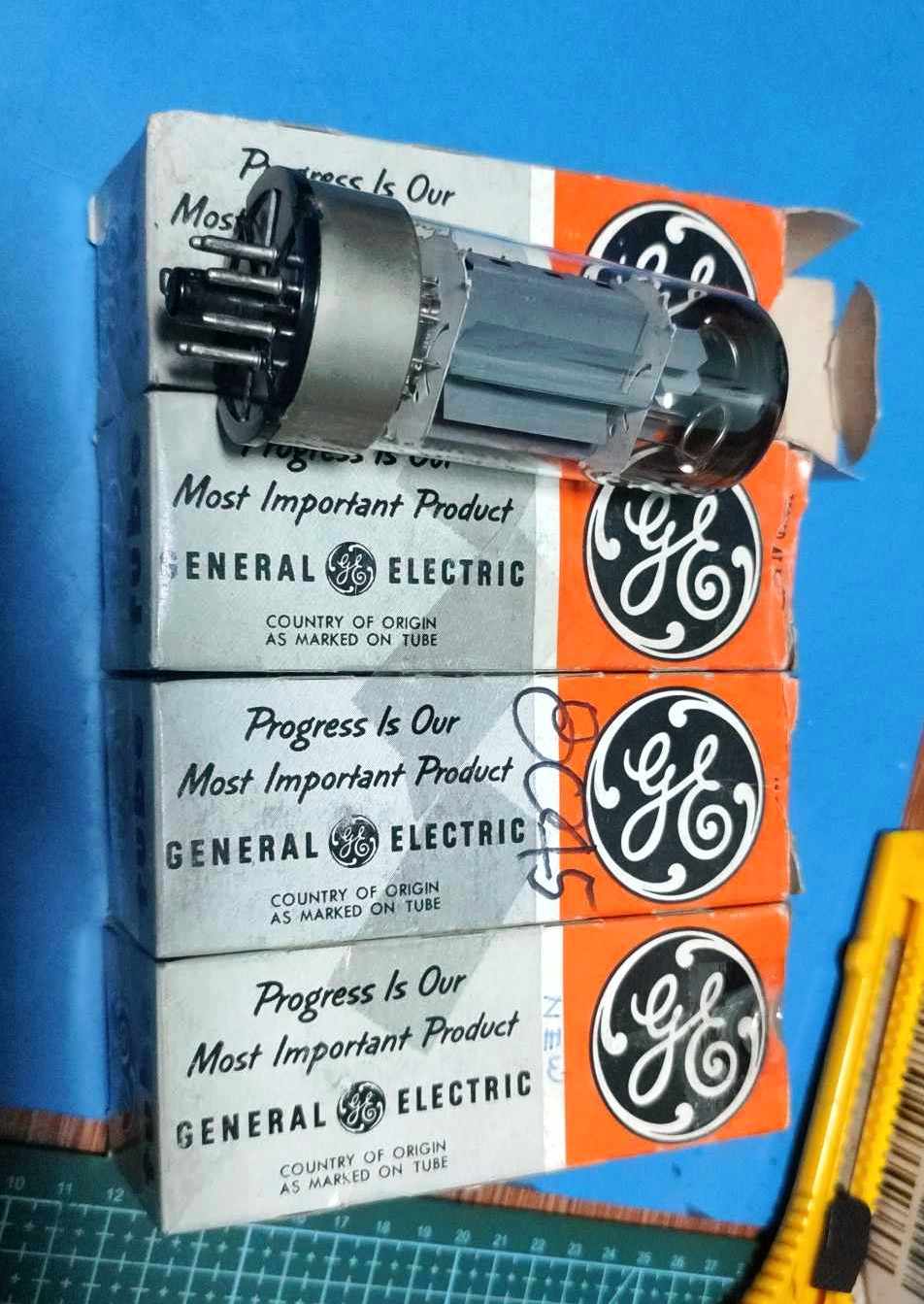

Indeed, the 6F6S has round plate but has more gm in the same conditions ( like 3mA/V vs 2) and uprated specs: 410V plate voltage, 315V g2 voltage, 12W plate dissipation and 4W g2 dissipation. Can squeeze more power, especially in triode mode with higher plate voltage. Something like 2.5-3W for triode in class A1 and 5-6W for pentode.
