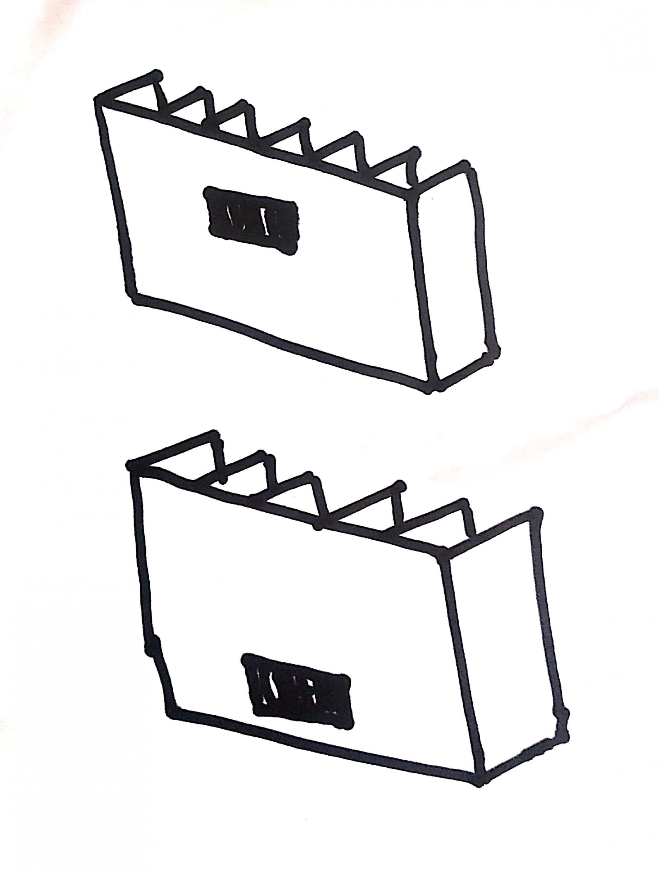

In principle centered is better but centered horizontally and somewhat shifted vertically as in your second option is practically same, since heatsink main body (not the fins) is usually quite thick.
It would be more critical if heatsink were, say,an aluminum back panel which would be much thinner, say 1 or 1.5 mm thick, but I guess your extruded heatsink is at least 2.5 mm thick, a big difference.
ThanksI would use 1/3 : 2/3 below:above ratio.

- Effective IC position on Heat sink
