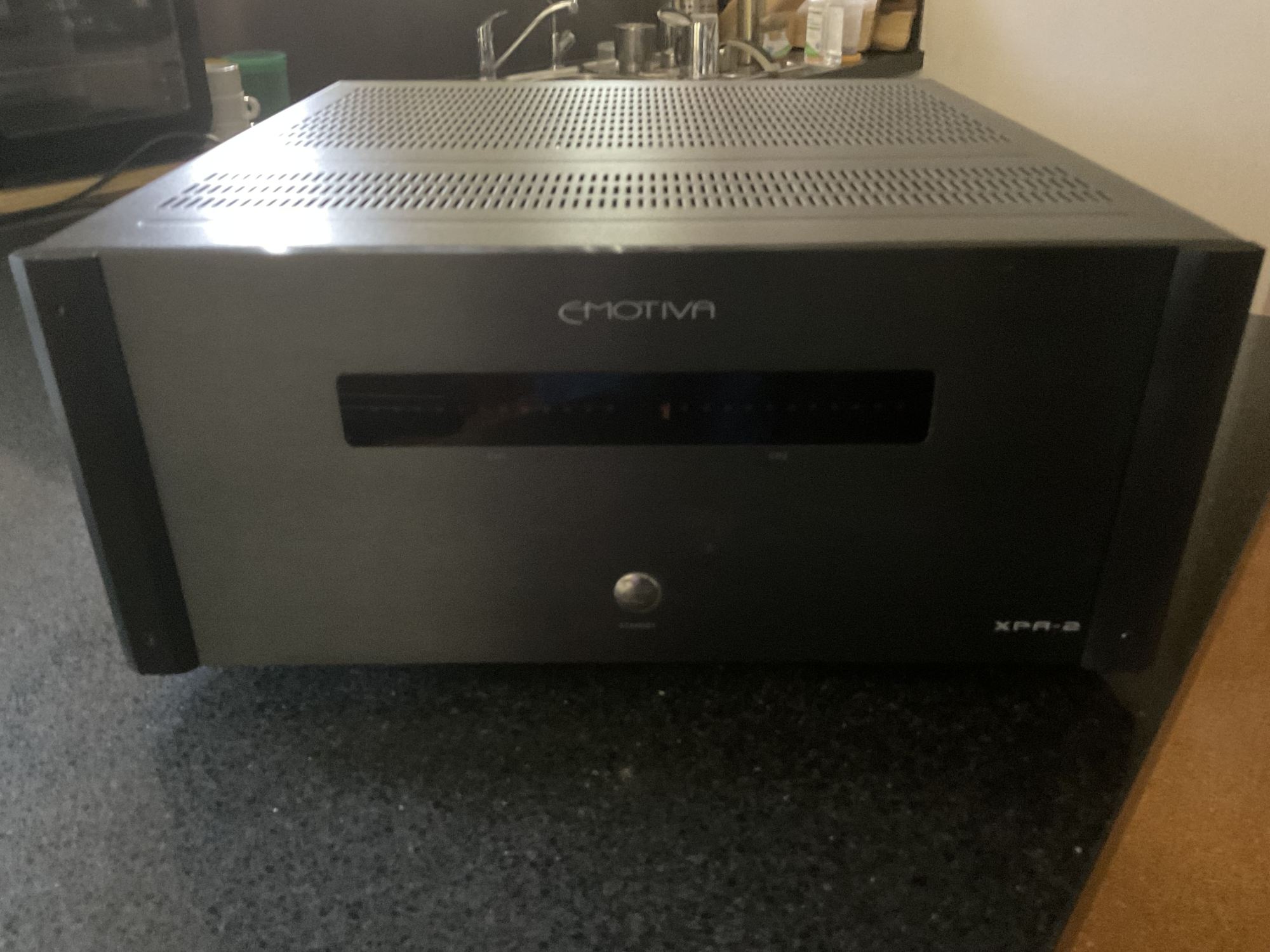

Hi Guys,
Scored an Emotiva XPA-2 gen 1 power amp today for not much $

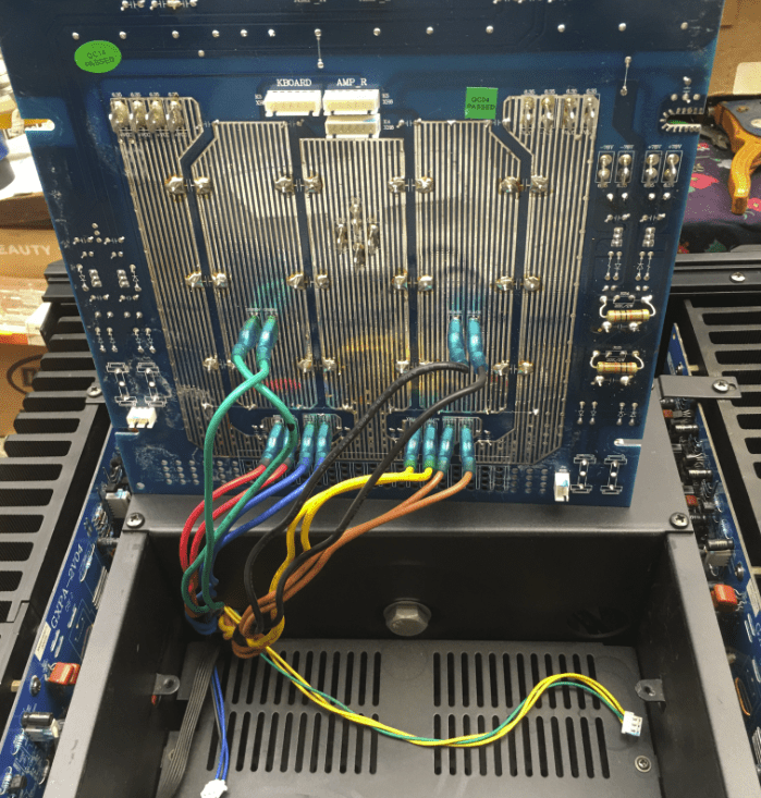

Issue is that it tries to turn on but goes straight into protection mode. So like any curious DIYer, off with the lid !

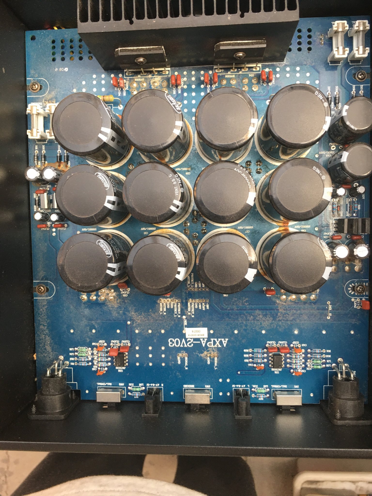

Jeebuz :oops: what a beast !! This thing weighs in at 35kg, has a 1200VA toroid and 12 x 15000/50V electro in the main pwr supply.
Rated at 300wpc these appear to be quite well regarded.

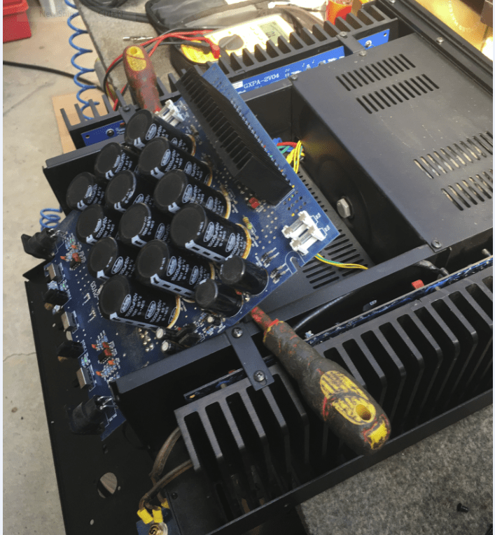

Anyways, I've pulled the DC power supply board but can't find anything that stands out as failed.

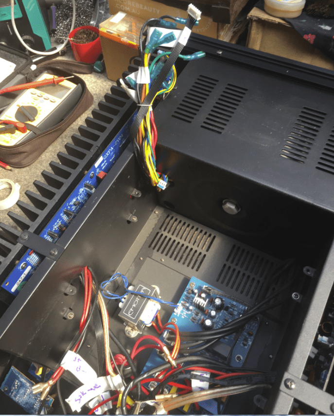

This thing has a soft start board that can auto select 120v or 240v and is also tied in with the protection circuit to open the mains relays if a fault is detected.
It is powered by its own 10va transformer.
Anyways, looks like it tries to power on, lights come on and relays click, then after 2 seconds, it shuts down.

Amp is up and running !
I did get schematics from Emotiva , which helped.
Recapping was just the start.
Turns out a faulty bias trip pot fault caused very high bias currents, which damaged the main PCB on the left channel.
Got all that sorted.
Anyone interested in this repair or need the schematics, let me know.

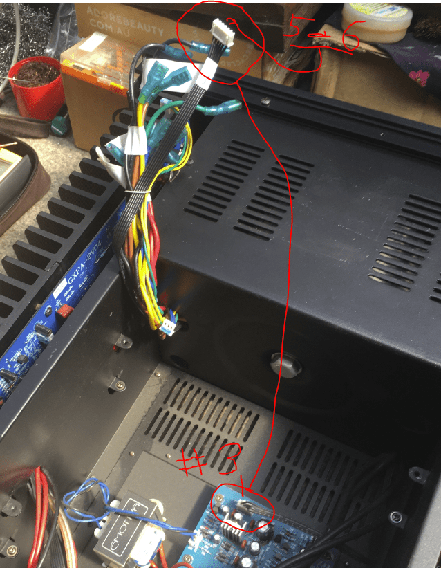

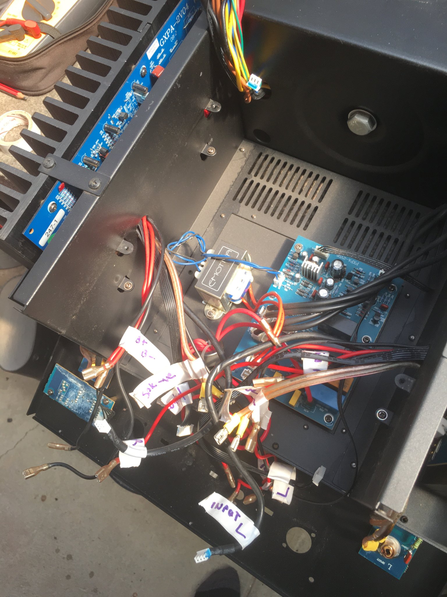

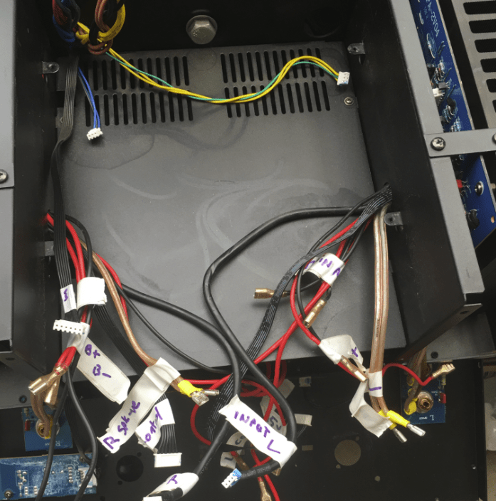

To get access to the soft start board etc some disassembly is required
Main lid and rear panel off
power supply board ( the one with the big caps ) needs to be disconnected and removed.
the metal plate under that board needs to be removed
you can now see the soft start board
So what I did was to take +5volt from pin 3 on terminal K2 on the soft start board ( schematic PXPA-2 ) and feed that voltage into the L & R protect terminals 5 & 6 on connector K3 ( schematic AXPA-2 )
Making sure that all of the transformer secondary terminals are isolated from each other and the chassis, I then connected power, truned on the rear panel switch, an pressed the front panel button.
All LEDS turn red, and then once the protect board says all okay, 3 x front panel LEDs turn blue.
You can now measure the AC from all of the power transformer secondary windings. ( AXPA-2 )
If the amp now powers up, the fault is either on the main power board ( the one with the 12 BIG caps on it ) loose connector etc or on one ( or both ) of the amp boards.

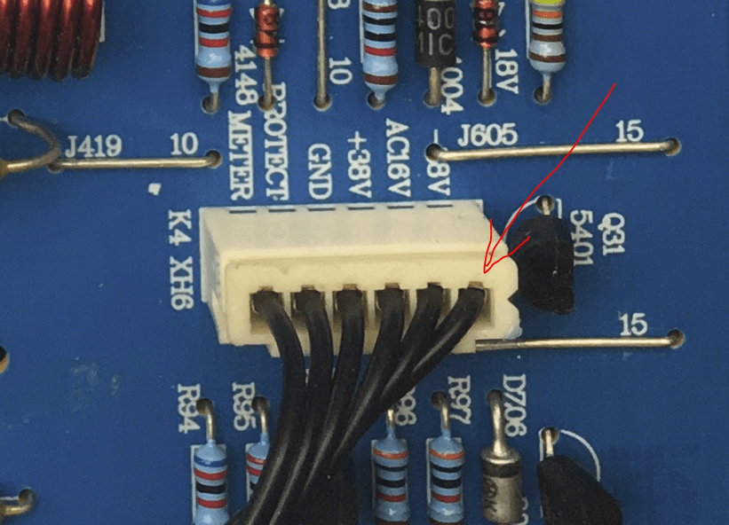

The amp board has to output a voltage on pin 2 of the K4 / K5 connectors to tell the protect circuit that the amps are good-to-go.
If protect is engaging, then the protect board is NOT GETTING the ok signal via those circuits.
The problem is that if there IS an actual problem on one of the amp boards, and you FORCE power to be applied, really BAD things can happen !!!!!!
So, take your time.
Verify continuity along all paths of the protect circuit. ( my issue was a backed out terminal pin on the protect terminal block on the left amp board that was for the -38v supply. Simply refitting the terminal pin correctly in the board and re-soldering sorted that out ! because the protect circuit on the left amp board was now working properly and sending the okay signal down the "protect-L" terminal to the protect logic board.
