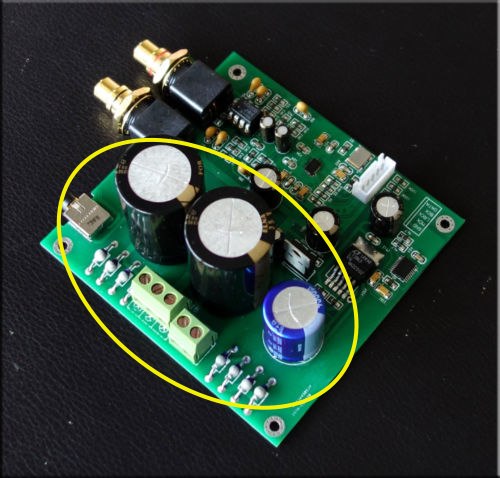

you wrote there was psu on the board, so I only need 1 torroidal +18/-18V(or +-15V) and 1 torroidal +12V(or 8V) to make it work?

There are two PSU on the board, for digital and for analog part.
You can use one torroidal with a secondary windings of 15-0-15 and 0-9 V.

It need just one torroidal +15/-15V on power, it is a good board, simple and gets all points of good sound needed, no LPF, so use RCA out to external amp
It can use Picore but if you connect via I2S you will get native DSD 64/128 not DoP

I would be interested in these measurements! The main disadvantage of the old board to the new one might be the same ground for digital and analog section as they use the same PSU. In +15V-0V- -15V mode the output DC blocking caps on old board can be bridged and the following tie down resistor can be removed. This might improve the measurement data as an mono-polar aluminum cap is not a good choice for DC blocking in Signal path..

Here are some measurements on the ES9038Q2M Board.
The first file contains measurements using the original circuit and with a different op-amp.
The second file contains measurements using the original circuit and an alternative output stage.

I agree. The output filters are quite similar and use the same topology.
I have measured the performance of the "old" version. In case someone is interested, I can post the results here. Warning: the numbers are not impressive.:eek:
