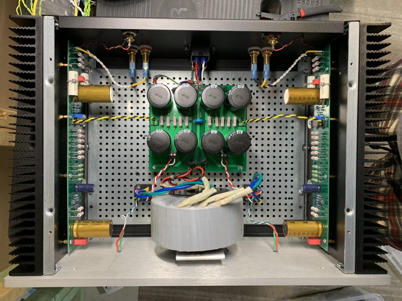

I connected the amp and have very little gain. Not sure what the problem is, but when I was doing my initial testing using my phone and some test speakers I had to max the volume to get sound. I put the amp in my system and it plays at low a low volume with the pre turned almost all the away. This is with a VTA SP14 that has a lot of gain. When I turn the volume up all the way the right channel distorts.
I set the bias on both channels to 12.93, because that was the max bias for the right channel.
Power supply under load is 24.17VDC.
Next step is to make sure all the parts are the right values and in the right spot. I built both boards at the same time, so it is not inconceivable that I made the same mistake on both boards.
Any help on what I should look for first would be appreciated.

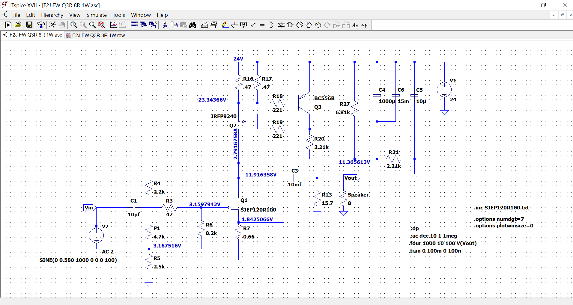

Adjust pot to get a reading of one half of the DC-supply voltage just in front of the outputcap. Connect your DVM to GND and in front of the outputcap and adjust P1 to get the correct reading.
24.17VDC / 2 = 12.085VDC
Try that...

Also one thing to check is the Iq. Measure voltage across R16. R16 is paralleled with R17, so the combined resistance is 0.235R. Current should be about 2.7A, so voltage should be 0.235R x 2.7A = 0.63V.

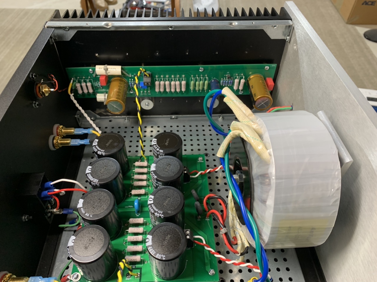

I’m confused. Adjusted the bias to half the power supply. The power supply is 24.2vdc under load and bias is now 12.1vdc. Tested the AC voltage out of my phone using a test tone and it is .393v, but the voltage out of the amp is .080. It is the same in both channels.
The audio path is so short and voltages appear to be correct, so I’m at a lose. Any help on what to check is very welcome.

What value do you have in R6 (8.2K or 100K)? To confirm, have you skipped R2 and Z1 (protection nonsense parts)?
If so, find the end of R2 that connects to C1 and R3 and measure DC from there to GND. That's your gate voltage to the Semisouth - what is your gate voltage?
