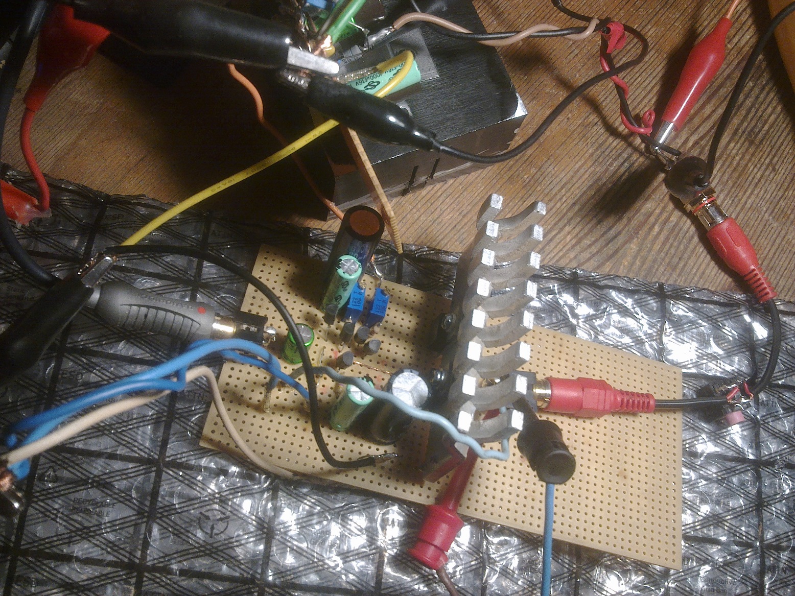

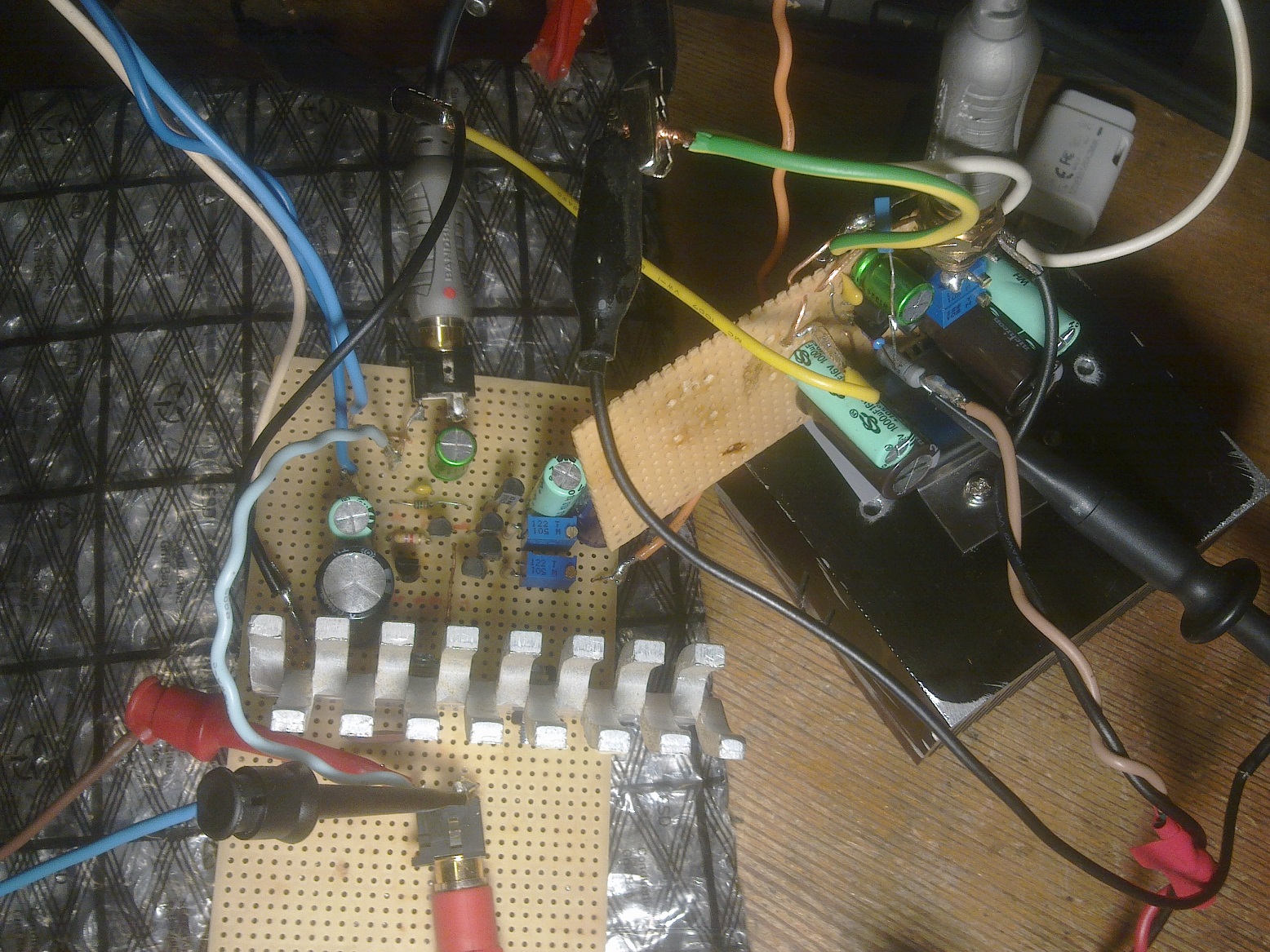

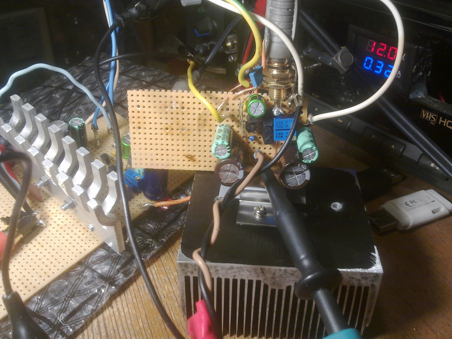

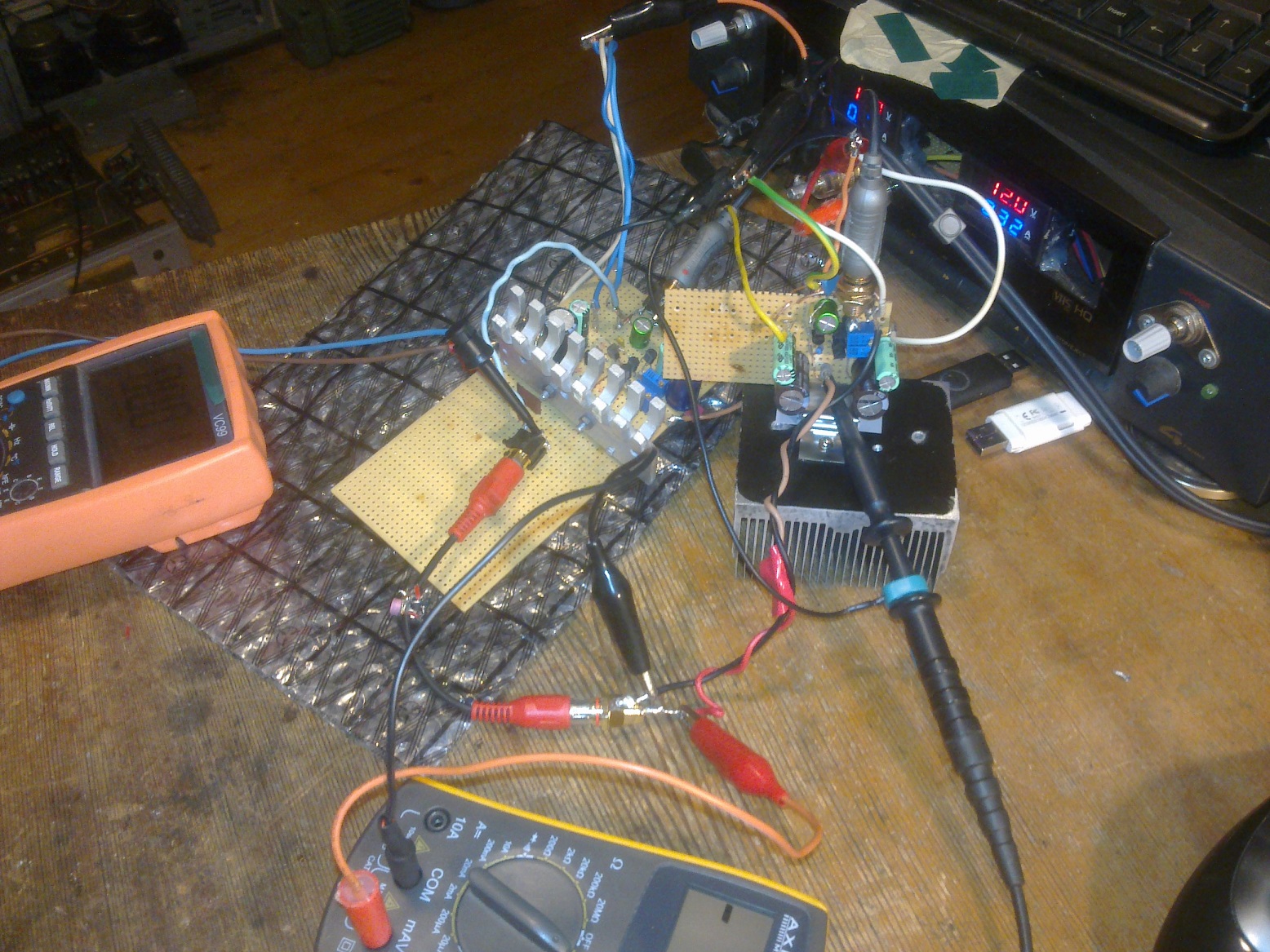

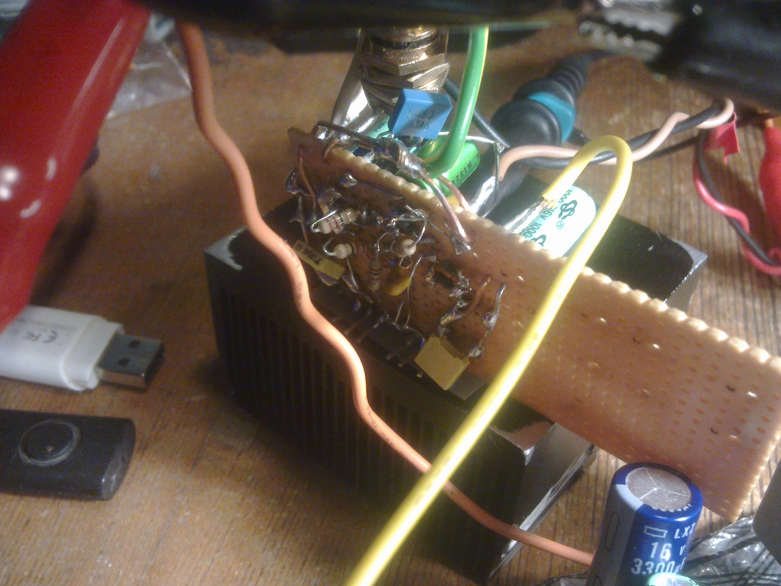

Got 2nd ready.
Fired them all up with ZOBEL networks installed (100nf, 27R) and 10R 3W Wirewound output series resistor!
With bias 200mA per channel:
First i notice, they seem to be a little slower in music "rhythm" compared to NAIM 140 amplifier :D Maybe its the headphones... but i like the sound this way from post 86. schematic.
Up to 35% volume:
Sound is nice, pleasant, lots of background, imaging... music notes doesn´t fade or disappear when rising volume to a named point.
Piano seems almost like real, maybe a little bassline from the lower piano notes are missing... just a little..
I am comparing this to a power amplifier :D
Pendulum in Silico 2008 for example, drums are great ! Slam and bassline - its all there and shaking your head inside out!
From 35% volume and up:
Too many highs, they cover almost all the notes in the music.
I could listen to Psy Trance only @ that high volume, with 50-70% volume it is kicking hard, u almost can feel that its coming inside your head.
It seems that there is too much gain again?
Besides, i don´t feel headphones clipping anymore... @ 80-90% volume... but its intolerable to listen, cuz of the HIGH´s ruining all the party :D
Should i try new values or e_fortier might have better idea ?
EDIT: I later cut both Zobel networks at the same time while listening to pendulum, no difference in sound imo :D
Pics are taken @ first hook up:
EDIT2: Forgot to mention that there is a lot of middle tones in the music, female voices are superbe(Y)

Strange that you have a gain increase at higher frequency, the global feedback and Zobel should prevent this.
Is your volume hardware? If yes, where is it located in the circuit and what it's value. Maybe you are creating some sort of filter at the input causing the low frequency to decrease.
Have you tried a different pair of headphone ?
Best regards,
Eric
No, volume is software... WIN 7 mixer :D
Yes, You are right, its something else creating it. It does not roll off bass frequency´s. high notes are just gaining too much dB.
Bass stays, actually low frequency starts to produce huge pressure on the ears... u feel the cans are vibrating hard @ full volume.. also lots of HHHHSSSS of highs and thats about it. LOL
