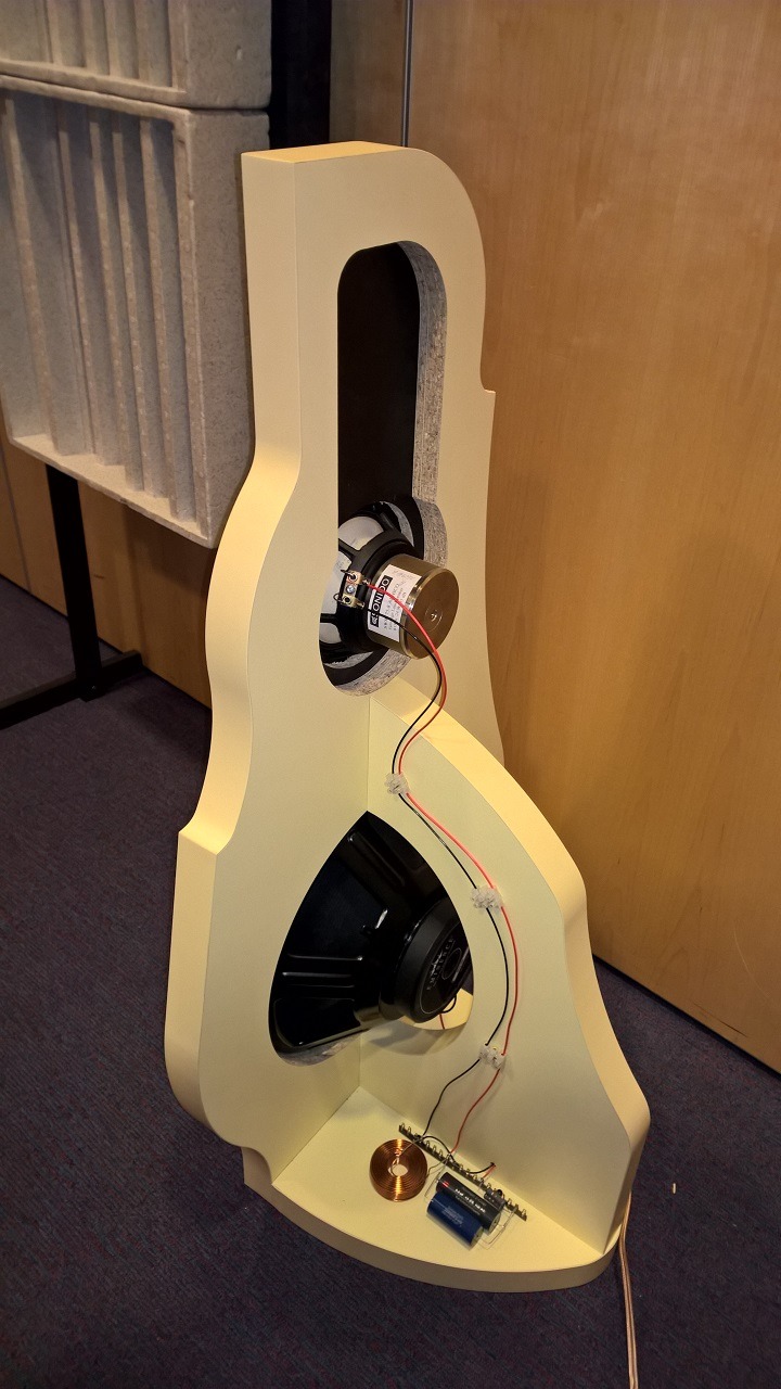

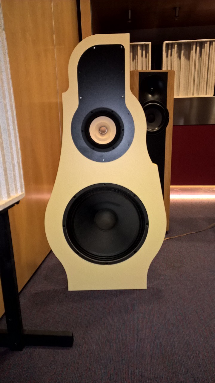

Two designs right now that I feel are at the top of their game.
The Bitches Brew
https://evo2.org/wp-content/uploads/2023/07/Bitches_Brew_Open_Baffle_Live_Edge_Speakers.pdf
and the Qualio IQ
https://www.qualioaudio.com/products/qualio-iq-1
Two different approaches, but they would both deliver great sound. You could almost ditch the tweeter on the Qualio since the SBA mid reaches 10kHz. Or keep it for when younger friends/listeners come around.
