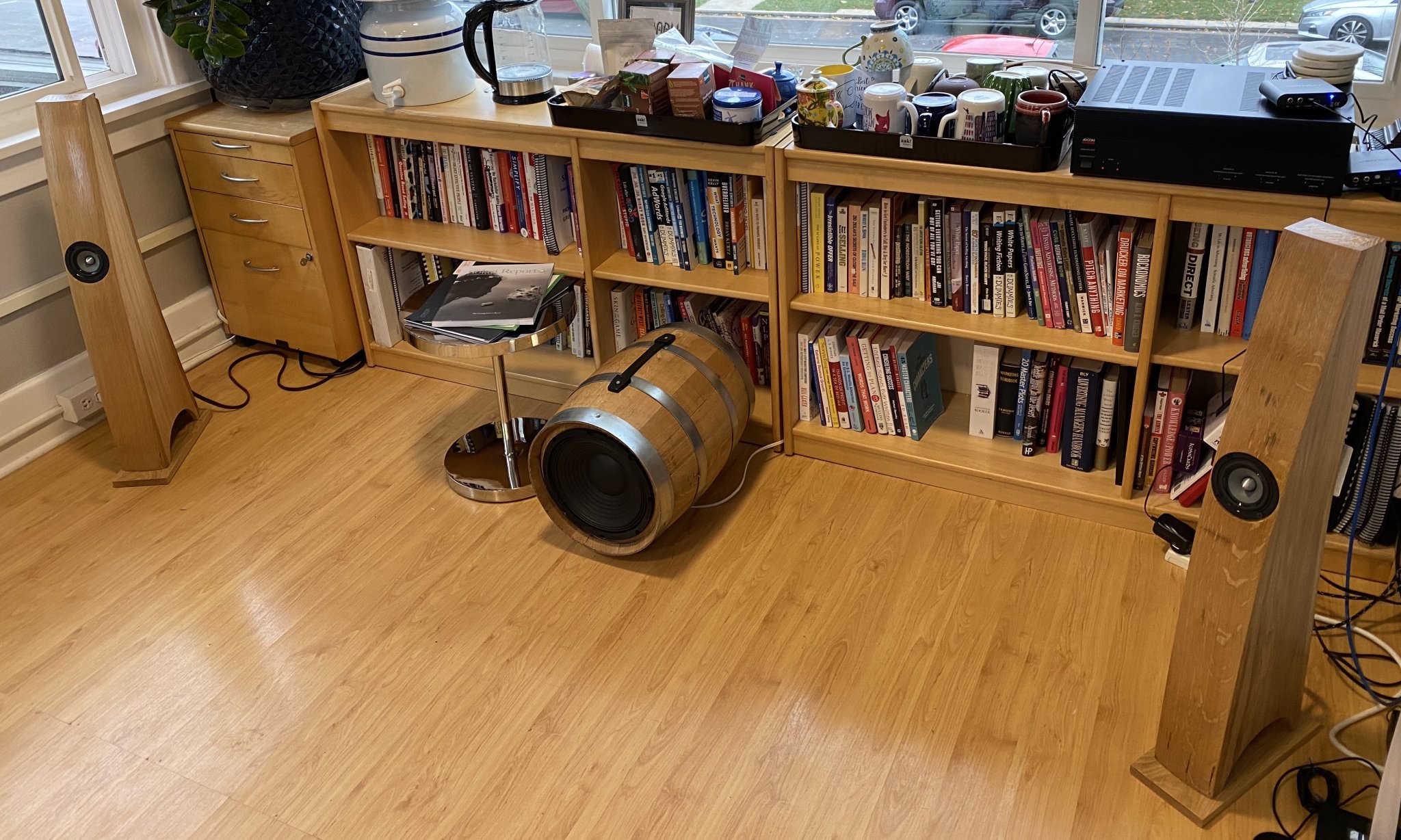

I find my rising top end a little harsh so I've added a slight slop starting at 9k, other than that my alpair 10.3s do great until they get lower so I went with a fast tower setup, the full ranges cover everything above 300 so they still have their point source magic. But yeah I agree most full range speakers could use some help, with that said they are super easy to pair with other drivers, cool build
Are you tops TL-style enclosures like a mid-TL or are this closed cabinets?

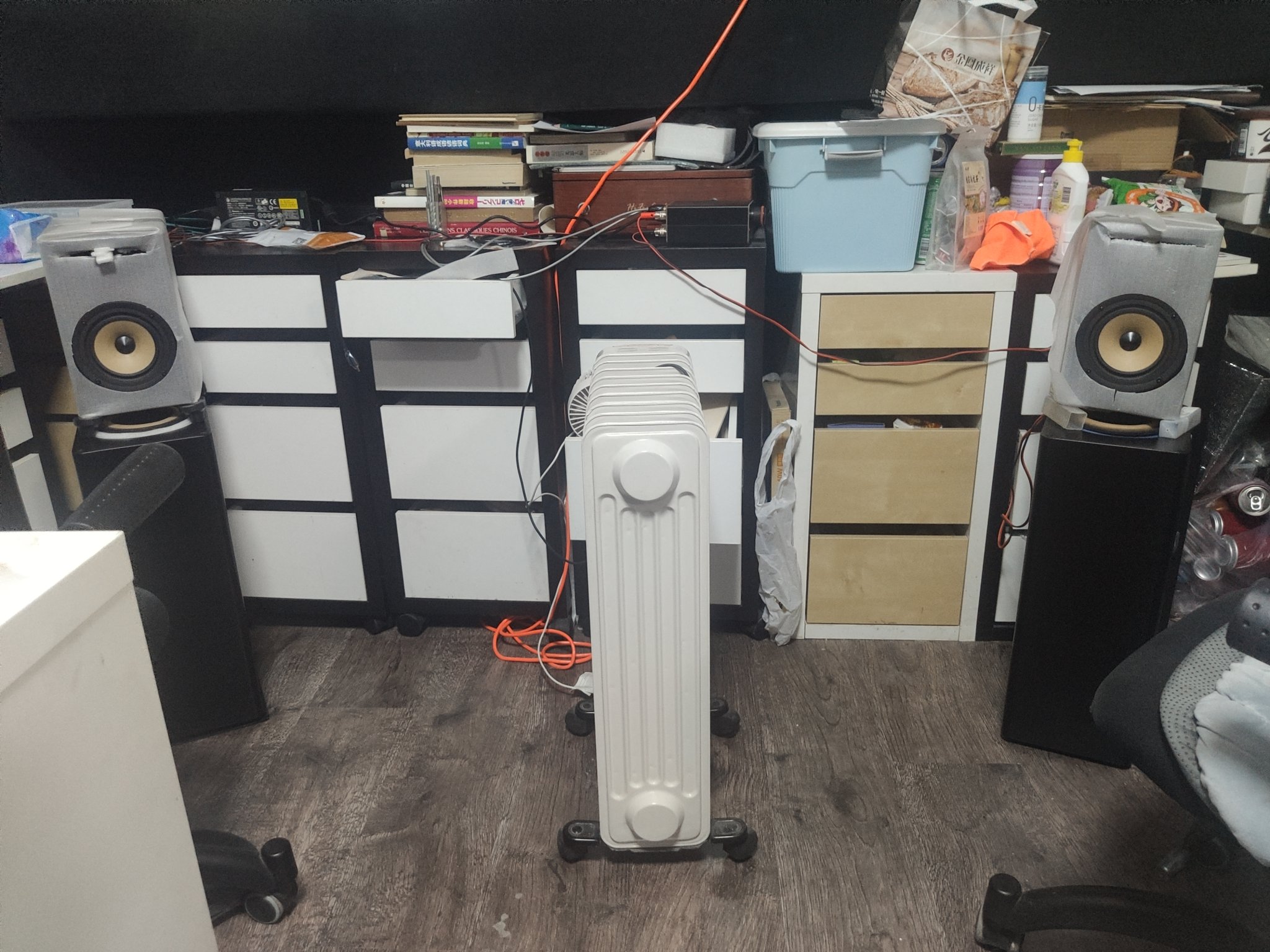

Two stacked fullrange 5" (really 4.5) run XO-less in series: upper 4ohm Michael Audio "drum paper" in 6L labyrinth (slot-loaded); lower 8ohm Correct P-610 variant in 17L up-firing tower (was subwoofer) with bottom port. BR/BR cabs punchier; folded (using divider boards) tapered-TL/ML-TQWT cabs more perfect. I don't know what "transcient-perfect" means exactly, but to my ears this LX-like pairing deserves that adjective. Speed and clarity of ESL; linear dynamic articulation of Axiom80 (alas from memory); an order more musical detail than beryllium headphones; natural realism. Reproduces live concert (acoustic instruments and vocal) front-row center for domestic ultra-fi listening, not intended for PA.
This was not exactly serendipity. The drivers appear to have identical basket construction i.e. came from the same factory/line, but are exact opposites in spec and response. Nor found by luck -- about fifteen years ago I had stacked Fostex F120A and Monitor Audio 2.5, respectively convex/concave frequency response curves. Same with the micor55. I had both drivers on the front baffle before, but lately up-firing "omni" really caught my fancy. One listen with the LX-like configuration and I was totally blown away!
In my demented/demerit scoring: -1 (hi/mid/lo) A+/A+/A.

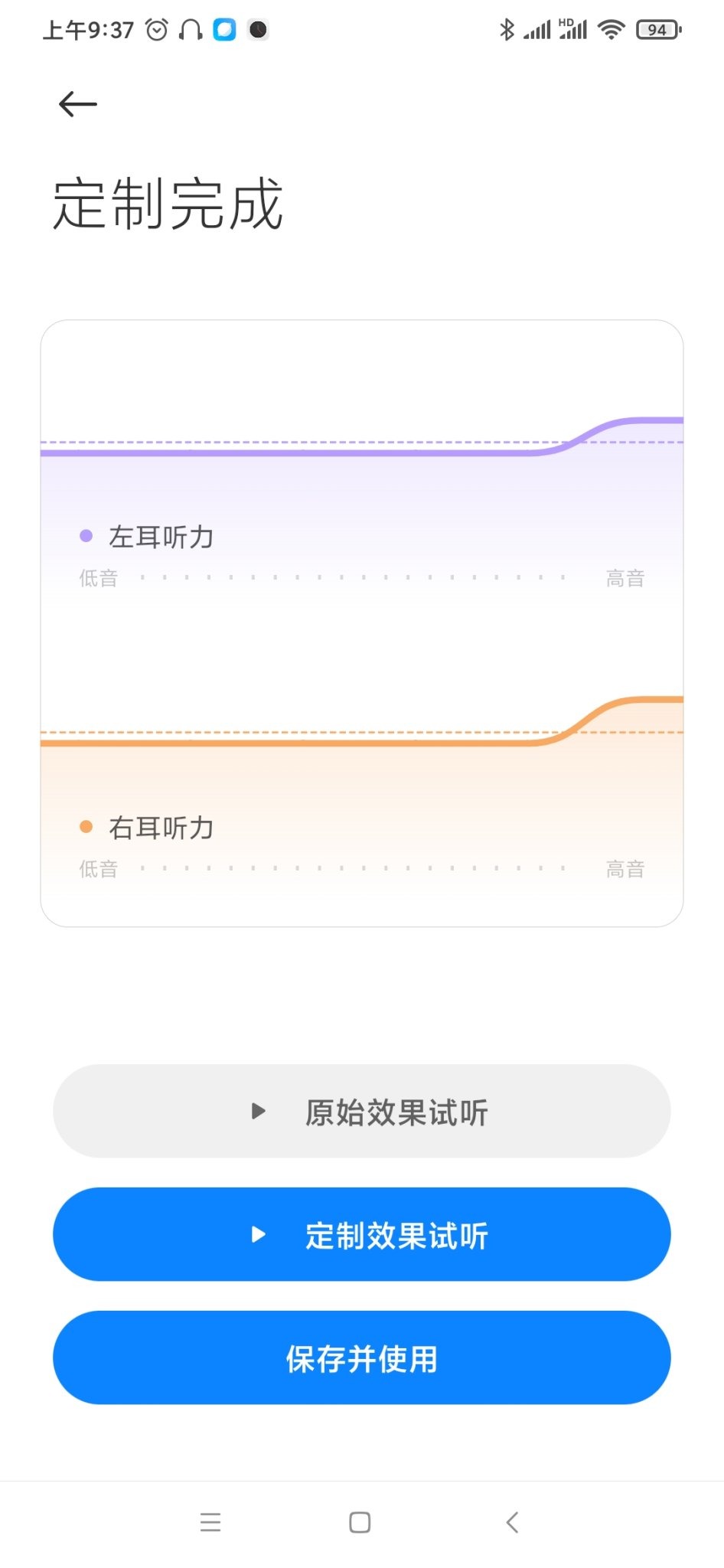

My smartphone Xiaomi 9 (flagship in its day) has a sophisticated built-in hearing test coupled with EQ on the headphone output, and here's the result (thrice repeated only differ at the far right from head positioning). I'm sixty. Tone sweep sounds jaw-dropping flat over my hearing range except 90-100hz ripple.
The Mi9 is technically more hi-fi but I still prefer the music from the Huawei P10plus. OCC interconnect 3.5mm to TPA3221 on steroids; Mi9 with additional Choseal USB-C to 3.5mm passive adapter. Graphite feet between cabs help.
Interesting. Can you cast the audio to your stereo system and hear if it does that there, too?
When I direct-connect of course the EQ is applied (if saved/named/turned on); however the sound quality may be (heard) affected at very high treble (grainy) at least through headphones. Adapter and wire make a big difference so I need to re-test this. Bluetooth also to be tested for EQ but normally I shy away from BT.

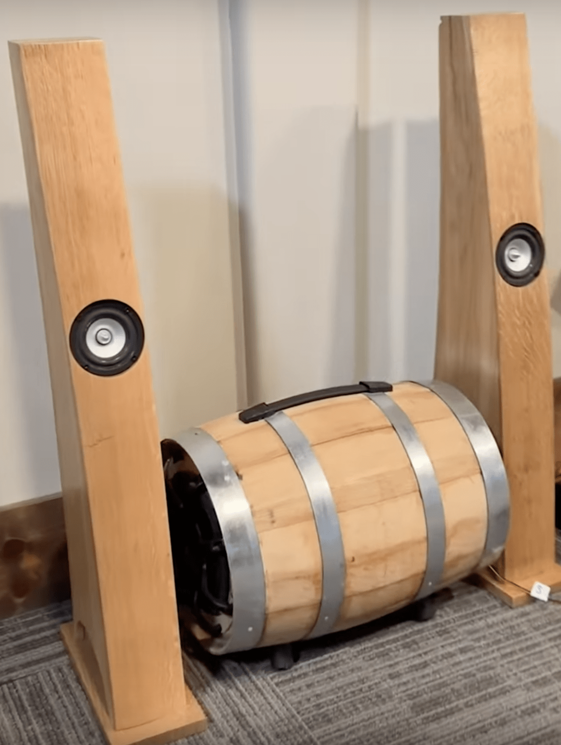

When I built these Bourbon Barrel Satellites, I wanted to “channel” Brandon. He loves bourbon. And since he’s got enough personality for five people, I asked myself, "If Brandon was a speaker, what kind of speaker would Brandon be?" The result was these. 10" subwoofer in a bourbon barrel, 3.5" Tang Band W3-871SC drivers in back loaded horn.
This is my interview at Parts Express 2023 Speaker Design Competition:
Design details at https://www.diyaudio.com/community/threads/bourbon-barrel-speakers.412383/
Reactions: 5 users

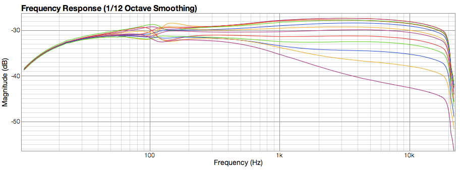

The thing I'm most proud of is the RC network that shades the signal to each of the 12 drivers differently, which is a solid family of curves. It ensures that all 12 drivers equally share the bass load below 100Hz while shifting the treble to the lower drivers to achieve the desired polar pattern above 500Hz. This also eliminates most of the comb filtering that you get with arrays:

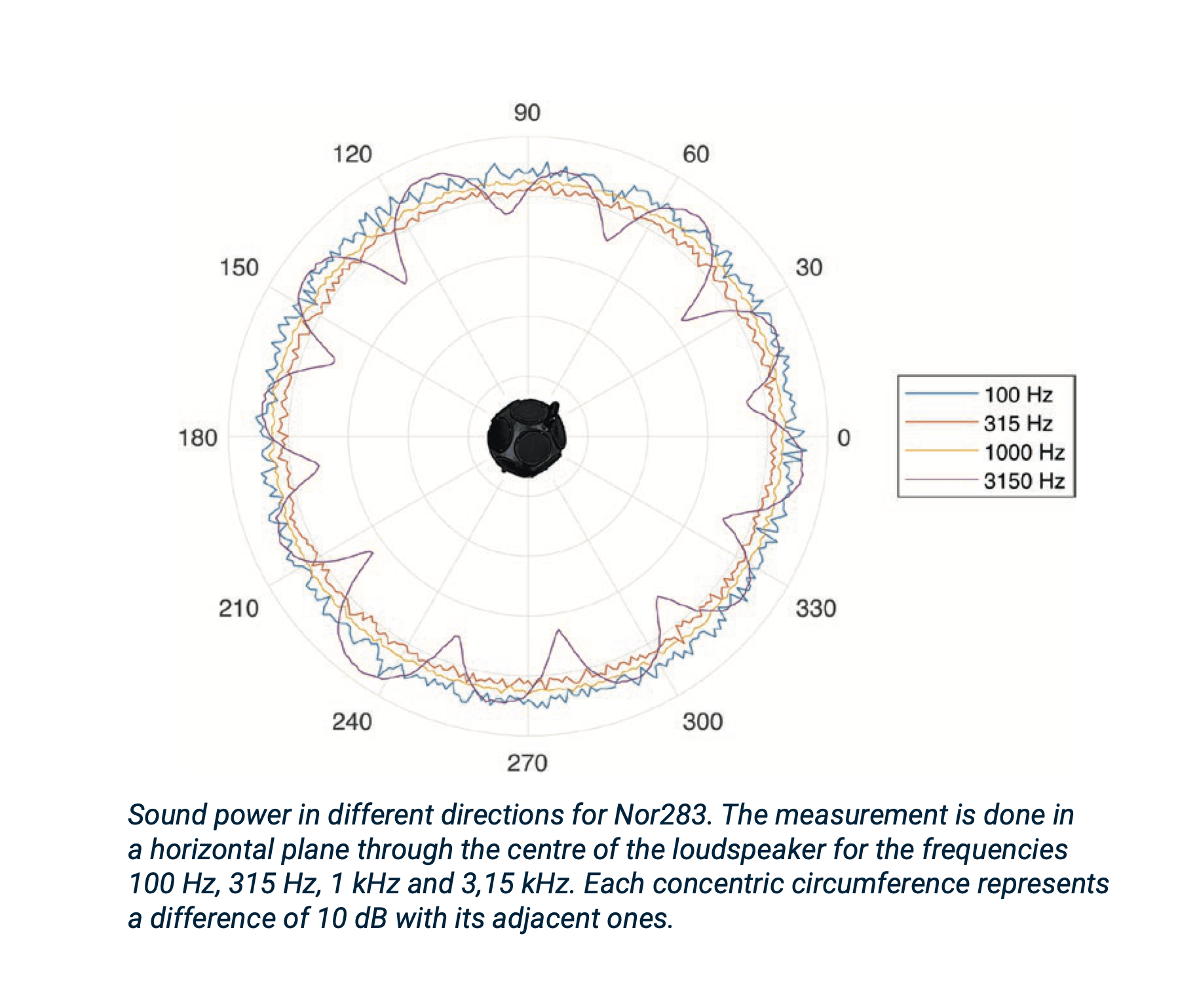

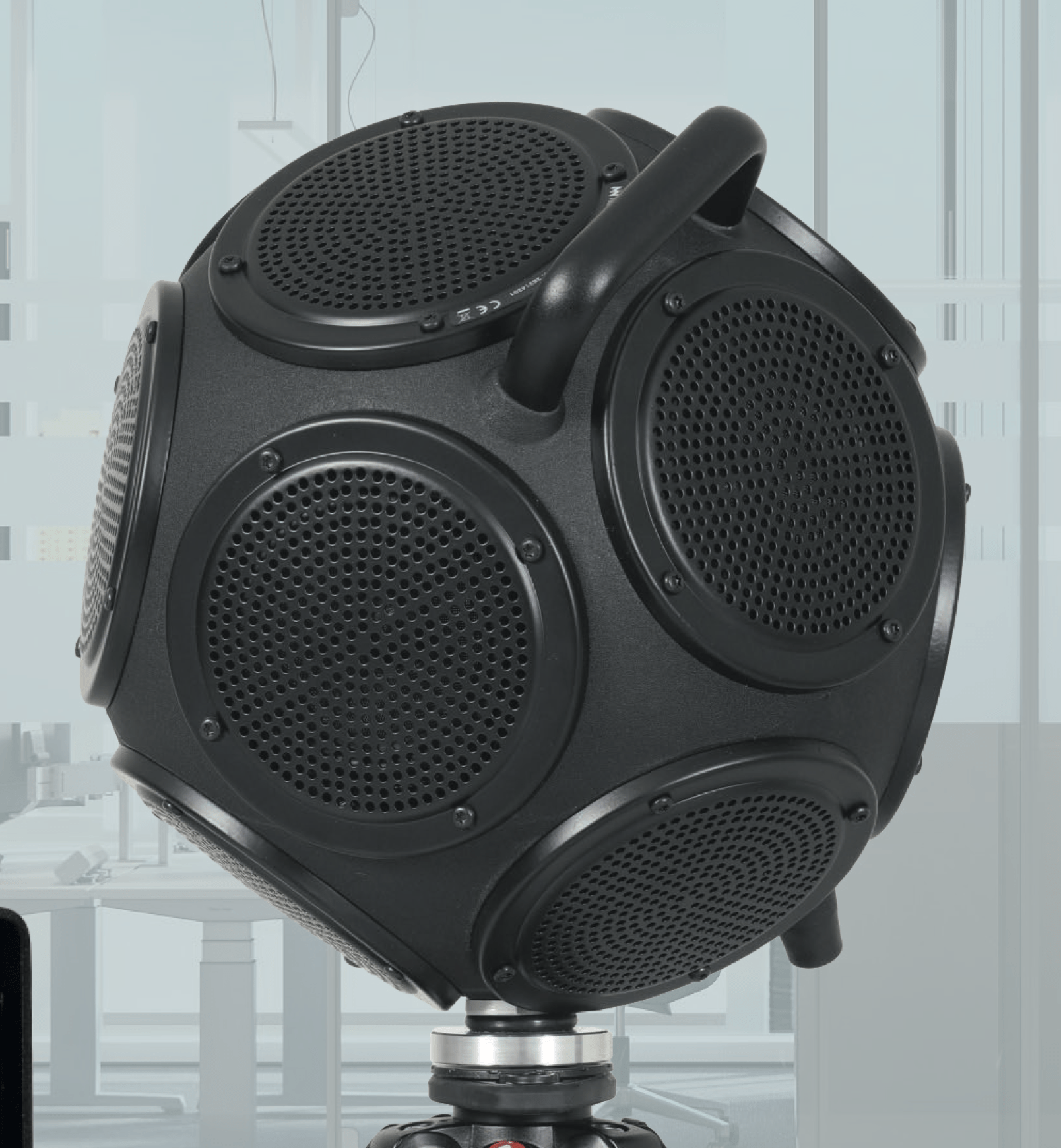

Here is a recent pro design (noise source) that is a dodecahedron: https://www.norsonic.com/products/noise-sources/nor283-dodecahedron-loudspeaker/
The chart of the radial response will be of interest and shows combing happening.

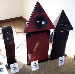

They used to make this. Latest ones seem to be morer conventional.
dave
They tout the advantage of the tetrahedral shape as how it deals with the internal waves, there's no parallel surfaces and the driver is facing an internal vertex.
