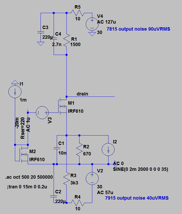

Here's my simulation of (half) the I/V stage of D1, less the output buffer. The output is taken from 'drain' and the DAC (PCM63) is represented by current source I2, in parallel with 670R.
A common-gate connected transistor needs its bias set by external resistors or current sources. Making the choice between those two alternatives is at the essence of designing - they each have trade-offs. Resistors give the lowest possible noise but also the poorest PSRR. Current sources are noisier but can have excellent PSRR. So it comes down to - how clean are your PSU rails? In the D1 they turn out not to be particularly clean, they're regulated by 7815 and 7915 with what look to be external zeners to boost the output voltage to 30V. In the simulation I assumed the zeners to be noiseless as I'm not sure how to figure out how noisy they are.
I took the datasheet values for output noise of the regulators but then I looked into how much output noise would be due to insufficient ripple rejection (70dB from the DS). And it turned out that potentially the ripple would dominate over the output noise (I say potentially partly because of the unknown contribution of the zeners). Since D1 uses resistors and its rails aren't particularly clean, you'd expect PSRR issues to show in the sim, and indeed they do. At LF, PSU noise intrudes up to 30dB above the noisefloor. At higher freqs the 220uFs keep rail noise in check. In practice though the design uses a pair of PCM63s each with its own I/V stage so as they're running balanced, the noise from the PSU gets turned into common mode (because it affects both sides equally) and therefore should cancel out at the differencing stage further on down the track. For myself I shy away from relying on something beyond my control (the CMRR of another bit of kit) for getting optimum SQ so letting this much supply noise through is a no-no. Someone somewhere might want to run just one output phase for instance. This is just my personal stance - for my own designs resistors aren't really an option because of the extreme PSU sensitivity.

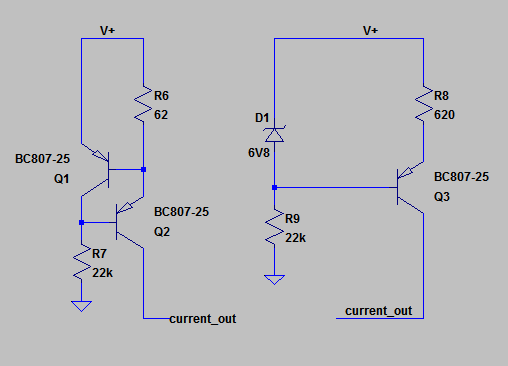

Given I'm going for current sources over resistors, how to make those as quiet as possible? Turns out that the noise in a CCS is inversely proportional to the square root of the resistance. Here are a couple of examples :
The 10mA CCS on the left is 10dB noisier than that on the right, assuming a noise-free zener. Resistor Johnson current noise in R6 and R8 is what determines the noise, which is the polar opposite to the way we're used to thinking - that higher resistor values give rise to more noise. Seeing as for lower noise we need higher resistor values, the rationale for Pass's choice of 30V supplies in the D1 stage becomes apparent. A lower noise CCS is going to need more voltage headroom, hence hotter rail voltages.

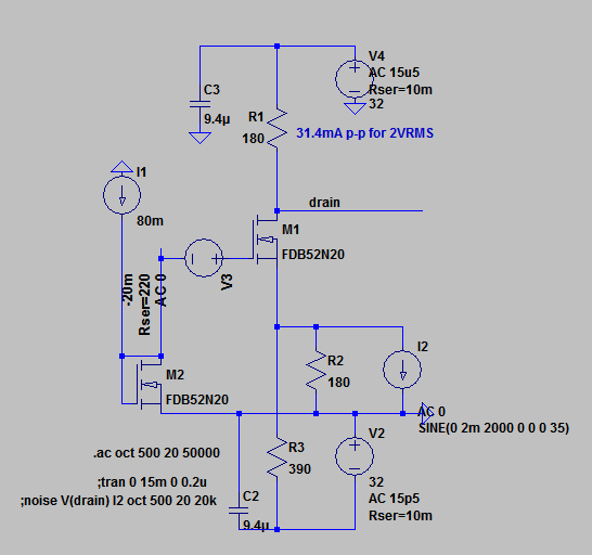

As a notable variation on the D1, Owen (opc)'s NTD1 is definitely worthy of a mention. In this design he's re-worked the D1 to operate with a much higher current input from ESS DACs, rather than the meager 1 or 2mA that comes from R2R DACs. The MOSFET is also selected especially to give the highest possible gm (transconductance) at the working current. No output buffer is included as the output impedance (180ohm) is low enough to use directly, via a DC blocking cap. Here's a simplified schematic - the real design is balanced, like D1 :
R2 represents the output resistance of the DAC, I've filled in with what I dimly recall the Zout is for ES9018, newer ESS DACs have lower numbers. As with D1, the I/V resistor (R1) is terminated at a power supply meaning no (0dB) PSRR, all PSU noise is sent directly through to the output without attenuation. Of course, in balanced mode this PSU noise cancels out, so the effective PSRR becomes the CMRR of the next stage. However the PSU itself is of heroic design, using an Analog Devices ultra-low noise CMOS regulator, the ADP7142. Being CMOS its noise spectrum shows a high-ish noise corner :
Noise at 20Hz is over 20dB higher than at 20kHz but overall very low at (theoretically) 11uV. When I can access the NTD1 specs I'll update, I think I'll need a VPN to see them.
<Update> NTD1 does not specify output noise (N/A on the spec sheet) but we can infer it from the SNR which is quoted as 128dB. Since the maximum output level is +6dB, the noise must therefore be -122dBV or around 0.8uV (in balanced) or from each side (uncorrelated) 0.5uV.

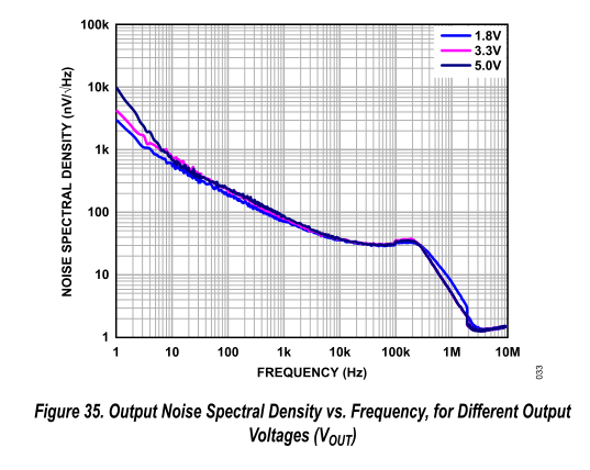

Given I'm eschewing the use of the main rails as my voltage reference, I need to generate a local very low noise reference voltage. This is rather less onerous than generating a very low voltage main power rail as I have control of its load and therefore it only needs supply a limited amount of current.
The ubiquitous choice of a reference is a zener diode. Which indeed was my first port of call, based on this thread by @Christer : https://www.diyaudio.com/community/threads/some-noise-measurements-for-leds-and-zener-diodes.35821/. His conclusions there suggest that a 15V zener diode to bias a current source should be a low noise choice as that's far away from the zener/avalanche watershed voltage. So initially I went this route for a current source Vref, taking care to RC filter the output with a 220uF 'lytic and 100R in series.
When I got to measure the output of the DAC which used this voltage reference as the 'pull-up' for the I/V resistor I was surprised to find it considerably noisier than simulation predicted. The noise was though reducible by increasing the capacitance of the 220uF so I began to suspect the zener diode - an OnSemi BZX84C15. Pulling another off the reel into a gash noise measurement set-up (using my Cosmos ADC) the noise it was putting out was extraordinarily high, around -70dBV. I decided to measure a few other voltages for a sanity check and found the opposite of what Christer found - as I reduced the voltage from 15V the zeners got quieter. A Nexperia C13 was around -85dBV and a C10 of unknown manufacturer close to -100dBV. A 6V2 was the most promising of all, at -112dBV. I added a second 6V2 in series and found the noise went up around 5dB (at 30% lower operating current). So the first 6V2 zener wasn't a freak. Perhaps the difference here is I'm measuring SMD zeners (SOT23 case) whereas Christers were leaded.

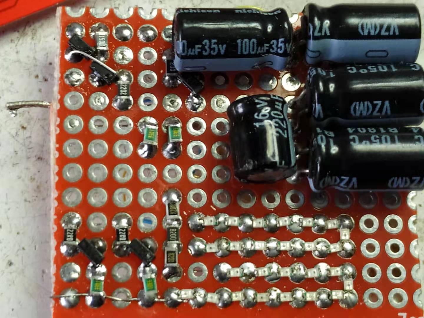

All these numbers made me doubt zener diodes rather so I turned to IR LEDs, which Christer found were the lowest noise source he measured. I'd previously measured some IR LEDs for dynamic impedance and got promising results, they definitely do better than visible LEDs in that metric. First up I dug out my string of 3mm LEDs I'd used for the dynamic impedance measurements I made and tapped off a measurement point at 8 LEDs in series, giving around 10V. At a bias current around 3mA the noise was getting seriously low, about -120dBV. At this level the accuracy of noise measurements is significantly affected by the ADC's own noise floor, around -123dBV. So 3mm IR LEDs are where its at, noise-wise, easily beating out zeners just as Christer found.
A string of 10 or more 3mm LEDs is kinda expensive in PCB real estate so I wondered if 0603 LEDs would fare as well. It was satisfying to discover they were electrically indistinguishable from their bulkier leaded relatives. I'm now in the process of ripping out all the 15V zeners in my prototype DACs and replacing each of them with 13 0603 IR LEDs in series, quite a fiddly soldering job.
Reading through Christer's introduction again, I wonder whether his results might potentially be compromised by the noise from his current sources. While he mentions the low noise transistor type he used to build those, he doesn't say anything about the configuration - the reference voltage used (and hence resistor value) being rather critical as I pointed out in the previous post.

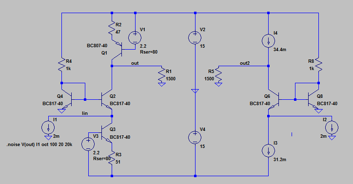

<later> Done the sim, here's what it looks like in LTSpice - the left side of the schematic. I'm getting around 10uV output noise relative to 2VRMS that's an SNR of 106dB. Since the zero point SNR for the chip is typically 110dB its not really doing justice to the 1541A. The right side schematic is with the real-world CCSs replaced with idealized CCSs without any noise. The purpose of this is to explore how much better the SNR can be from improving the CCS noise. It measures almost 10X better. CCS noise turns out to be quite sensitive to the Rser of the voltage sources biassing the CCSs. I've modelled the green LEDs with 2.2V voltage sources and a ballpark 80ohm series resistance. The green LED's dynamic resistance is a major noise source, when that's reduced the SNR improves. In practice the LEDs could be bypassed with large 'lytics to reduce that Rser or they could be run at a higher bias. 3300uF across both improves SNR by 4dB and also improves the PSRR. Beyond that I think the bias voltage would need increasing, with R2 and R3 increasing in proportion.
Incidentally I may have uncovered a bug in LTSpice noise modelling - when I set R2 and R3 to the same value, the noise virtually disappears to zero. This can't happen in real-life can it? Surely it must mean the noise contributions of the two CCSs are cancelling out when equal but that's impossible. If not, then I've found a cool way to get really amazingly high SNR! Ah scratch that, putting both current sources to the same value takes Q2 out of conduction (current flows out of R1 taking the collector too negative).
Doubling R2 and R3 (and using two green LEDs per transistor) gains another 3dB or so with the 3300uFs in place. Now the I/V stage is quieter than the DAC itself.
