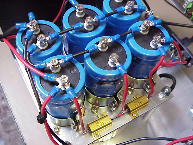

Well then, the new PSU is up and working.
The hum is (almost) completely gone. When listening very close to the speaker, I can hear a very tiny amount of hum.
Measurements reveal 1.8mV AC. I definitely can live with this.
The voltage is now +/-30V. The AC meters on the variac show 1.9A on 227V.
Thanks again guys. :)
/Hugo
Moderator
Joined 2003
Peter

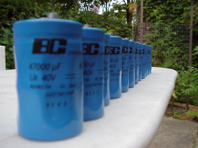

Before there were 4 caps, each 68.000µF. Total: 272.000µF
Now I have 6, each 47.000µF. Total 282.000µF
Making it a CRCRC filter does the main improvement.
The R's do the trick I believe.
Over the first caps I measure 355mV AC.
The second shows 81mV AC and the third 25mV AC. This results in 1.8mV differential AC at the outputs.
The sound, to me, is the same as before. There's no way to go back to the old setup to do an A/B test.
/Hugo

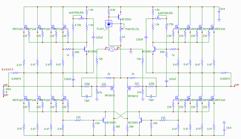

In time I received some request by mail to post a schematic of my amp.
I’m pretty well satisfied now with the trimming results so here we go.
Anyone, feel free to add more reply or recommendations.
The power supply schematic is here:
http://www.diyaudio.com/forums/showthread.php?postid=194297#post194297
Thanks again to all for the large interest and great amount of tips all over the place.
/Hugo :)

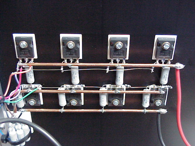

How difficult is it to solder onto the solid copper bar? Did you have
to set up some kind of jig to hold the bar in place while you
soldered on the components? Point to point looks so nice! I'm
going to have to give it a try soon.
Another old question, but do the resistors in the power supply
heat up the capacitors too much? or do you have something
between the caps and the where they're mounted?
Is that the star ground in the upper right hand corner of the picture?
Great job! inspirational :nod:
moe29
Moderator
Joined 2003
Thank you Moe
When you look at the lower copper wire you can see that I wrapped the wires from the big resistors around it.
They then held them in place very easily.
The upper and mid bar was not much of a problem too.
I plied the legs of the mosfets first and let the bar rest on those
plied feet.
Soldering is not a problem at all.
Just have enough patience too let the bars heat up.
Don't be afraid to heat things up, they will have to get used to it anyway :D
About the PSU R's:
They are 0.1ohm so they hardly dissipate anything.
The alu plate is slightly warm.
There is nothing between the plate and the caps but they stay
cool enough. I guess around 30°C.

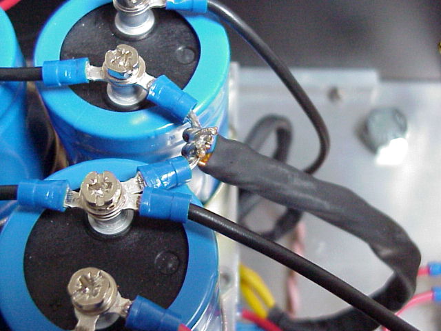

Here's another picture of the star ground. The centre tap of the transformer goes directly to the centre point of the caps.
From there a big wire goes to the small signal board.
/Hugo
