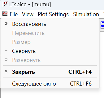

Funny thing is, when I right click, then select Open With, select LTspice, noting happens.I sometimes compare different Spice programs by running them in batch mode and get a RAW file. I click on them with my mouse. LTspice opens, but there is no picture. An additional command appears on the top left. Do a restore and after the PLOT window appears add the desired signal.

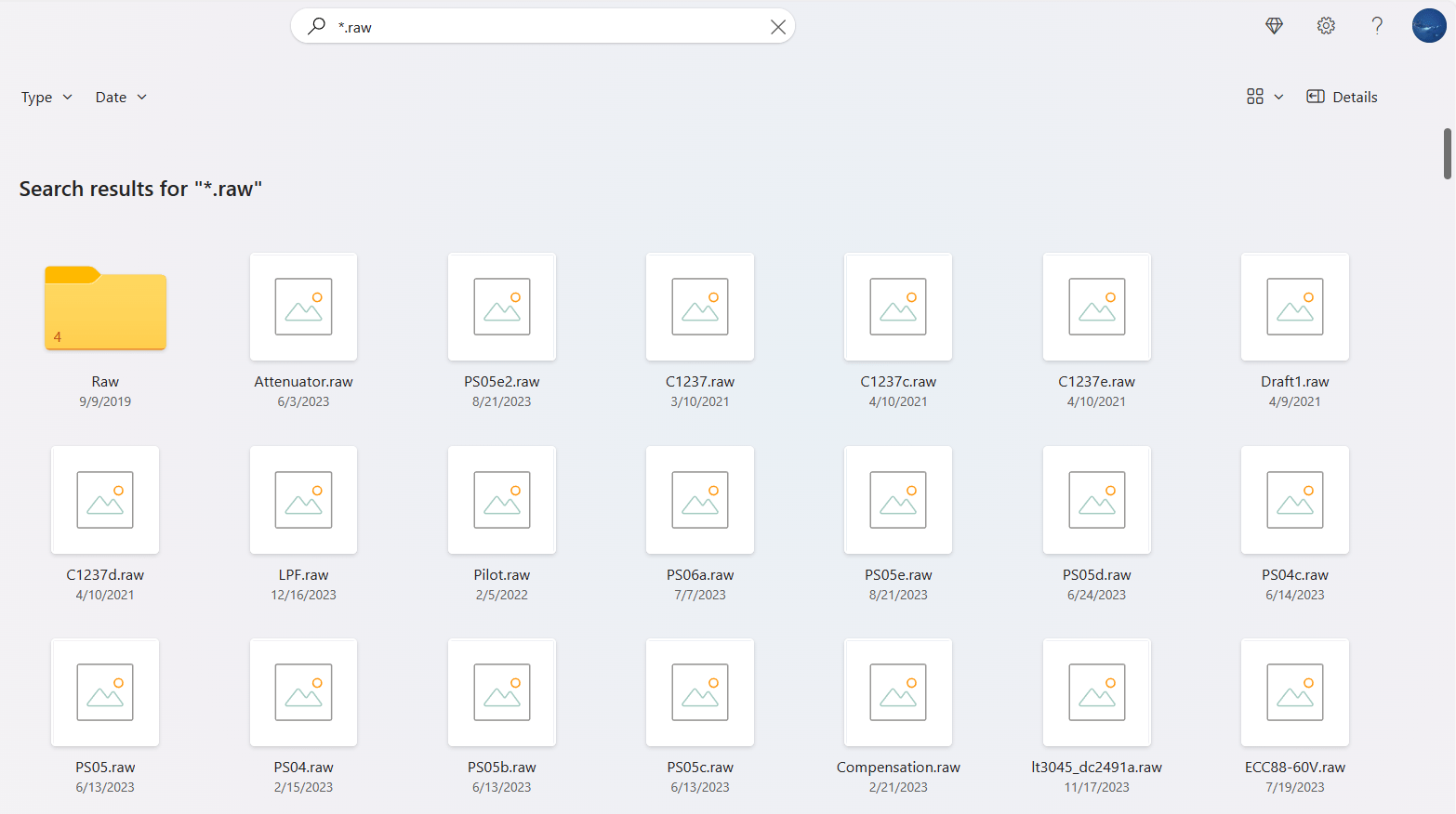

If I open a .raw file from within LTspice, it opens but ONLY the last generated .raw!
None of the earlier ones open. Weird.
Jan
I can't save it in the same folder because my whole life is on OneDrive and .raw is forbidden in OneDrive ...Try saving the Plot Settings first, save them under the same name as the .asc and then save the sim and all must be in the same folder. You should end up with the .asc, the .raw, the .plt and the .net file all together in the same place.
