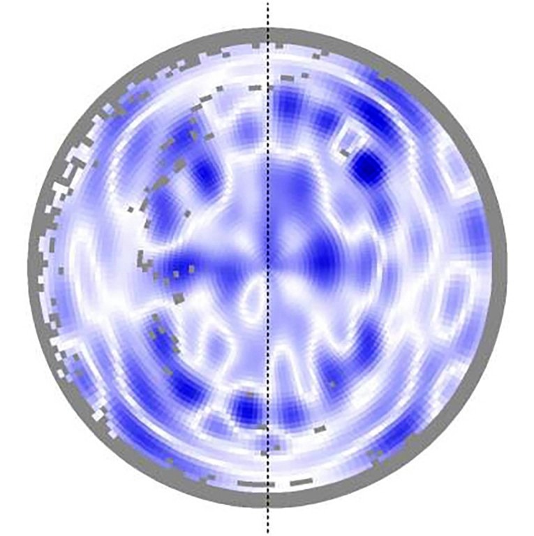

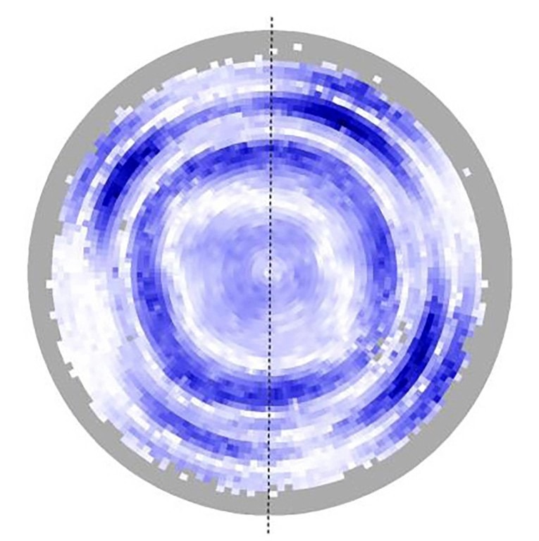

That is the results of they're laser vibrometer readings of midwoofer cone with round vs elliptical voice coil.
One can see different radial 'modes'. Does not mean there is not resonances or breakup.
