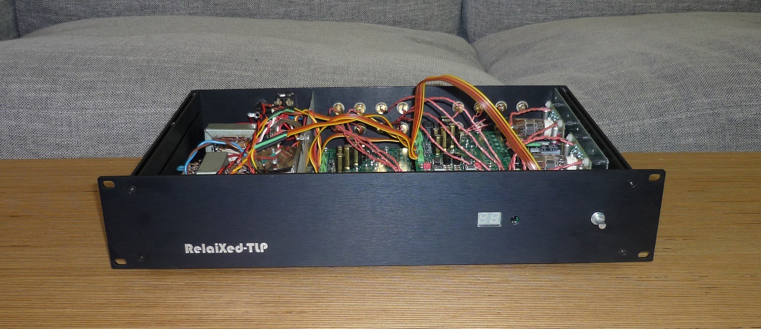

I faced exactly the same problem in my 4-way active setup, a few years ago - needing to be able to adjust the volume of the 8 analogue signals coming from my miniDSP 10x10HD and going into 8 amplifier channels. (I didn't want to use the digital volume control inside the miniDSP.)
I found the 'Relaixed' PCBs from Jos van Eijndhoven in Holland. It worked excellently.
Here are a couple of pics of what I built:
The volume knob fits on the shaft on the RHS of the front panel. The display unit to its shows the volume - can also be varied using a remote control (see hole just to the right of the display).

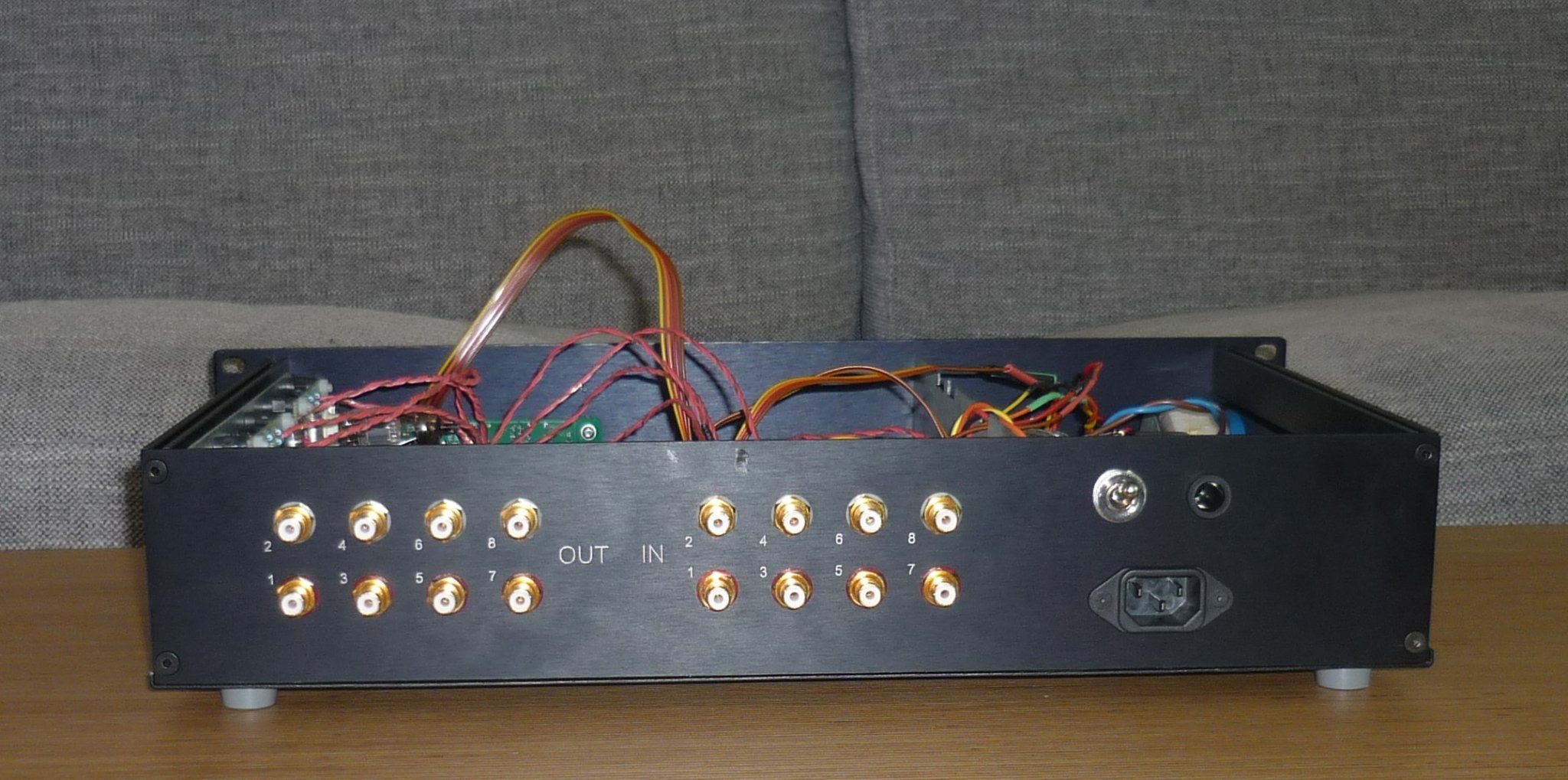

If you don't want to build it yourself ... I can sell you this one - as I have changed my miniDSP unit to an all-digital one and no longer need the Relaixed unit. We in Oz have 230v/50Hz mains - so it will work fine in Europe.
