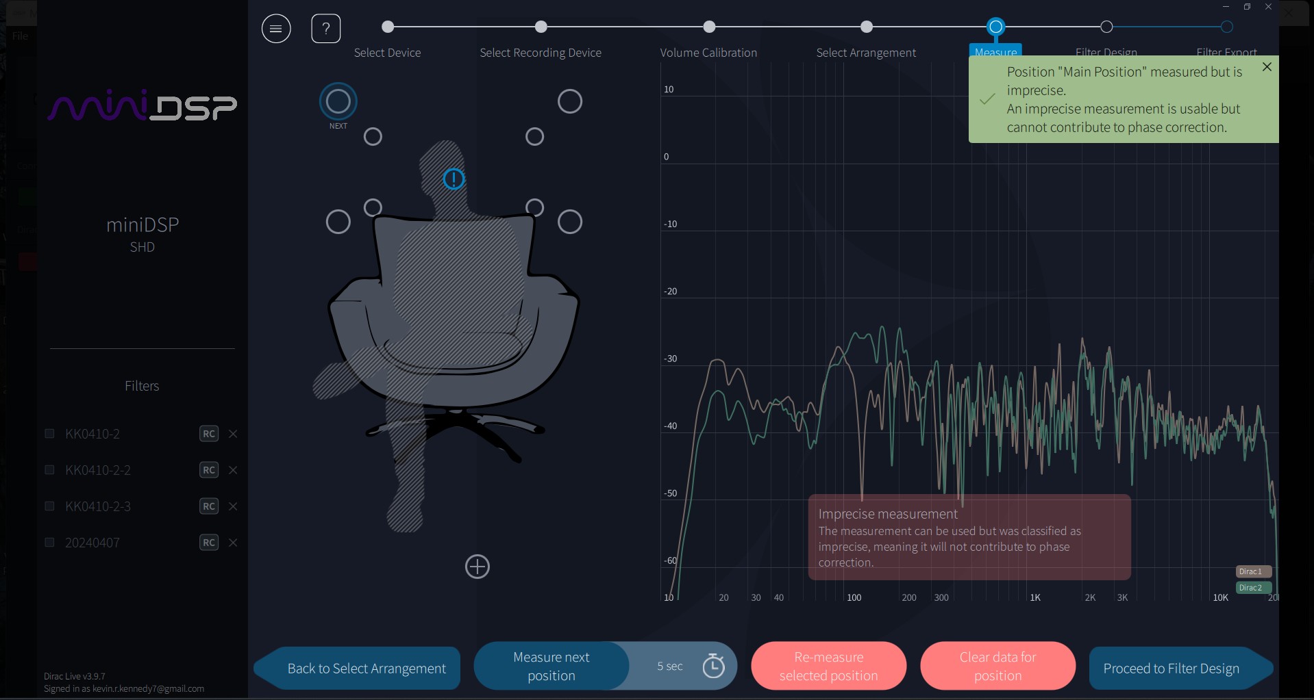

I was wondering whether anyone else using MiniDSP hardware like the SHD, SHD Studio etc are seeing this when they run a room calibration.
When this occurs Dirac will not correct for phase or delay. This problem started when I updated to Dirac 3.9.7 from 3.8.2 which worked fine the last time I used it a few months ago. I have always used my UMIK-2 with Dirac without issue. I subsequently reverted to 3.7.3 and continued to have the issue until I switched to my UMIK-1 mic and I was finally able to do a calibration which seems valid. (Not one of my best outcomes however)
The UMIK-2 works fine with REW, HolmImpulse and audiotester.de., but suddenly not with Dirac.
I previously owned an SHD before replacement with the Studio a couple of years ago, and have a lot of experience with doing Dirac calibrations. I never had any problems until a week or so ago when a hardware replacement (Danley DNA SC48) dictated the need for a recalibration after I completed configuring it. (I did a lot of measurements with the UMIK-2 during that process and had no problems with it.)

Yes there is a licensed (to the hardware) Dirac plugin in the SHD Studio which works fine. Unfortunately the calibration tools run on a PC and you do a bunch of measurements in specific patterns using either a MiniDSP UMIK-1 or UMIK-2 mic (required).
Once the measurements are done the software generates an averaged measurement to display and all of the variables they need for phase, amplitude and time correction at the listening position. There is some manipulation of first arrivals claimed as well.
It suggests an initial target curve which you can manipulate or overwrite with your own, once that is done you upload the file to one of the 4 memory slots and listen.
I have to admit that while I am an experienced user I really have no clue about how it actually works. They're not particularly forthcoming about how it works, and I doubt I would understand very much of it if they were.
The UMIK-2 mic runs at 96K and the UMIK-1 at 48K. I think something has changed in Windows, literally for the past 5 and half years I never had significant problems doing the room measurements required for calibration, the last few runs have been nightmarish. The problem actually seems worse now. Based on what I am reading elsewhere this problem has existed for some users for at least 5 months, and there are reports of this same error back to 2019.
Ironically last night I heard that this problem only affects people using windows PC for calibration measurements and processing; Mac users don't have this problem. Is it time for a mac book? :D
