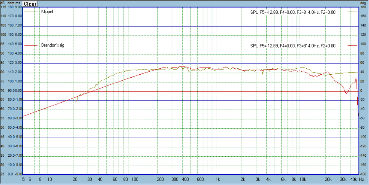

When I switched to a 4 ohm woofer after the first prototype was sent to Erin, I put all those measurements in a folder called "archive". I think I deleted it because I didn't need it anymore and didn't want a bunch of clutter. I'm trying to find the screenshot I took of the comparison. And now I'm realizing that since the last measurements from Erin may not have had the newest XO settings activated, but I'm not sure, I can't even compare to my current measurements And the speakers are already back at my house. I'll look through imgur and see if I uploaded it there.
<150hz = same sensitivity but rolloff was a bit different. Makes sense given mine was a combined port+near woofer response. I've never really put a lot stock in this measurement anyway since accurate T/S will generate better box response in software.
150hz - 1000hz = This is where the biggest difference was. But in a way that my measurement is still accurate, but smoothed. Where the Klippel has some little ripple with its high resolution, my response was like a slightly wavy line that touched the tops of the ripples on the Klippel response.
1000hz - 6000hz = dead on to the Klippel
above 6000hz = slight deviation that became more noticeable >10khz. Maybe 1.5dB different around 12khz or so IIRC. So basically the top octave and bottom octave diverged, but with the middle in good agreement.
Some similarities to our comparison: https://www.audiosciencereview.com/...-how-the-klippel-nfs-works.13139/post-1371581
You can set the distance to calculate the far field to in the Klippel software. This can get rid of some of the differences.. for example if you do your normal measurement at the usual 1m distance, but have the NFS set to calculate to 10m distance.

Hope brightens... I found the original box so I could redo measurements. Also found that while I deleted the project and driver files, and comparison screenshot, I still have the raw measurements. Should be able to build new driver files and post the comparison.
