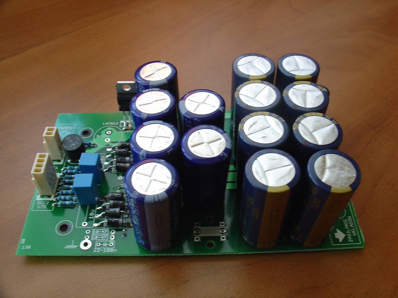

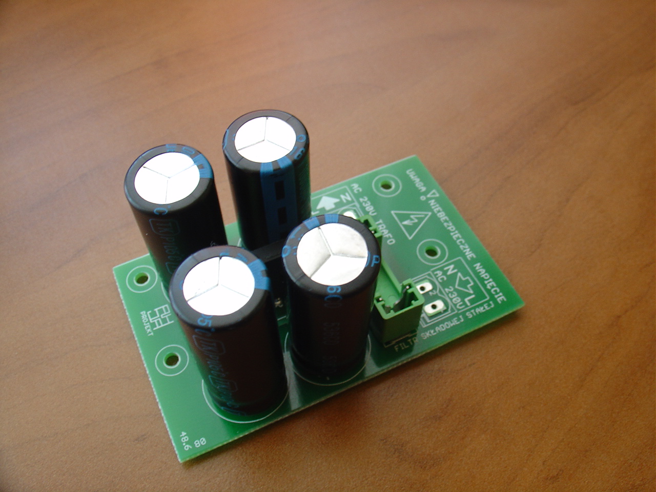

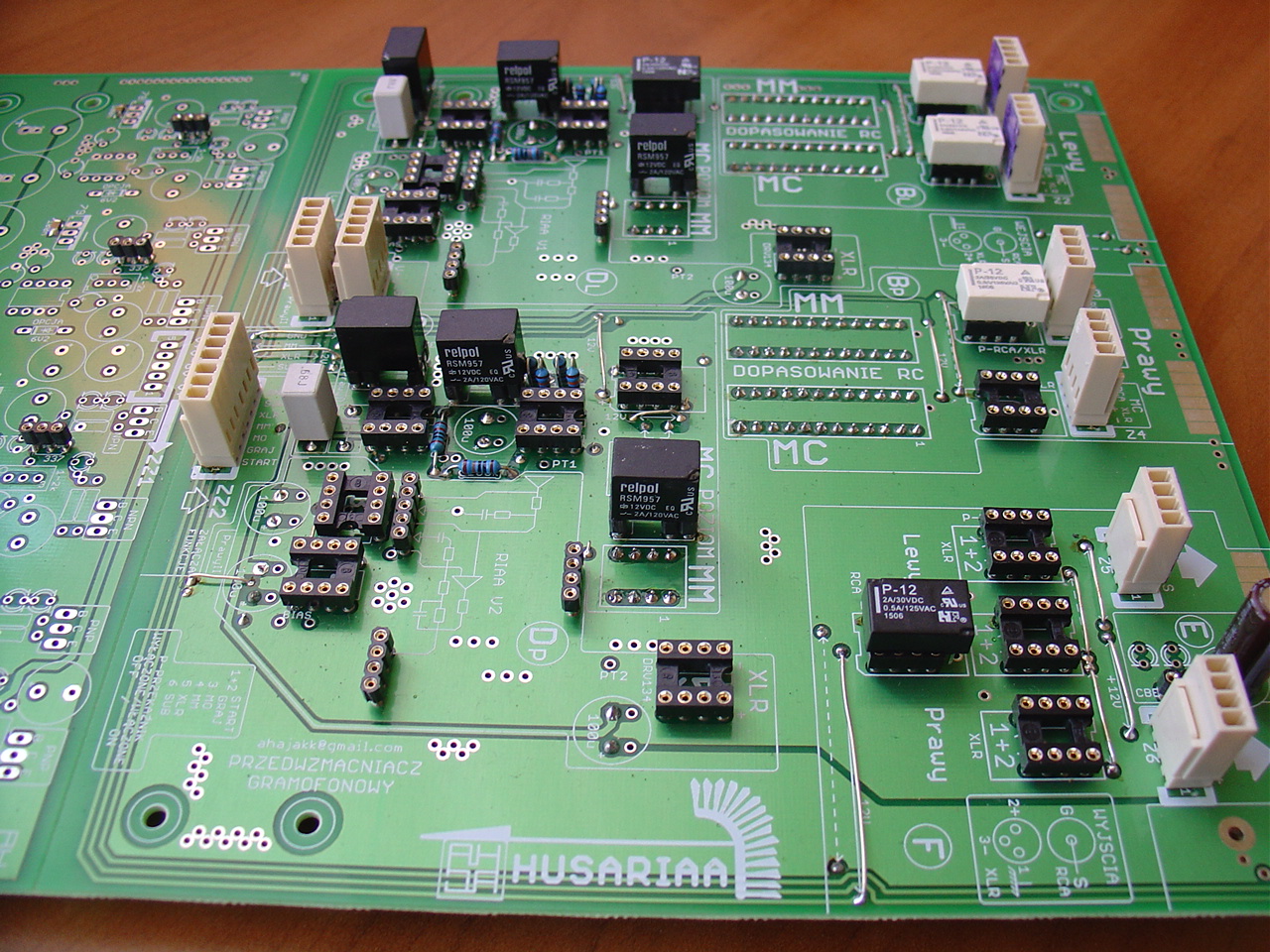

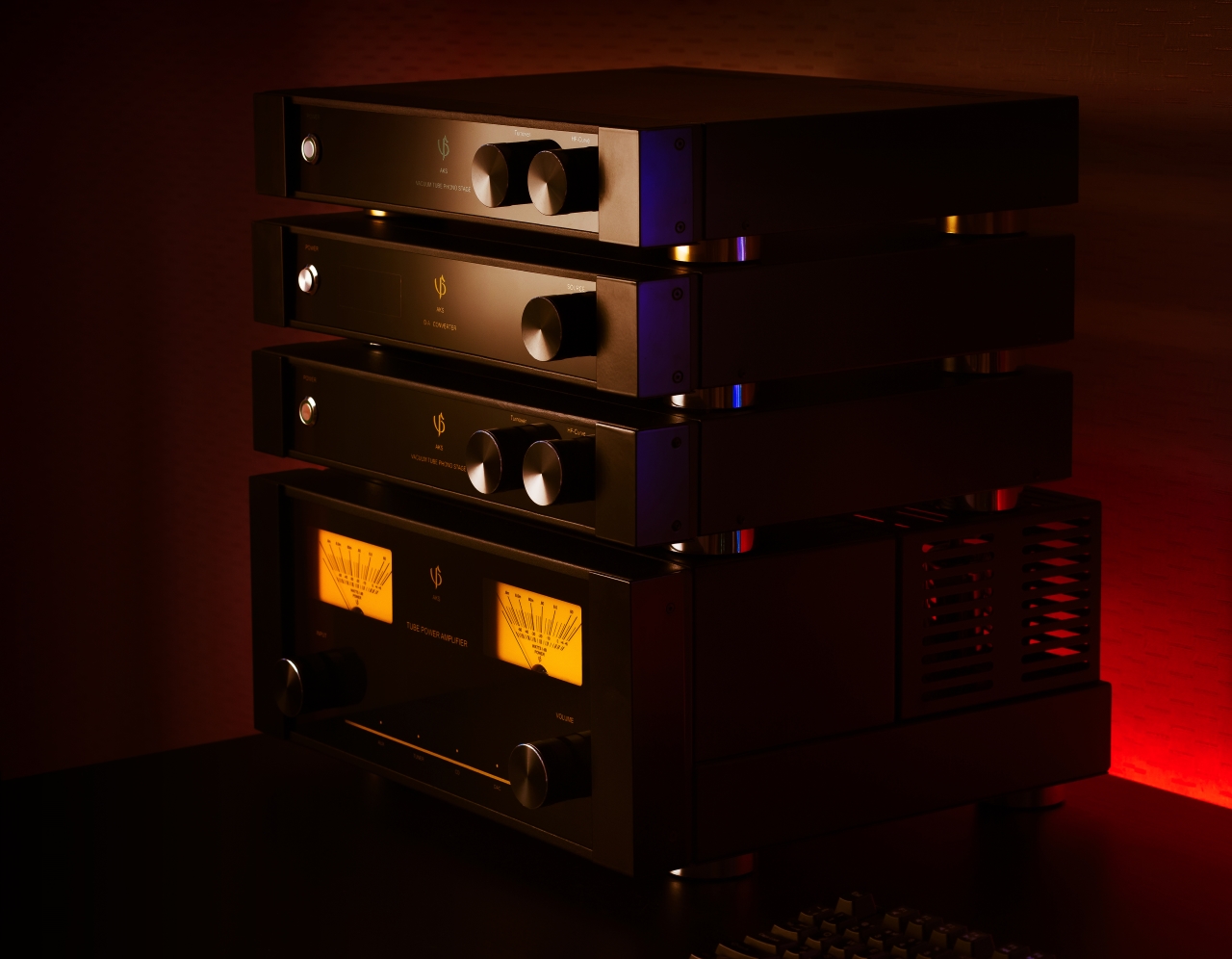

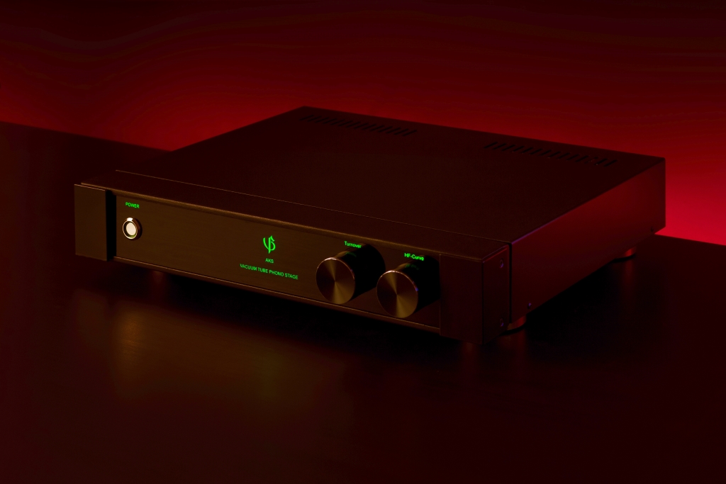

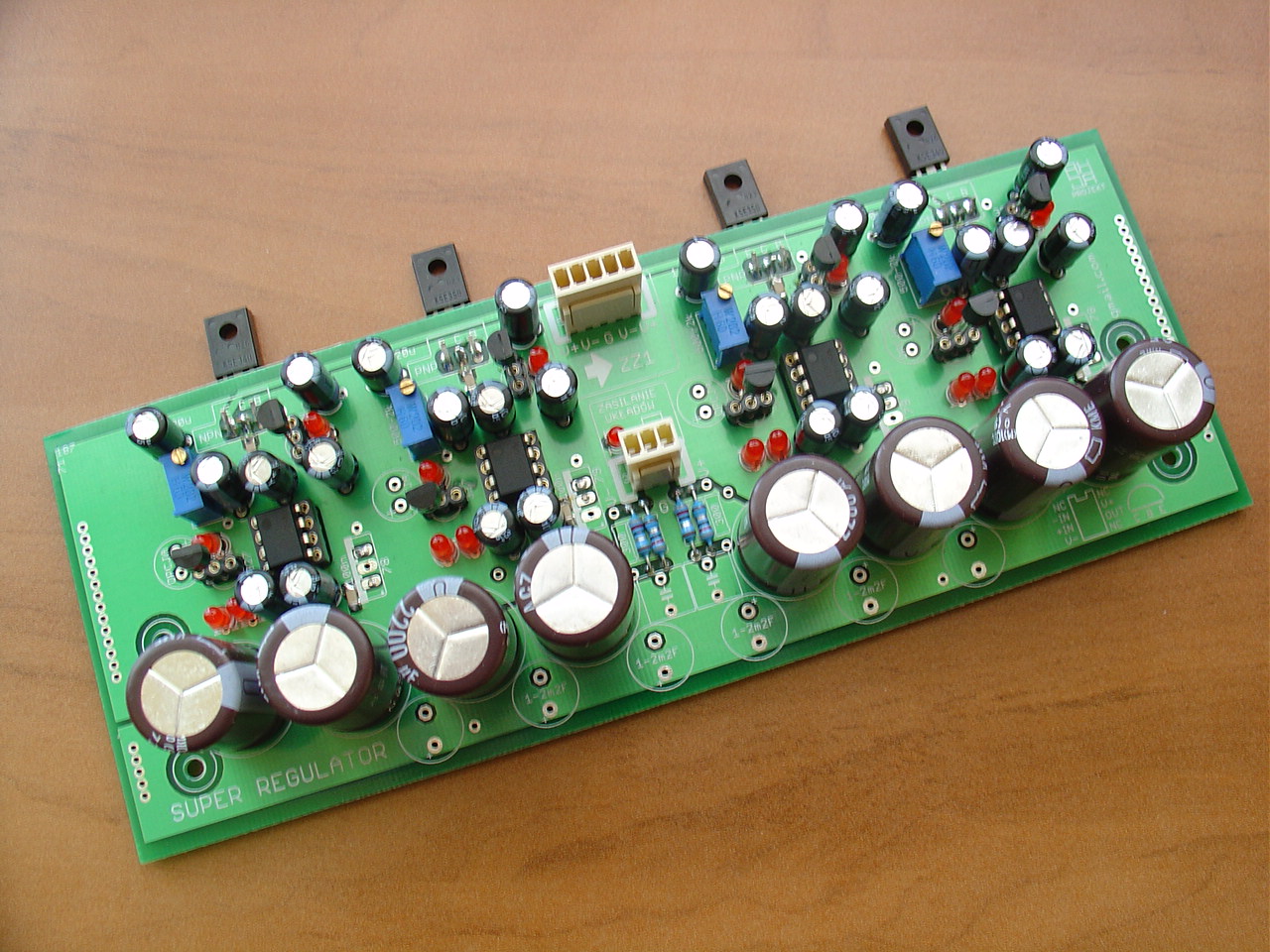

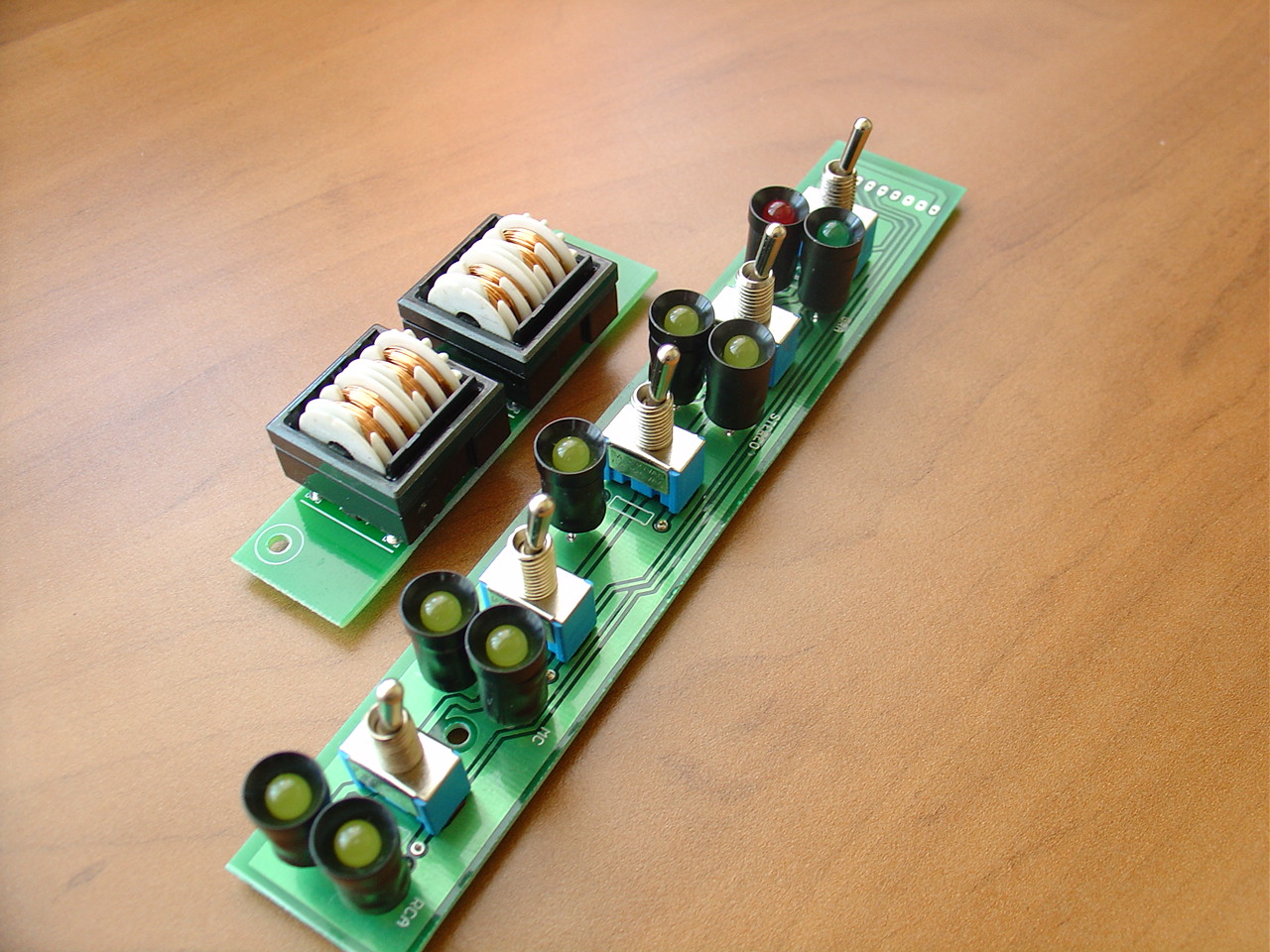

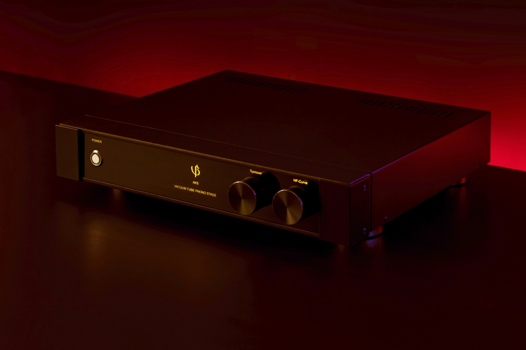

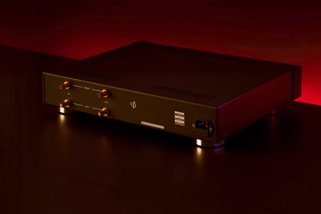

Well, finally I have finished my DIY project vacuum tube phono stage, here is some pics, and my set

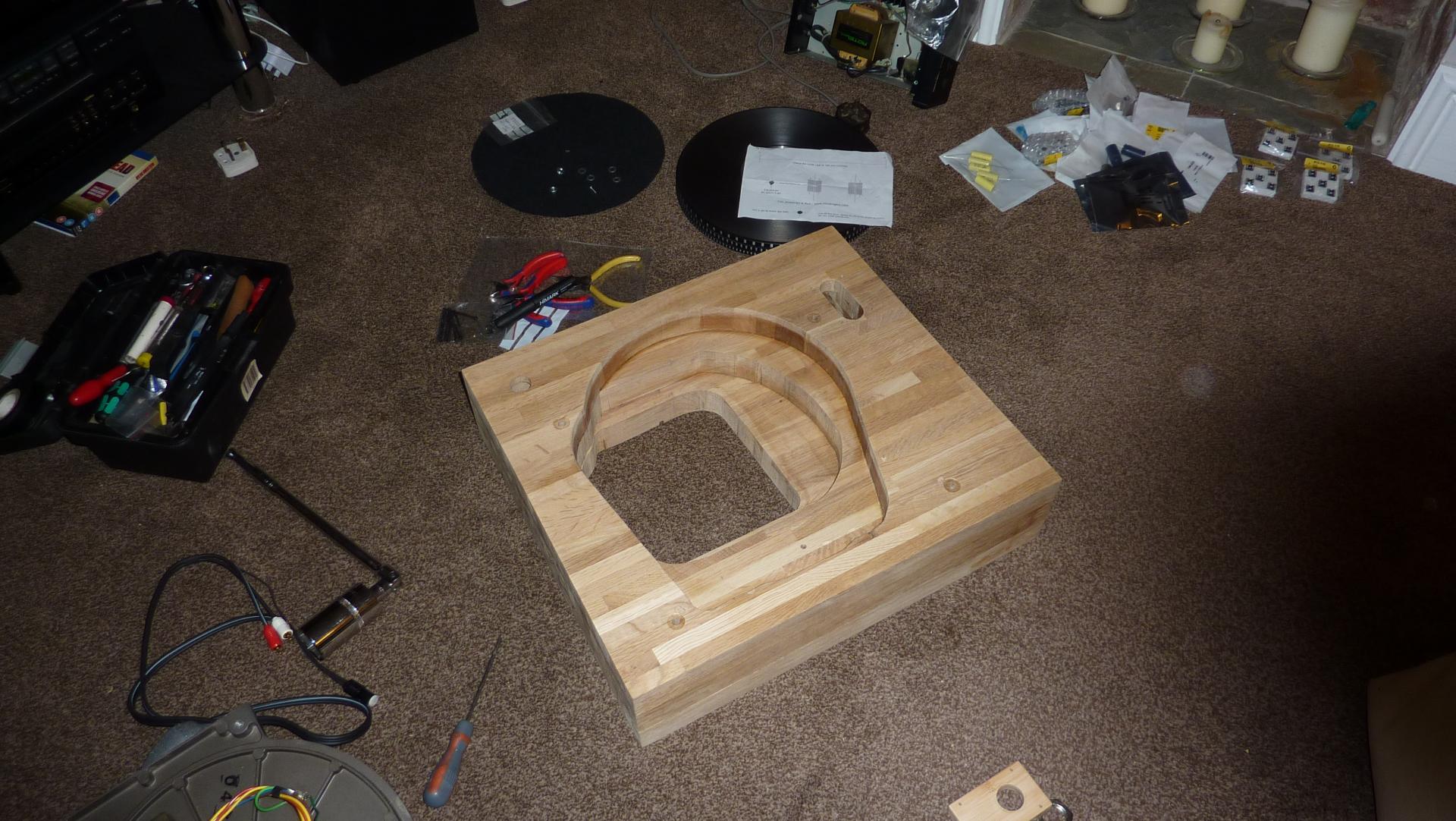

Beautiful Cold Beer.

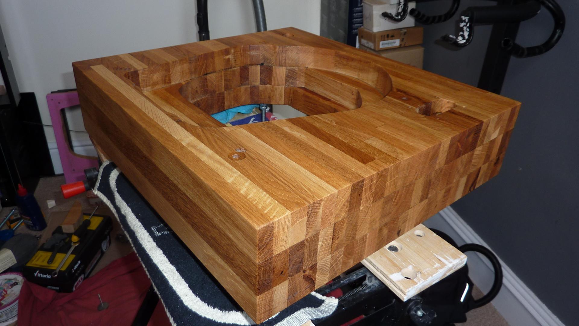

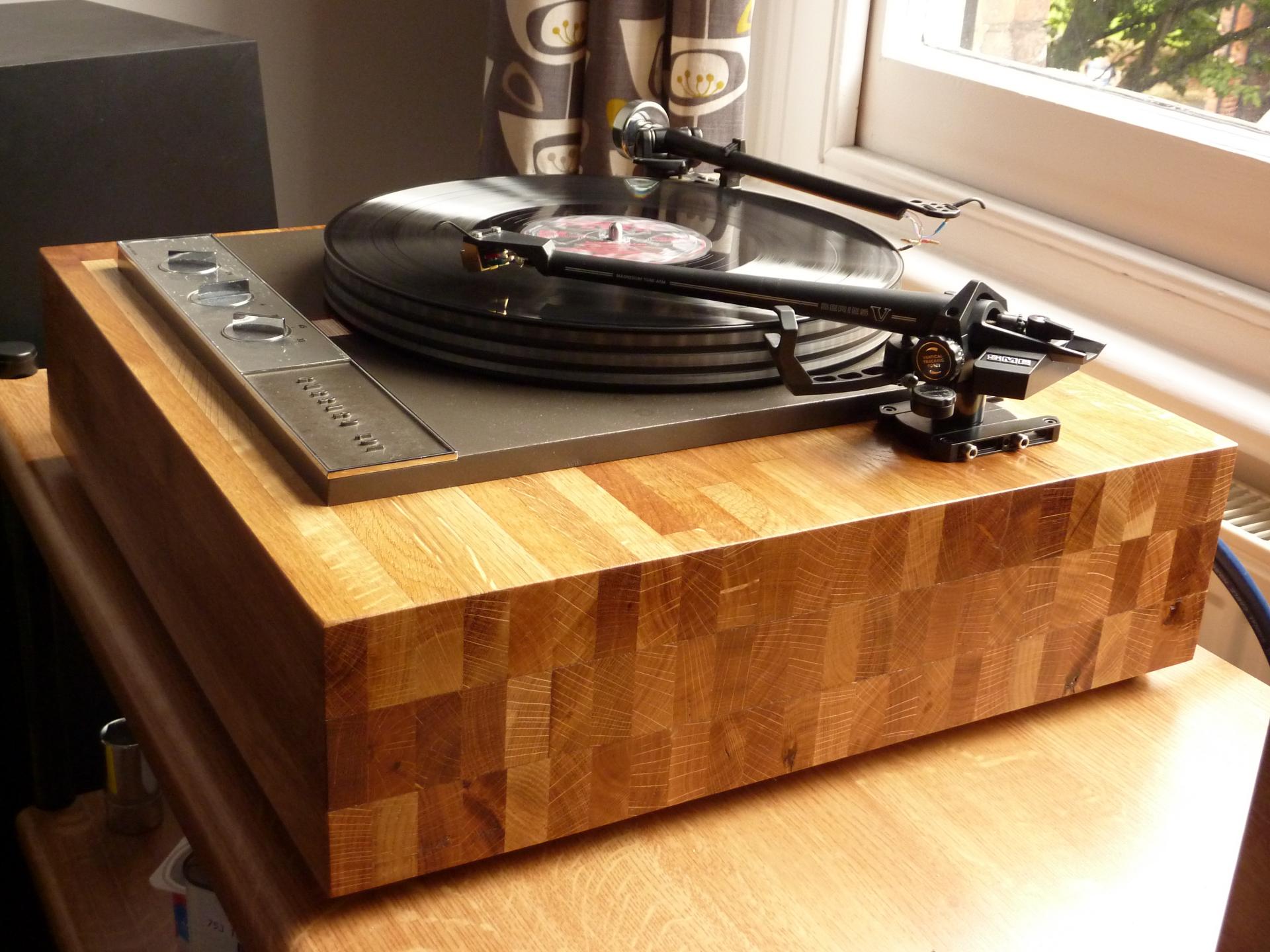

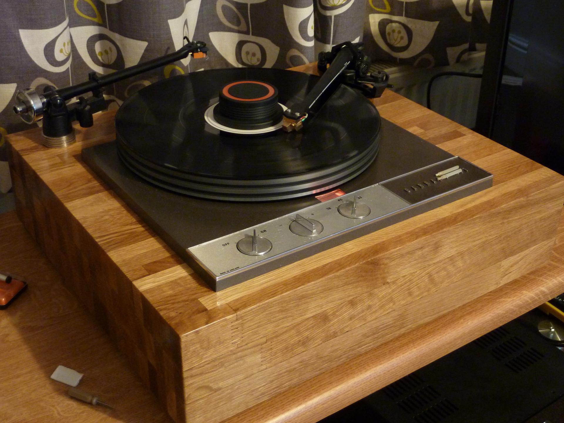

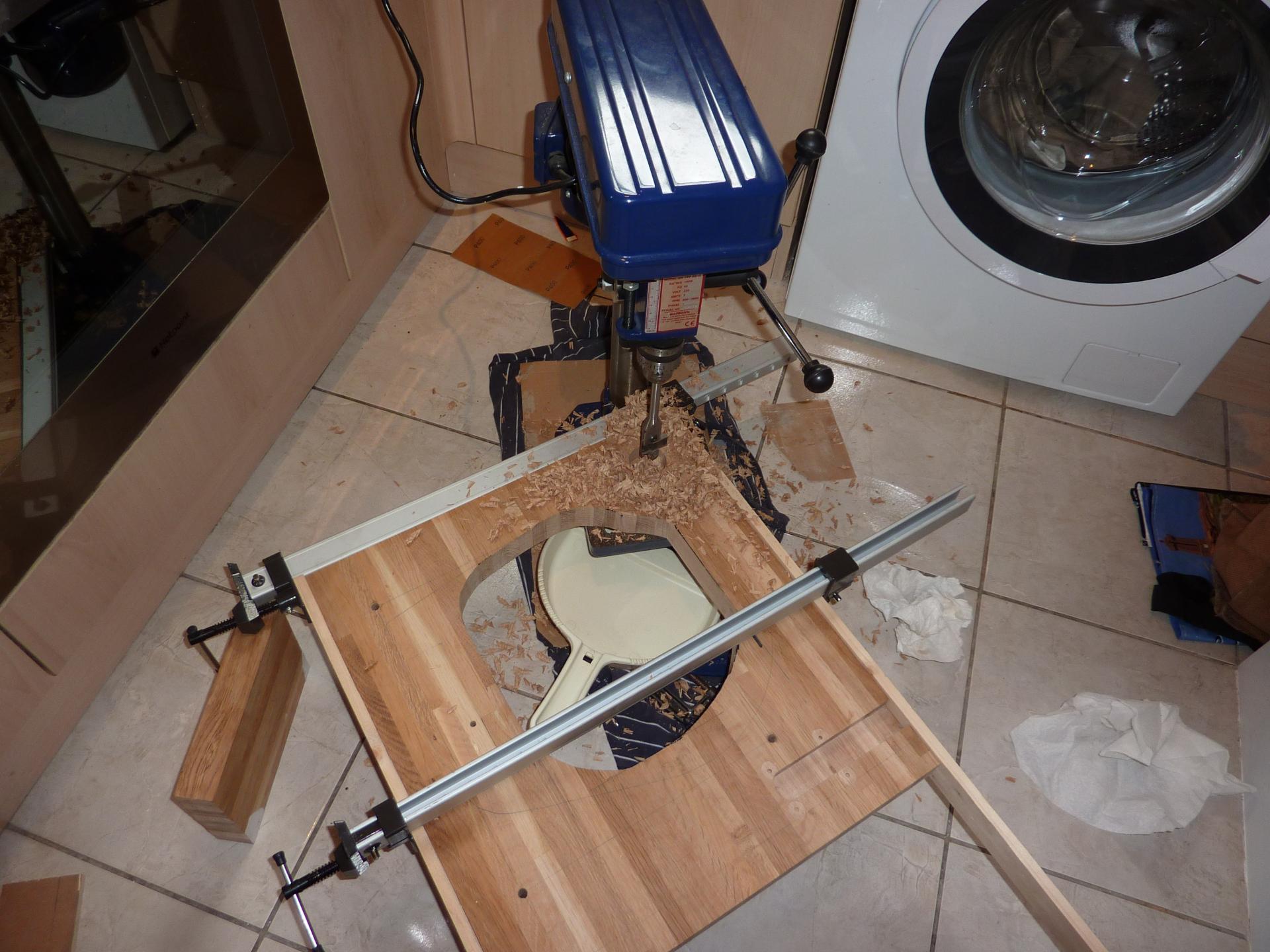

My one metre of Oak worktop.
The bottom layer is fabricated from the offcuts of the top two layers.
I skimmed the edges with my router end-mill stylee by clamping a couple of strips of wood either side to use as a refence edge, worked a treat but I had to enlarge the base of my router to span the gap.
Tung oil finish.

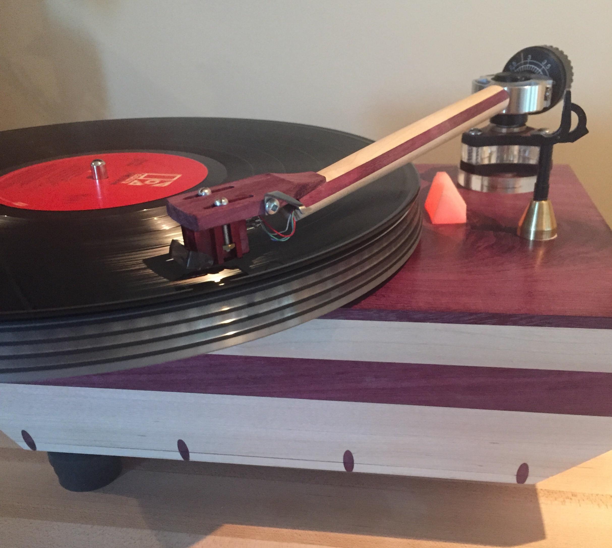

Updated ... modified the plinth size, the motor pod housing and the pulley changed to solid copper ( instead of aluminium )
Arm modified to micrometer VTA adjustment.
You cant see them in the picture but changed the feet from maglev to points resting on sorbothane pads.
