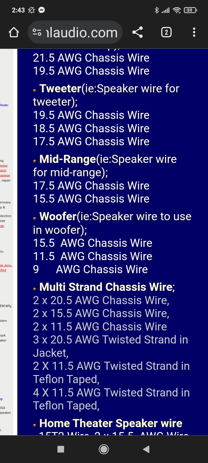

They suggest smaller wire for the tweeter, and larger wire for the woofer.Hi all!
Refer to the attachment, which is about Cardas internal hook up wire suggestion for speaker. If 17.5 AWG for the midrange, what about treble and bass unit?
Thanks!
9 AWG for an internal hook up wire would be over the top (would not make an audible difference) even using a 2000 watt two ohm woofer.
Those gauges would work fine as long as all the connections are low resistance.What about 19.5 for tweeter, 17.5 for midrange and 11.5 for the bass?
You could use any of those gauges for all the internal connections and still not hear the difference.
The speaker connections are often a higher resistance than a short piece of wire, and with oxidation, can increase to infinity- that's easy to hear
Not if you are a wire manufacturer!9 AWG for an internal hook up wire would be over the top (would not make an audible difference) even using a 2000 watt two ohm woofer.

Cardas is an "Audiophile" cable manufacturer so take that table with a big grain of salt.Hi all!
Thanks!
As mentioned by others, 18AWG stranded wire is a good general purpose choice, and works everywhere.
18,5 AWG and similar sizes are NOT standard, NOT in the "official" SWG table, and look made up to "look special".
Of course, only "they" offer those weird sizes. 🙄
9AWG wire (8 mm diameter) is nonsense inside a home/HiFi speaker cabinet.
