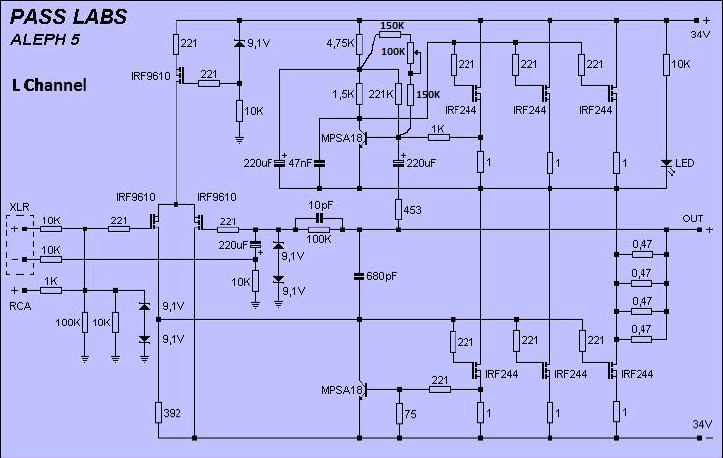

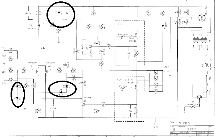

please refer to the attached schematic.
capacitor in parallel to all zener diodes

don't do that with xformer
find and read Quasimodo and Cheapomodo threads here
if you are not sure in what you're doing , better don't do anything

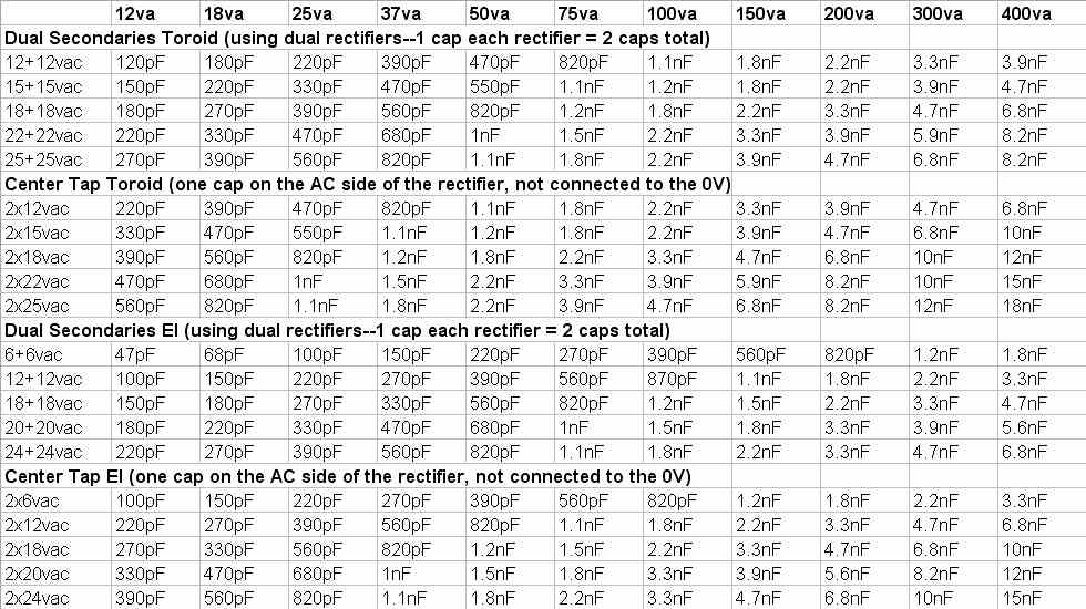

this table is good , but as semi-patch , not proper one , made after adequate test:

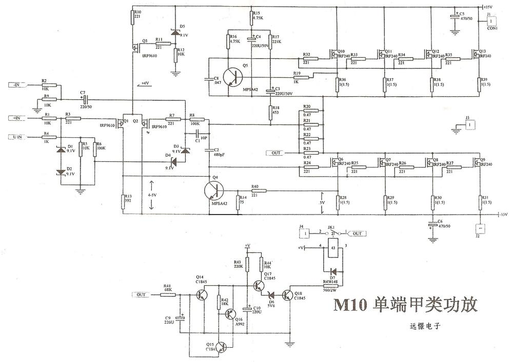

Hello ZM,
PCB development is in progress, I finally decided for the traditional 2 layers!

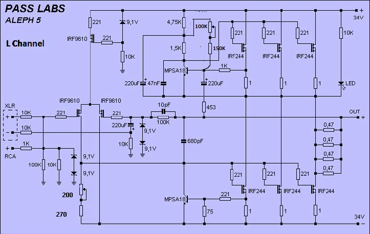

question about the output devices (IRFP240):
- the original design has 3 paralleled devices while the modified M10 has 4 in parallel. is there any advantage to have 4 instead of 3?
- power transformer output voltage question, would it be possible to have 2x26Vac as secondary?
- 26x1.41=36.7 - 1.4 =35.3Vdc
the original A5 asks for ±34Vdc voltage rails. don't think an addition volt and a half would be a pain.
thank you
Official Court Jester
Joined 2003
more output pairs , if you don't change anything - more heat and more grunt on 4R speakers
don't forget to alter current sense resistor group , according to number of mosfets .... in fact - that's already done on that schm you posted
for 34Vdc rails , compute AC as DC/1.25
so around 28Vac
1.41 is for lightly or non- loaded rectification/filter
