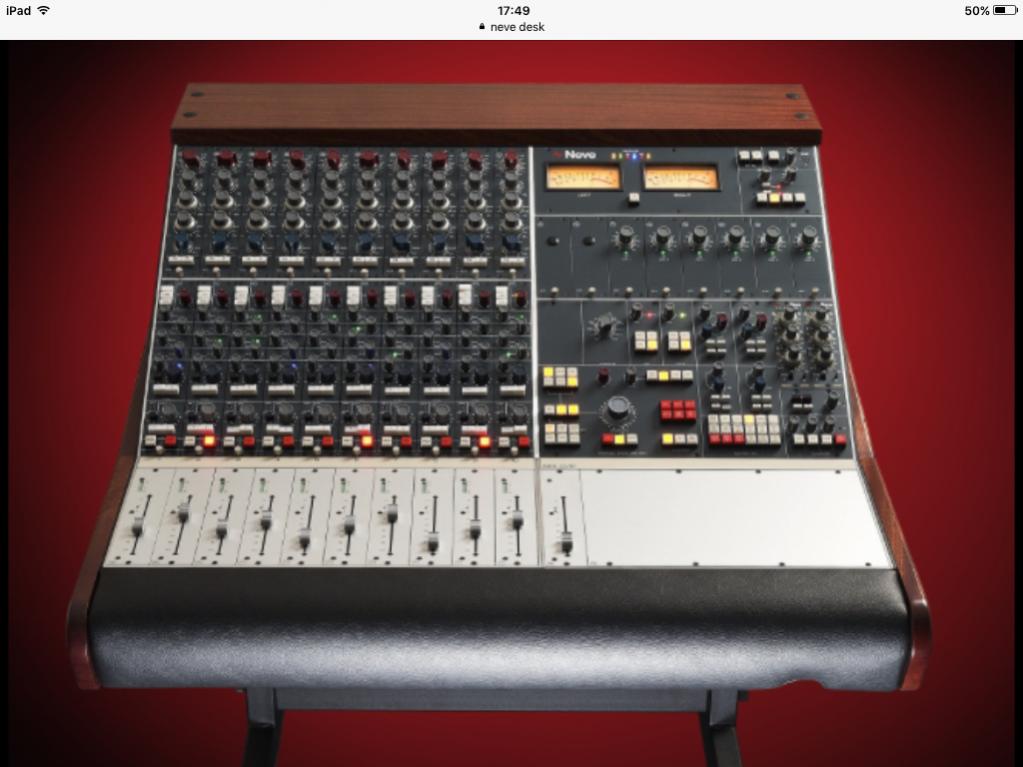

This was the desk in my office at work for 20 years. RIP Rupert.
