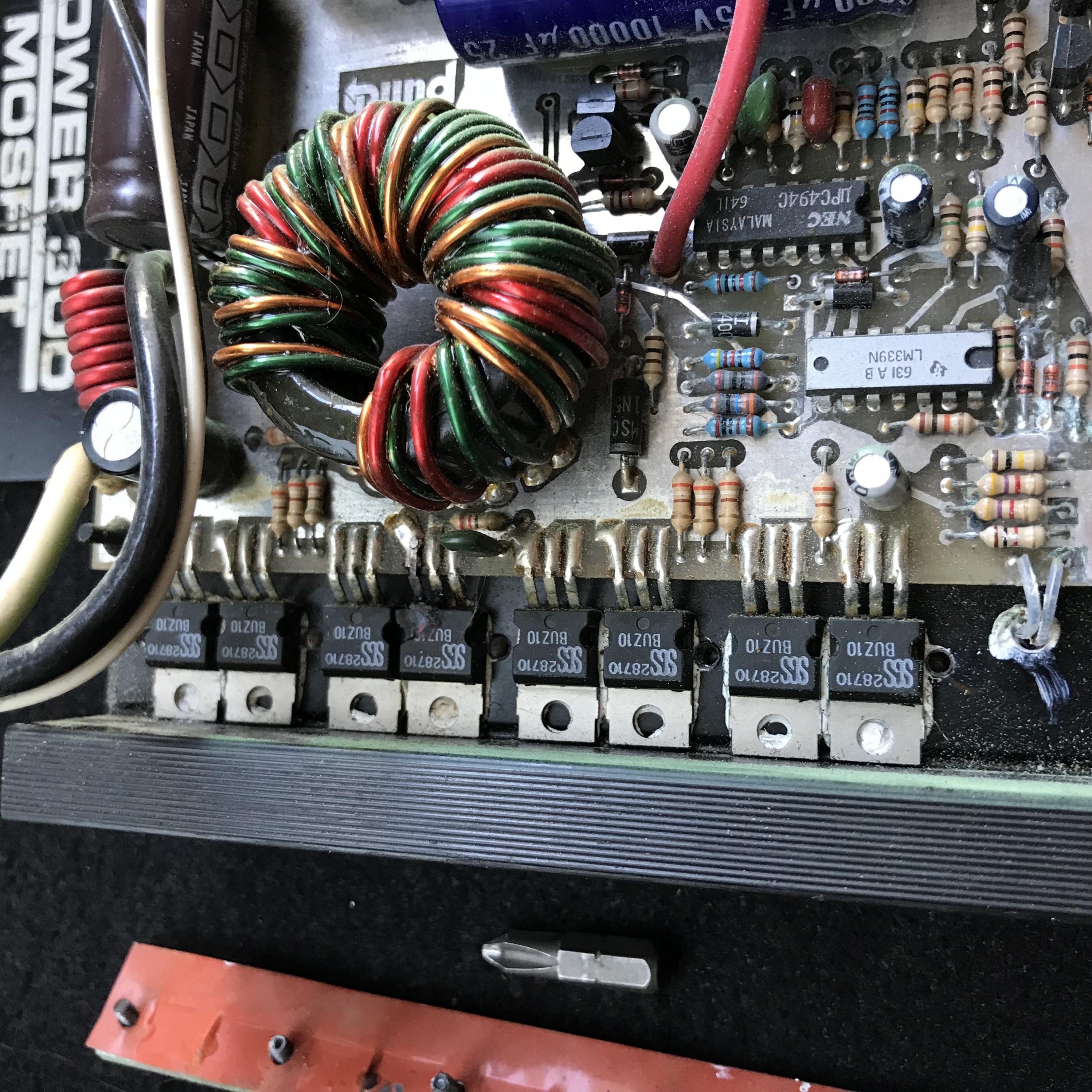

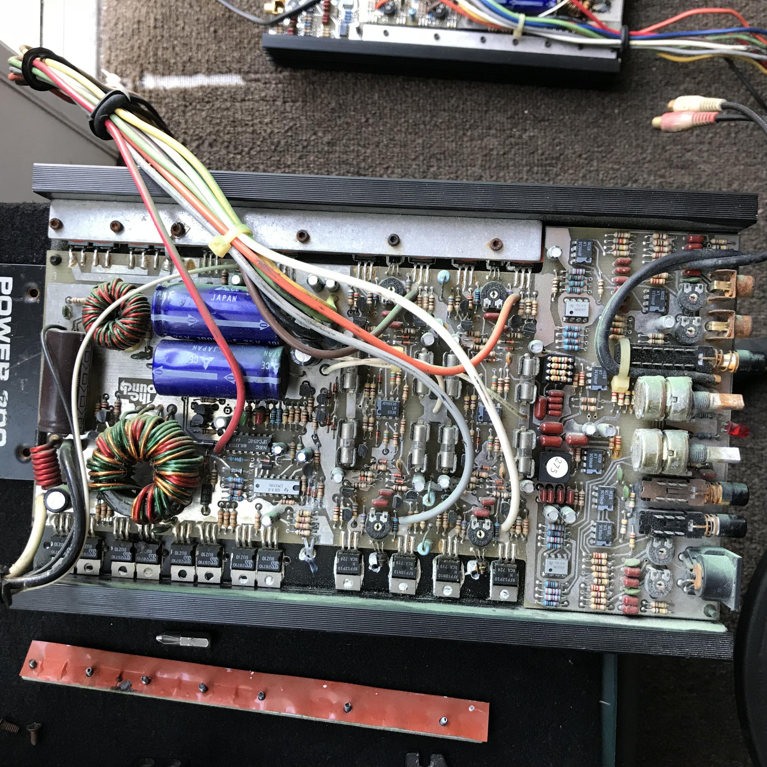

Here’s the board

Hi guys much the same problem, one buz10 is toasted. I didn’t apply power, it just came to me like that. I just wanted to check how the IRFZ44 worked out for you chipper, and Perry when you say 100ohm gate resistors I haven’t found a schematic so without wanting to sound like too much of a muppet which resistors on the board are they?
The parts I linked to are similar in spec to the BUZ10 so don't expect any more out of them. The IRFZ44 is a stronger part and will be more reliable but takes the added work of changing the gate resistors.
So long as the work is done well and the amp is given good electrical with a load it was designed for you will have no issues with either.
Thanks jkrokenberger, gutted that that’s a US seller as I’m UK based. I’m not after anything extra just to get the thing running (without compromising the sound it would already of had), I’m happy to build in some extra resilience though so if you/anyone knows of a schematic or could point me in the right direction I’d be well happy to change the resistors and stick in some IRFZ44’s.
