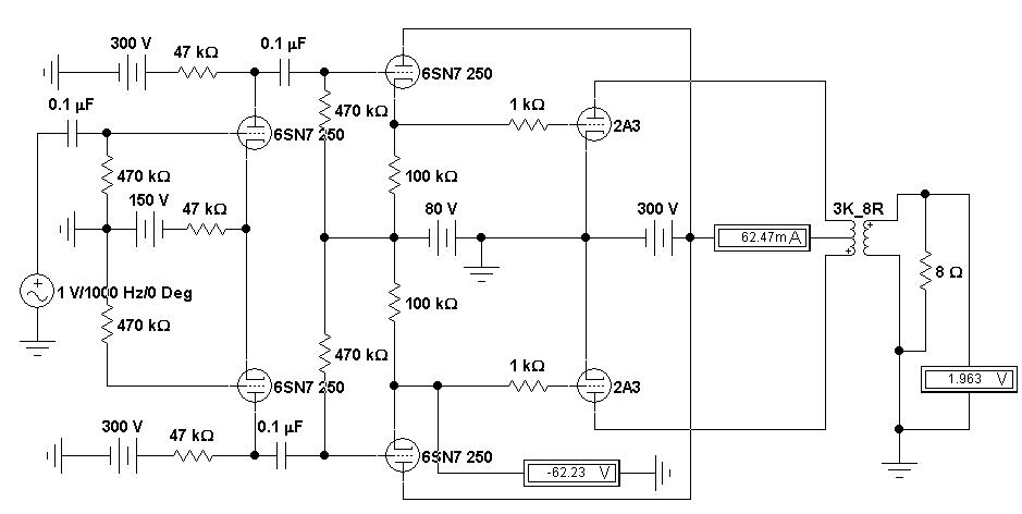

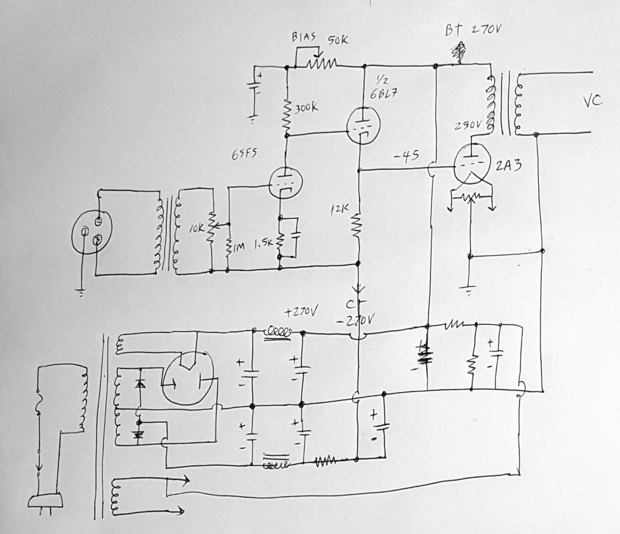

Going thru the various ccts it appears that many of the alternatives simply exchange one kind of reactance for another. So the RC coupling is gone to be replaced by an auto-transformer, both ccts are frequency selective.
Here is a first pass that does DC couple to the PP output tubes. It is not optimized, could be improved. Needs more gain, a 6SL7 Diff stage on the front end would cure that. The +ve & -ve PSs are not a problem, all can be got from a single CT HV wdg.

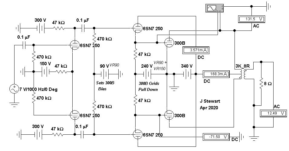

Optomized for PP 300Bs
A little more detail in this Sim. 19.5 Watts at clipping. All of the required voltages with the exception of the 300B heaters are easily produced using a common CT HV audio electronics PT. The VR tubes could be replaced by their miniature equivalents or Zener Diodes.
The Hammond 300B would be OK for this version if choke input filter was used. With Cap input the B+ is too high.
300B heaters are no problem in push-pull/fixed bias when you have a spare 5V rectifier winding or ample 6.3V winding current to spare.
That helps a lot, simplifies the power supply & can be done with an ordinary PT made for tube ccts.
Looking thru the thread again this AM it seems I completed missed the cct in post #10, it is essentially the same DC coupled arrangement as I posted. The power supply in that one could be simplified a lot, both +ve & -ve rails can be derived with a full bridge rectifier on the transformer with a CT HV connexion.
I used this kind of direct coupled cct circa 2001in something like the Circlotron setup in some Electrovoice amps. It got published in the May issue of AudioXpress magazine. The resulting amp with a pair of KT88s or 6550s easily cranked out more than 50 watts. I've put it into a PDF, if anyone wants a copy let me know.
Here is the cct where I used that direct coupled fix. The Circlotron is a bit confusing for those of us used to an ordinary PP cct. The audio output tubes form the two opposite sides of a bridge, the other two sides are the power supplies. The load (OPT) connects to the bridge at the power tube cathodes, the OPT CT is at Ground (Common). The DC current follows a path all the way around the bridge. There is no DC current in the OPT. The load impedance is 1/4 of the normal PP cct. All that greatly reduces OPT problems but the cct needs two independent HV power supplies, both off ground.
In this amp the output tubes are DC driven by a pair of 6J5 CFs. The amp front end is a two stage differential amplifier.

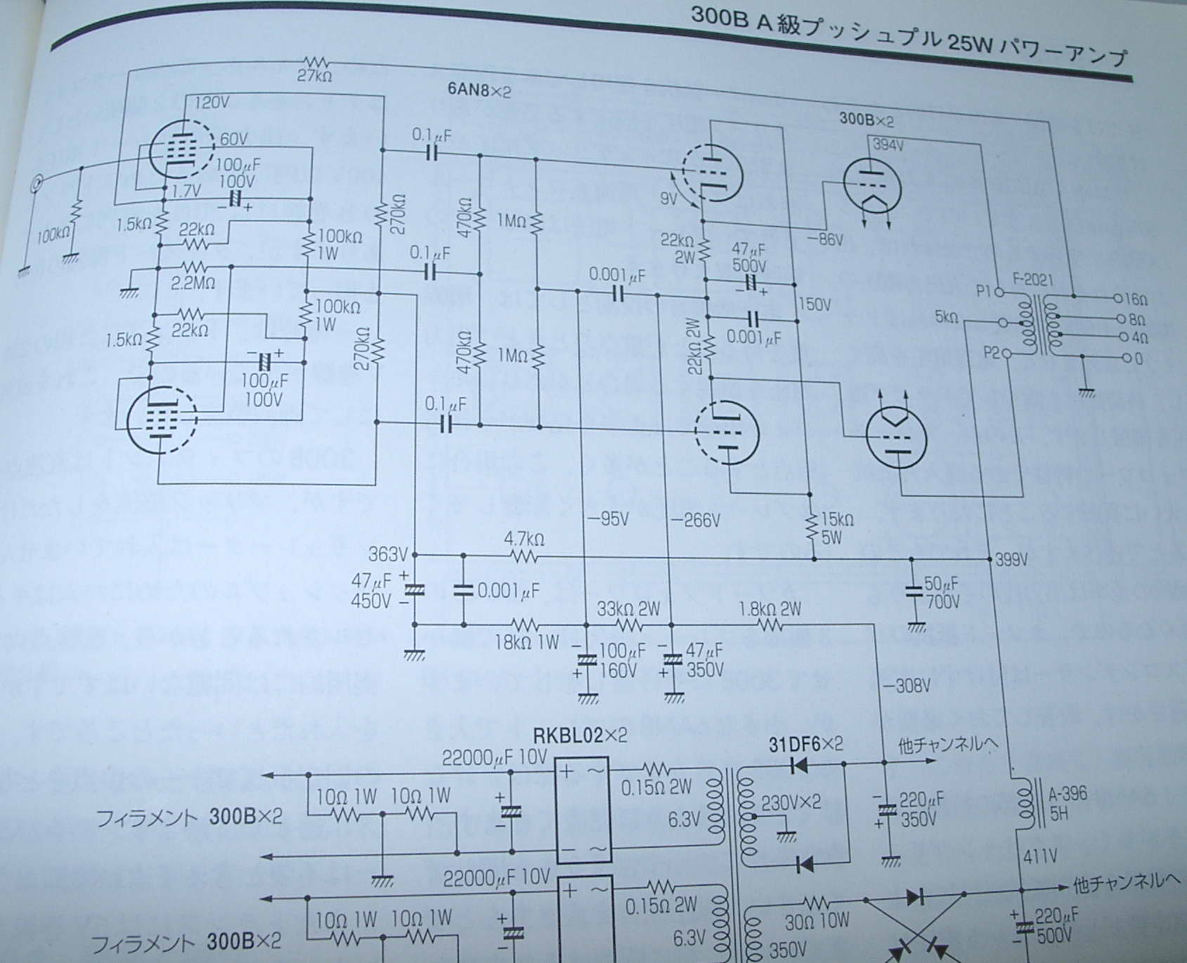

Ref the Komuro 300B SE cct. If you pull the 6V6 driver, no problem because the 300B has voltage potential of ~295V at the grid, and ~350V at the filament (so the tube is still biased and does not become a loss, valuable or otherwise).The problem always is if the driver tube is accidentally missing/burnt - you lose the valuable 300 one too, a big turn off.
The common cathode resistor of the voltage amplifier and the cathode follower reminds me of the Jadis JP200 preamplifier. But the overall circuit is worth trying, IMHO.Have a look at Direct driving 300b
Direct driving a 300b
I would prefer the 300B cathode grounded, maybe there is a way to re-arrange it. That means it needs an input transformer with an additional negative supply. Maybe the +/- voltage supplies could be derived both out of single PT secondary with center tap. @directdriver is a master of this kind of re-design.
Then using the input transformer as phase-splitter it could done in PP version.
I toyed around conceptually with this circuit making it DC coupled and push-pull through out with input transformer. The floating paraphase splitter is now not needed. I kept all the voltage relationships the same as original. I had to change the feedback mechanism so it's PP from the 300B plates because now the input tubes' cathodes have high negative voltage. Obviously the output transformer is outside of the feedback loop a la Western Electric 118. It requires two supply rails, one positive +399V and one negative -266V. Similar style power supply can be seen here. The advantage of this over single supply or stacked supply is that if the 6AN8 input tubes were pulled there's no harm to the 300Bs because it would have -266V on their grids to bias them into cut off and no danger of red-plating at all. I just need to figure out a way to individually adjust negative voltage on 300B grids (It's much harder without blocking caps!) without affecting the input tubes operation points in case you don't have matching 300B tubes or due to aging and drifting. Really tricky to do! Fun exercise!

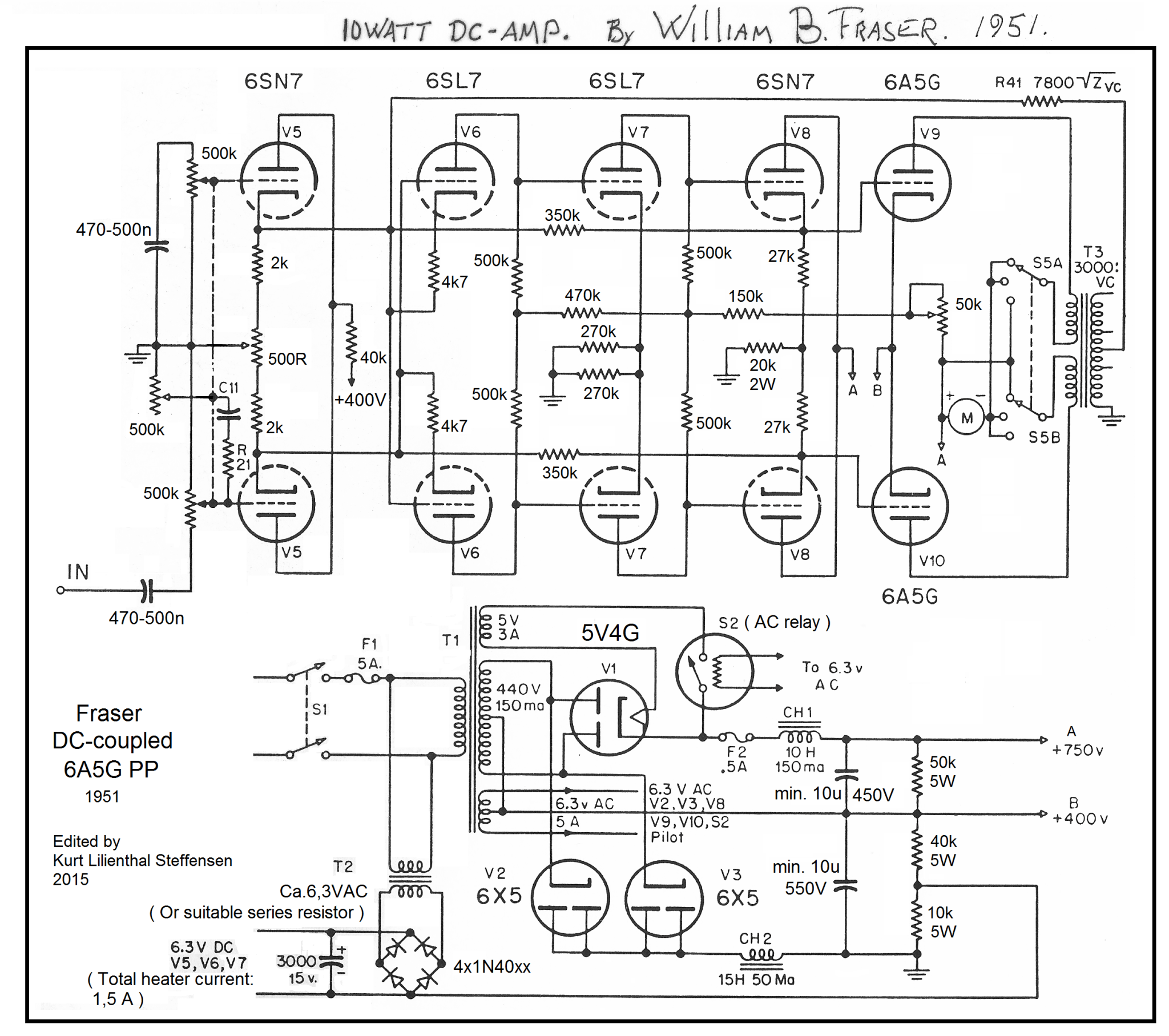

Here's William B. Fraser's from 1951:The only real DC PP I know is from Acrosound 20 with EL84.
I am sure others exist but I never experienced other design.
Just found the article from Audio Engineering magazine:
http://www.elektronikjk.pl/Elektroa...ampowe/A_15-Watt_Direct-Coupled_Amplifier.pdf
15-Watt Direct-Coupled Amplifier by William B. Fraser, Apr.15, 1951
