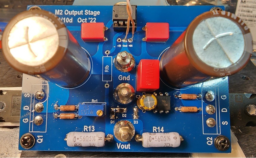

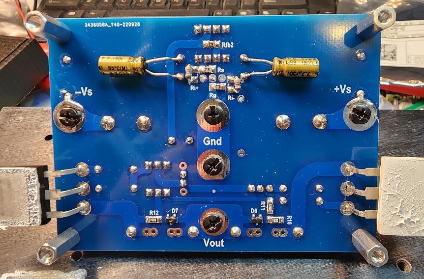

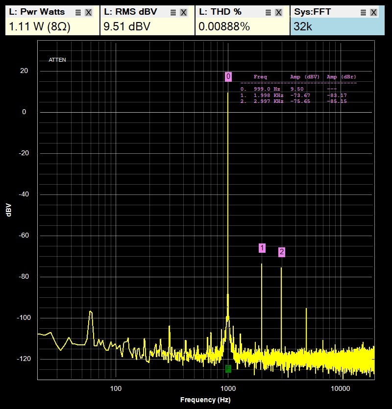

Thanks thanks to Patrick (EUVL) for such a great variation of the M2(OS). No unobtanium or expensive parts required either! :cheers:
THD in the range of class D amps but without any of the undesirable cold heatsinks :cool:
0R56 for R13/14 gives about 1.4A of bias and matched 240/9240. I didn't have 3.3uF caps so used 1u film on top and 2.2u elytic below

This version is still local feedback and M2OPS is not in the feedback loop (post #26).
Once you include the OPS in the opamp feedback loop (post #24), the distortion will sink to opamp level.
But different sound.

Not surprisingly, the above measurement corresponds to what we published before :
https://www.diyaudio.com/community/threads/complementary-power-mosfets.378024/post-6889027
https://www.diyaudio.com/community/threads/complementary-power-mosfets.378024/post-6888301
So if one is to go for the local feedback option, the ideal candidate for the MOSFET pair is 1SK3497/2SJ618.
Apart from much lower distortion, they also allow output swing closer to the rails, due to their much lower Vgs at bias.
Patrick
