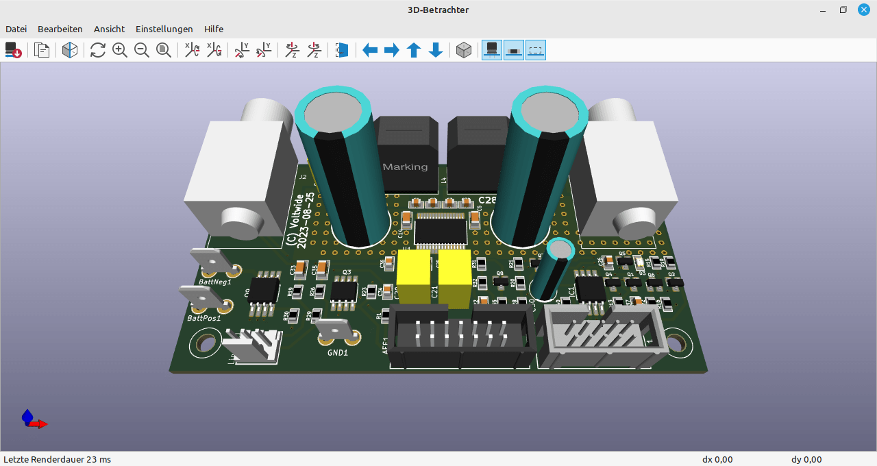

My first TPA3116 design started in 2014. Since then I enjoy these driving small guitar amps with 6 inch drivers. This is my actual pcb, providing some features useful for battery operation such as under-voltage lockout and an automagic watchdog shutdown.

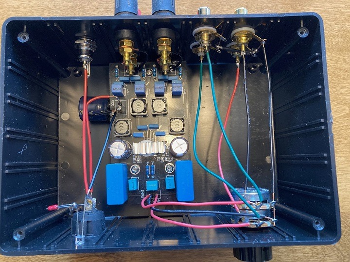

I'm trying to add a separate line out to my DIY TPA3116 amp, and I'm having trouble.
Since these will be used for a powered subwoofer, I'm tapping into the same wiper and ground pins that connect to the amp. For some reason, doing so cuts out one channel of the amp. Is it not possible to control the voltage to the amp and to a line out with the same potentiometer?
The RCA's with the green wires are the added line outs.
Thanks, Mike

Thanks @Turbowatch2 but I'm not sure what you mean. It appears to me that this amp is only using the + side of the differential inputs. I assume the middle input G goes to both L and R - inputs.
I believe the amp is going into protection mode for some reason. When I connected the speaker outs to the subwoofer's high voltage inputs in parallel with the main speakers, one side of the amp quit working as well. Weird.

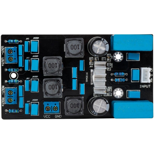

It looks as if you left the second ground on the amp PCB open. These amps need ground on both input channels. as they are 4 channels bridged (BTL) into 2 (or 1 in PBTL).
Have a look at the schematic of the TPA3116 page 13 and 26
Actually you may be on to something. I wonder if I'm connecting LINN to ground and converting the amp to PBTL? I have an idea this isn't meant to be :cry:
If you look at the PCB, you will find two ground connections near the signal input. One for each of the two channels this amp board has. You connected only the ground on the left, so the one on the right is floating and the channel will not work.
How you route ground on an amp PCB is nothing to be taken easy, it will have a huge impact on noise.
You may be able to convert the board to PBTL, if you look into the schematic and are able to find the right connection points. This only makes sense if you half the speaker impedance to 2 Ohm, on the same 4 Ohm driver output power will be identical, BTL or PBTL!
