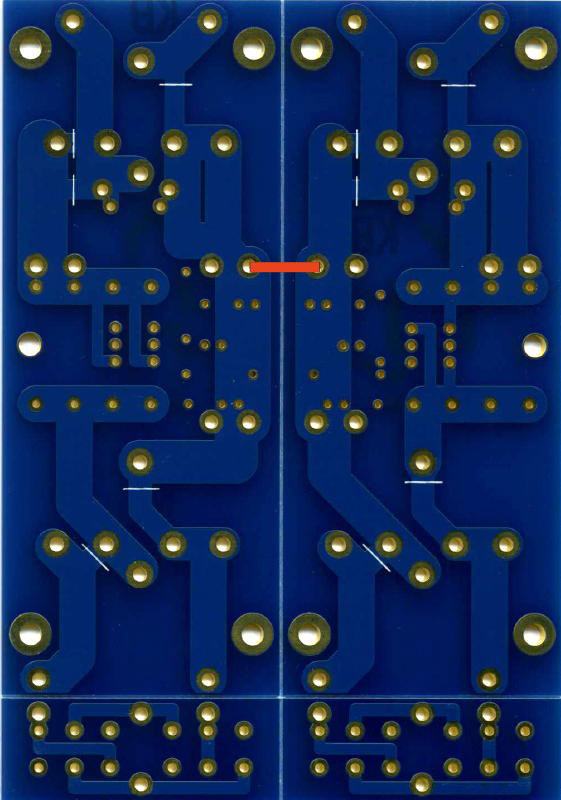

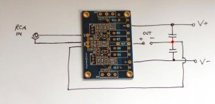

What is the optimal grounding scheme for this PSU when used as V+/V- ? It is for an F5 amp.
Specificaly where is the best place to pick up the chassis ground? Best place to hook up the neg speaker terminals? Do the two center "ground" traces need to be jumpered together?
Thanks!
carl
Yes, it's recommended to connect center ground traces (red jumper in attached pic). That would be your power star ground where all other grounds are connected (also the chassis ground). Attached is also wiring diagram for F5 amp.

Thanks Peter,
I essentially connected as you suggest with the exception of not using the jumper on the PSU board. I ran 6 independent ground leads from the GND of the PSU - one to each neg speaker terminal, one to each amp board, and two to the chassis(one from each side).
Everything appears to be functioning normally and the amp is quiet.
