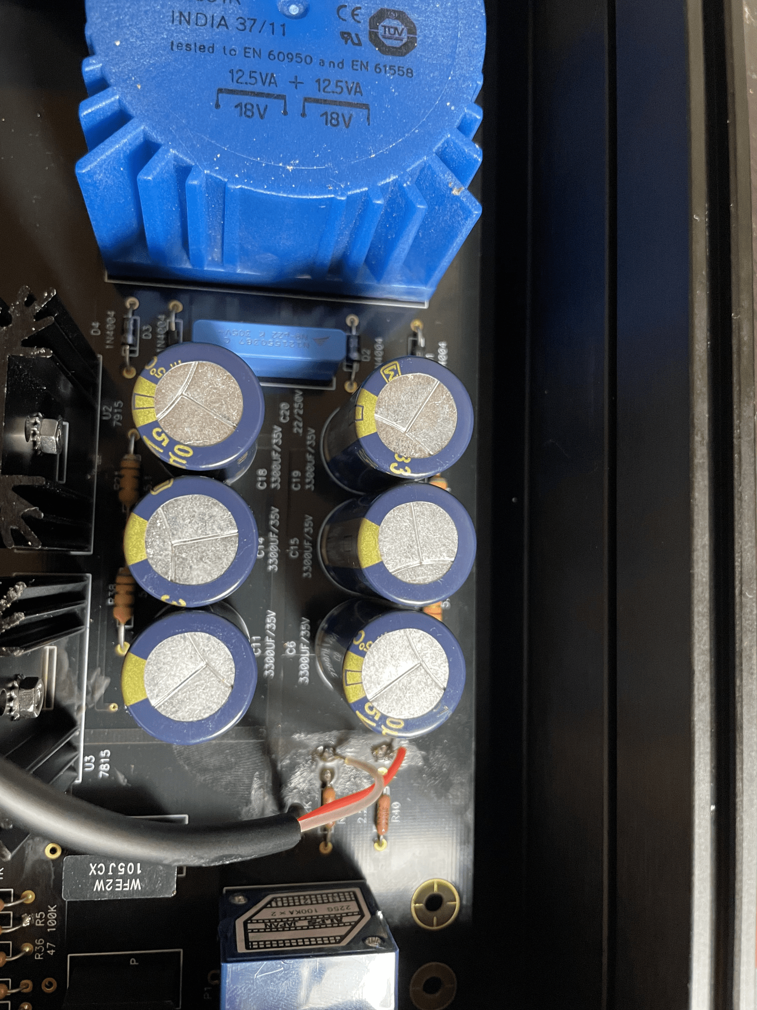

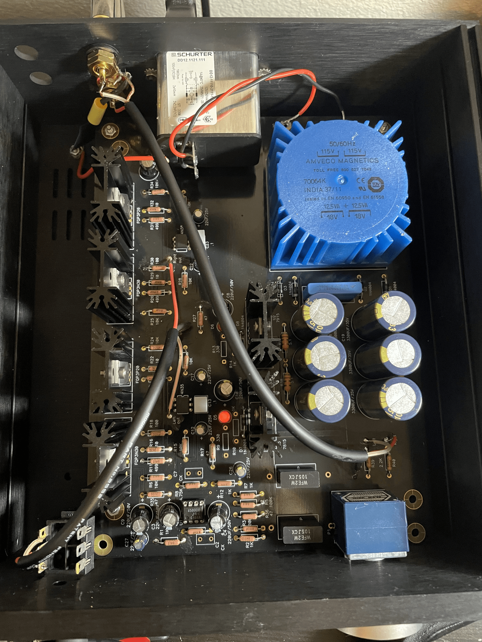

"Finished" the WHAMMY and I'm getting very odd behavior. Whenever I turn the amp on I get no output, however when I turn it off it plays very loud, distorted music that slowly fades over the course of around 5-10 seconds. I'm not really sure where to begin with troubleshooting for this. Aside from checking resistor values, is there something else I should look at specifically?
That was actually the first thing I checked. They are correct, although I had previously made that mistake while making the power supply.Check that the transistors are right. 610 in the 3N30 spots, 9610 in the 3P20 spots.
I went through all of the resistors and nothing seems out of place. All of them read what they should. I don't see any obvious shorts, and I don't see anything out of the ordinary in my wiring job. Pulled it apart and looked at the undercarriage, no obvious shorts. This is the part where wish I start to run out of non-destructive ideas.
Fuse drawer only has a fuse on live, neutral is bridged. Finally got in that part you recommended last week.Have you got fuses in both slots in the fuse drawer?
I checked before I started filling the rest of the board and they were + and - 15.1 volts I believe. Now -v measures -10.69V between the r13 and r14 pads and voltage between + pad on C9 and ground measures 1.05V. When the amp is turned off voltage climbs to 2.3 volts and then slowly drops again. Anywhere else I should measure?Have you checked PSU voltages?

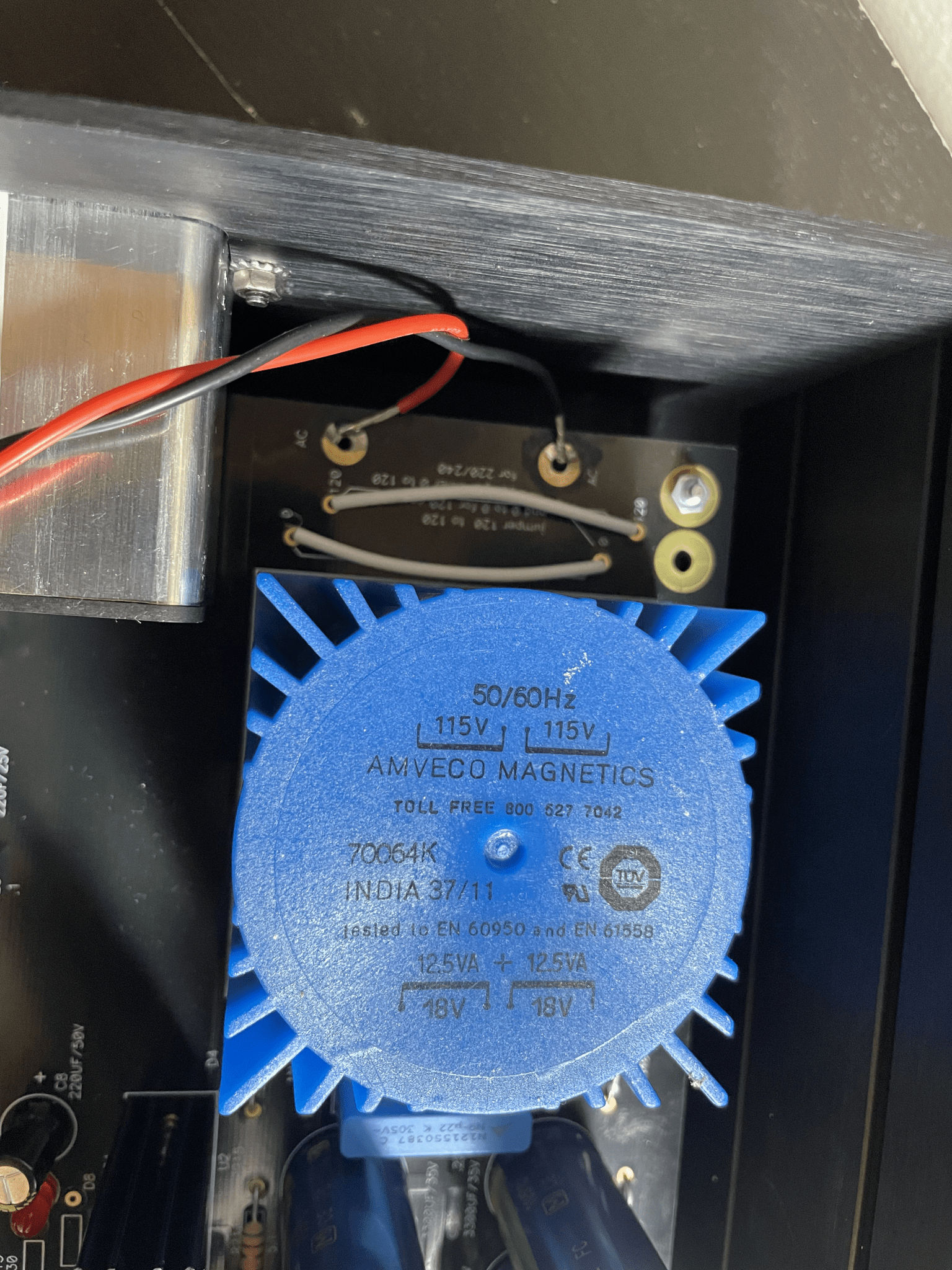

119.9 VWith meter set to AC volts, carefully measure the voltage across the AC pads on the PCB, or the L an N terminals of the power module.
Ok, that’s good.
Meter to DC volts.
Black probe on the ground of the output wires, or the tab of the headphone Jack nearest the chassis. (sleeve). This is ground, Ground is ground, keep the black probe here.
Red probe to the following -
Each of the (unstuffed) R10 holes.
Each of the (also unstuffed) R14 holes.
Meter to DC volts.
1.05V on R10Red probe to the following -
-10.73V on R14
Also, just for clarification, these measurements are with music playing. Don't know if that makes a difference.
Thanks for the help. Do I need to replace both, or only one?The regulators are dead
