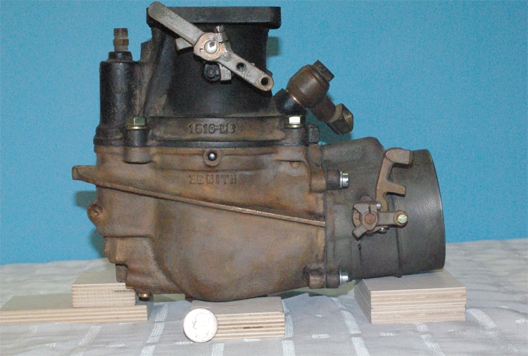

It took me only 4-1/2 years to rebuild this updraft Zenith carburetor for a 2008 cu-in gas V8 engine in a 35-ton Plymouth ML8 locomotive. Note US quarter provided for scale. This was my first carburetor rebuild and hopefully my last. We’ll see if it actually works after spending $200 on the rebuild kit and so many hours cleaning decades of dirt inside and out. The guy where I bought the kit said if he had one of these for sale in rebuilt condition, he’d be asking $5000 for it.

You have a locomotive for casual use?

I suspect this is #4463 at the Arizona Railway Museum.

My first thought was that you could plop a Holley 2300 2bbl carb on that engine and it would run better than new. Down-flow converts to up-flow with a bent pipe, like a sink drain trap only bigger. There's a turbo-four shop in your town which does such big bends every day. 21st-century TIG-welded! The boat-shop has hand throttles.
Ah, but the Le Roy is governed. Flyballs pull-back the throttle at 1,000RPM. The revised throttle position may not suit the linkage. The project has overcome too many problems to risk an over-rev. Ignition limiters are rude and may not be adaptable to Bosch magnetos.
