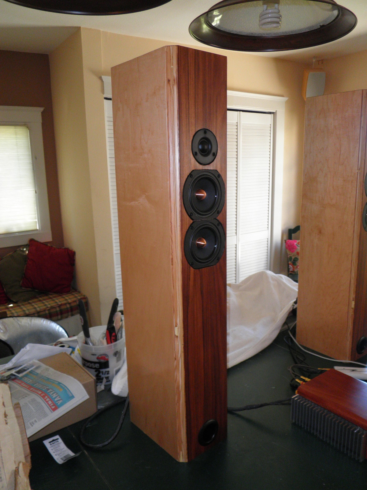

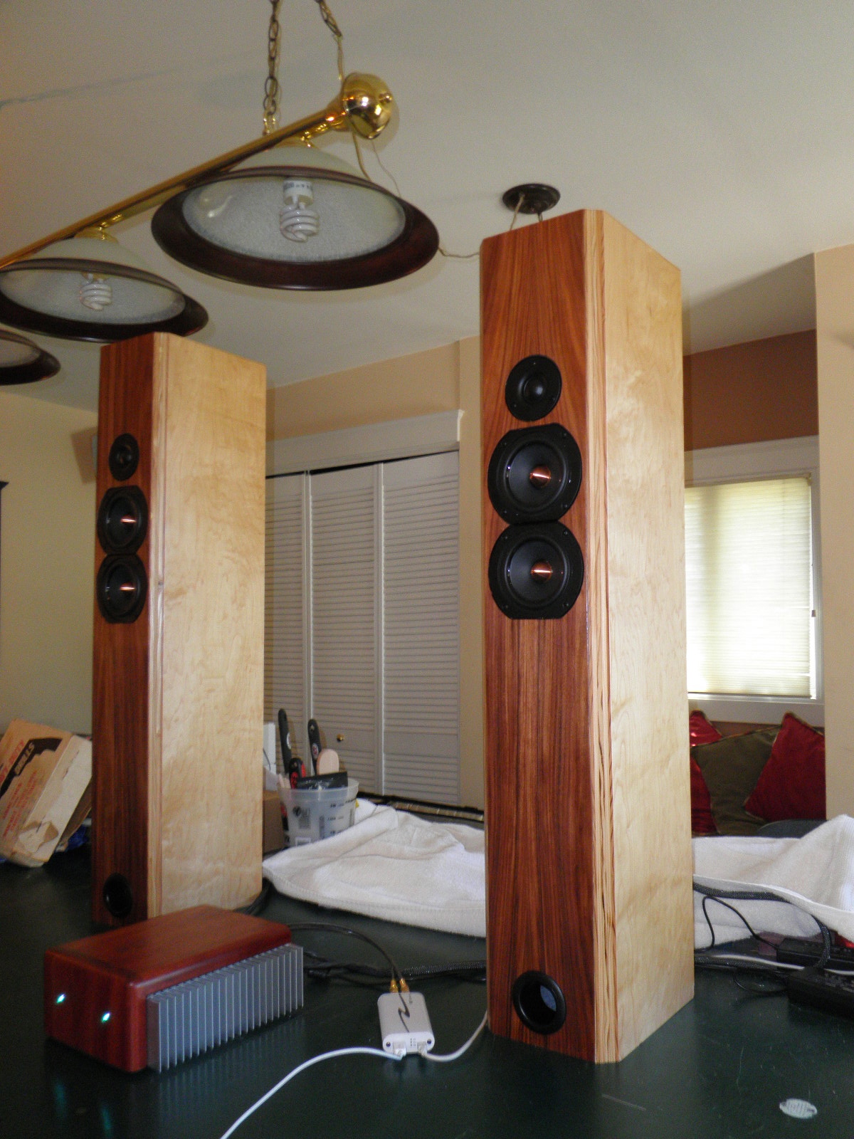

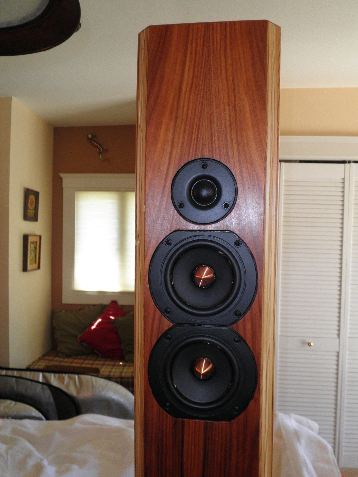

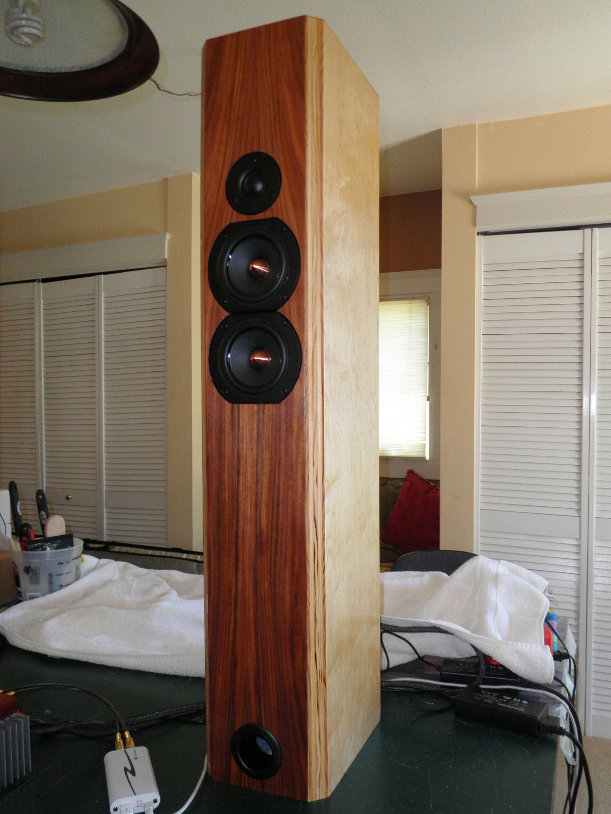

I finally finished the "Alegria's" designed by Tim Forman. It's drivers are the CSS WR125SRT mid woofers and the CSS ERT26 tweeters (used instead of the FostexFT207D tweeters that the design calls for).
The 16R 125s are driven full range and wired in parallel for an 8R load and the tweeter is wired with a 3R resister in series with a 1.0uf capacitor.
Existing wood pieces from past projects were used for the cabinets: Baffle/tops/bottoms were high quality 15ply 3/4" Latvian birch. The sides were poor quality, prefinished HomeDepot 3/4" 5ply maple. In retrospect I should have listened to my woodshop instructor who suggesting burning the prefinished crap, but waste not want not I used it anyway...with lots of filling putty. The front baffles and tops are veneered in rosewood.
They sound outstanding! The drivers had about 150hrs of break-in before using and I'm impressed with both the detail and punchiness of the 125s in these cabs....they crank convincingly and go much lower than I expected. I may decide to go with a higher resistor value for the tweeter after many more hours but the jury is still out on this one.
Thanks to Bob at CSS for the great bargain/value of the drivers, Tim Forman for the design and Dave at P10 for making the plans available online.
Mario
