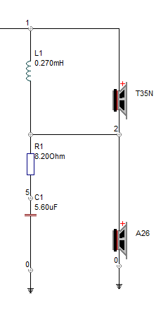

This is the serial crossover Håvard sent to me and kindly allowed me to share with the DIY community.
See below for his comments in pure unadulterated Norwegian bokmål:
It will only work as intended with the Seas tweet as per the schematic.Her er et eksempel på seriefilter jeg simulerte til A26 i sin tid. Aldri testet fysisk, men ser ut til å funke bra. Kan sette på 1uF parallelt med R1 for å løfte den øverste oktaven, men da ville jeg også økt R1 til 10ohm. C1 kan justeres for å endre nivået litt rundt 2-4kHz.
And for those lacking in Norwegian:
Here is an example of a series filter I simulated for the A26 in its day. Never physically tested, but seems to work well. Can put 1uF in parallel with R1 to lift the top octave, but then I would also increase R1 to 10ohm. C1 can be adjusted to change the level slightly around 2-4kHz.

I've been using this crossover as specified since I put it into my system some months ago. With some sources and amplifiers, the treble is a little hot. I haven't experimented with a padding resistor on the tweeter.View attachment 1222563

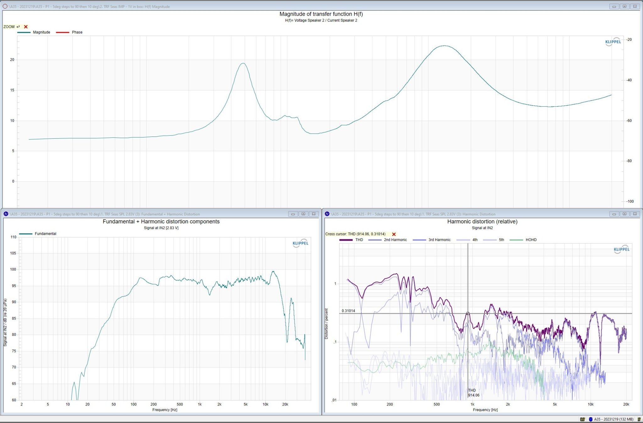

As promised above here is a snippet of the Klippel measurments of our A35 speaker taken at Seas r&d lab facilities.
Please note that this is at 15 degrees as we tuned the speaker to be pretty flat to the wall so 0deg has a slightly rising response.
The extremely simple serial filter presents a benign load that most amps should cope well with, and distortion is kept at a low 0,3% in the midrange - rising to about 1,3% in the mid-bass/bass. Also, for those of you onteresred, the effect of the aperiodic tuning is clearly seen.
Best Rgds
Clavius
