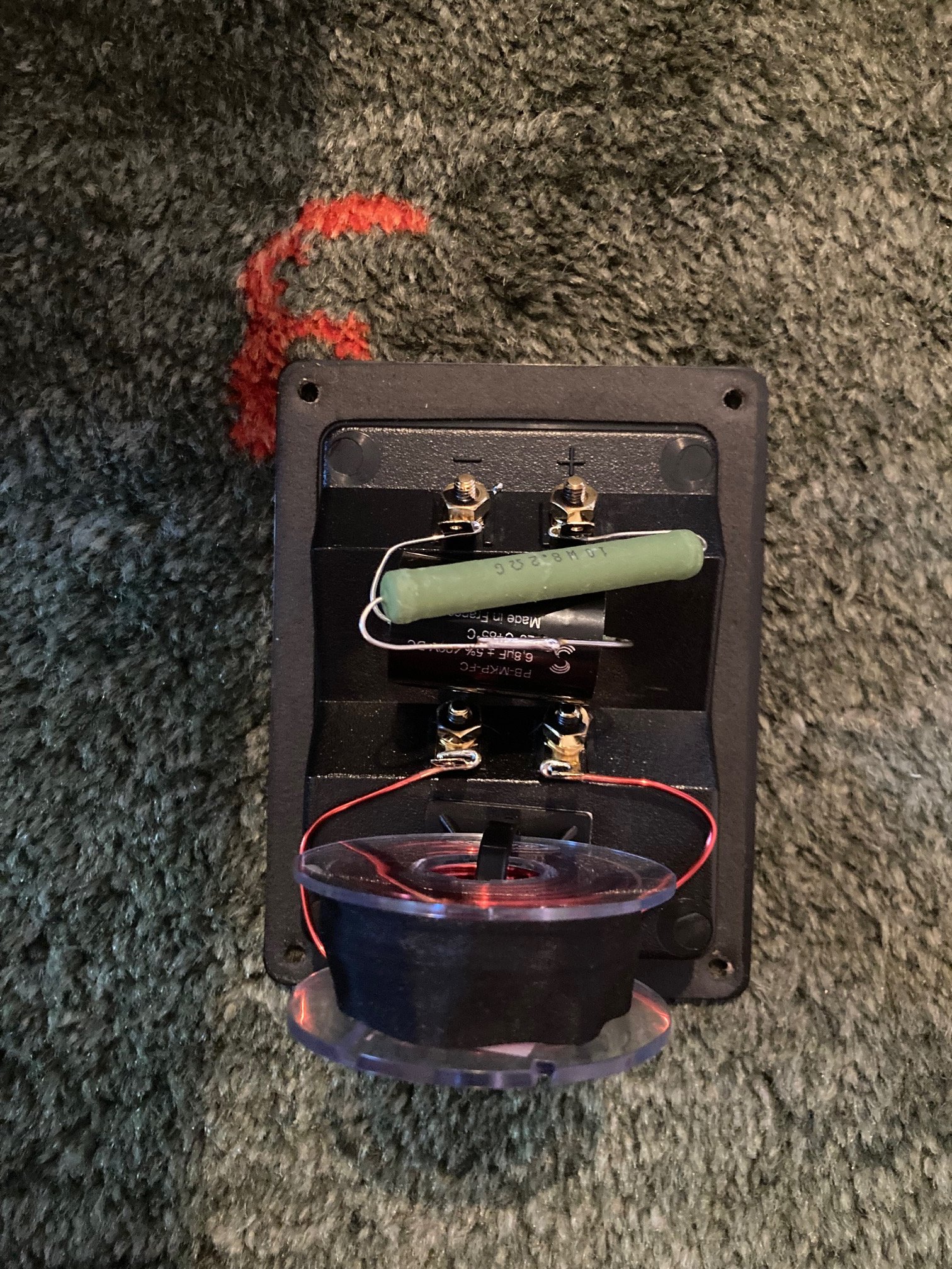

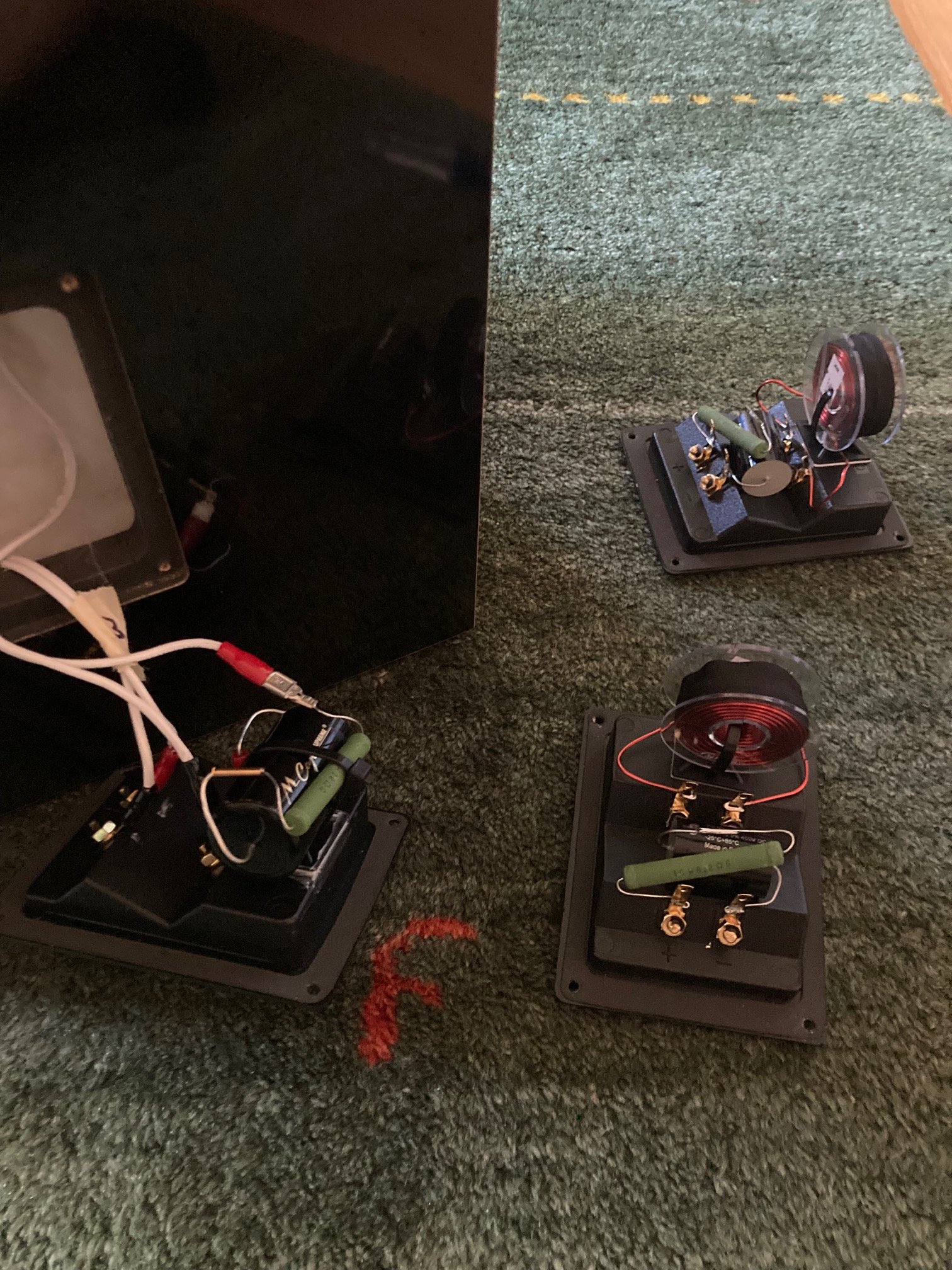

Yesterday I swapped crossovers in my Seas A26 from the Håvard series crossover back to the standard parallel 3.3uF/10R crossover. To my ear, the standard parallel crossover has a set back, muted midrange relative to the Håvard series crossover, but also more treble detail. The set back sound leads me to wonder whether there are phasing issues at the crossover point in the standard parallel crossover, that mutes the midrange. The treble detail in the standard parallel crossover however leads me to wonder if the tweeter would benefit from a blocking capacitor in the Håvard series crossover.
I did all this because I originally wanted to add an ohm or two in series with the tweeter in the Håvard series crossover, to pad it down. Now I sense there may be greater issues at hand with the tweeter's shunt coil not shunting all of the LF around the tweeter.

I thought about this a little more & decided that crossing the midwoofer a little lower in the Håvard filter was worth a try. This might be confirmation bias, but my perception is that doing so reduces the midrange shout (most obvious in records- they sound less 'recordy') & keeps the drivers from stepping on each other as much in the midrange- vocals and vocal echoes seem cleaner now. Anyway I had some Solen 6.8uF caps laying around so it was easy to swap out the Solen 5.6uF in my Håvard filter.
I do much, much prefer the forward, full sound of the series Håvard filter to the stock parallel crossover, separate of any tweaks to crossover pole.

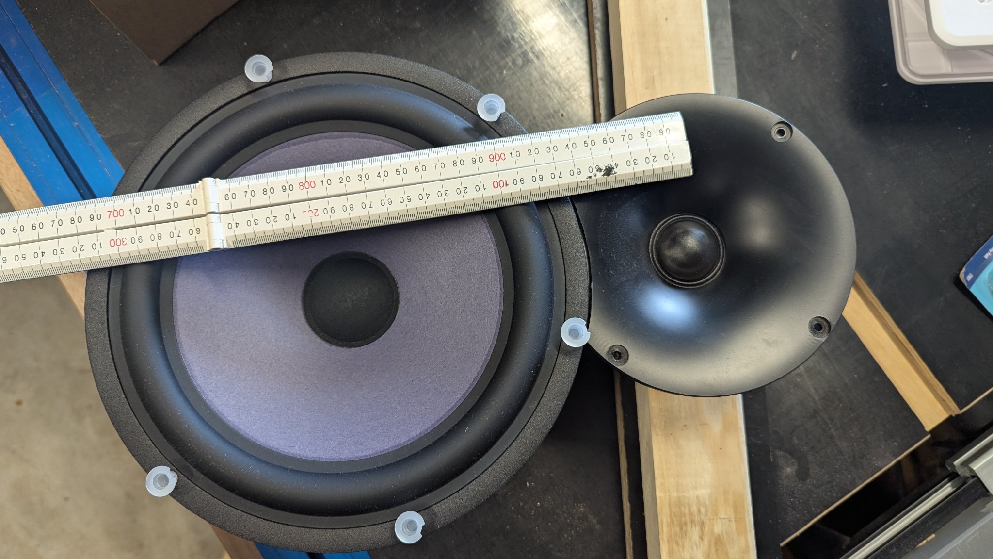

hello patrik96 how did you remove the dust cap of the woofer ? did it come off easily ?May it help:
I bulid a O96? clone AR26(magnet add+ DIY phase plug) + Morel378
The XOver is relative simple, the sound is comparable my AN E Silver Hemp

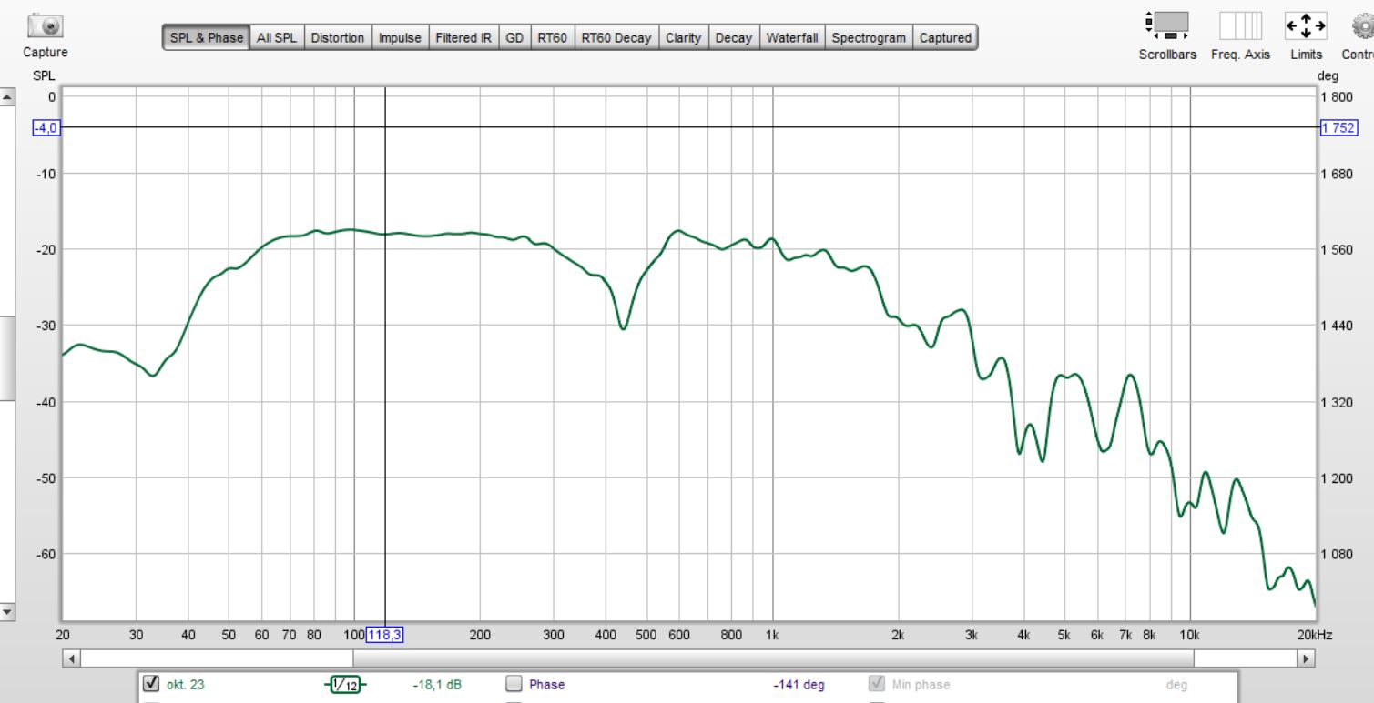

View attachment 1007523 View attachment 1007524
1m distance in room (REW)

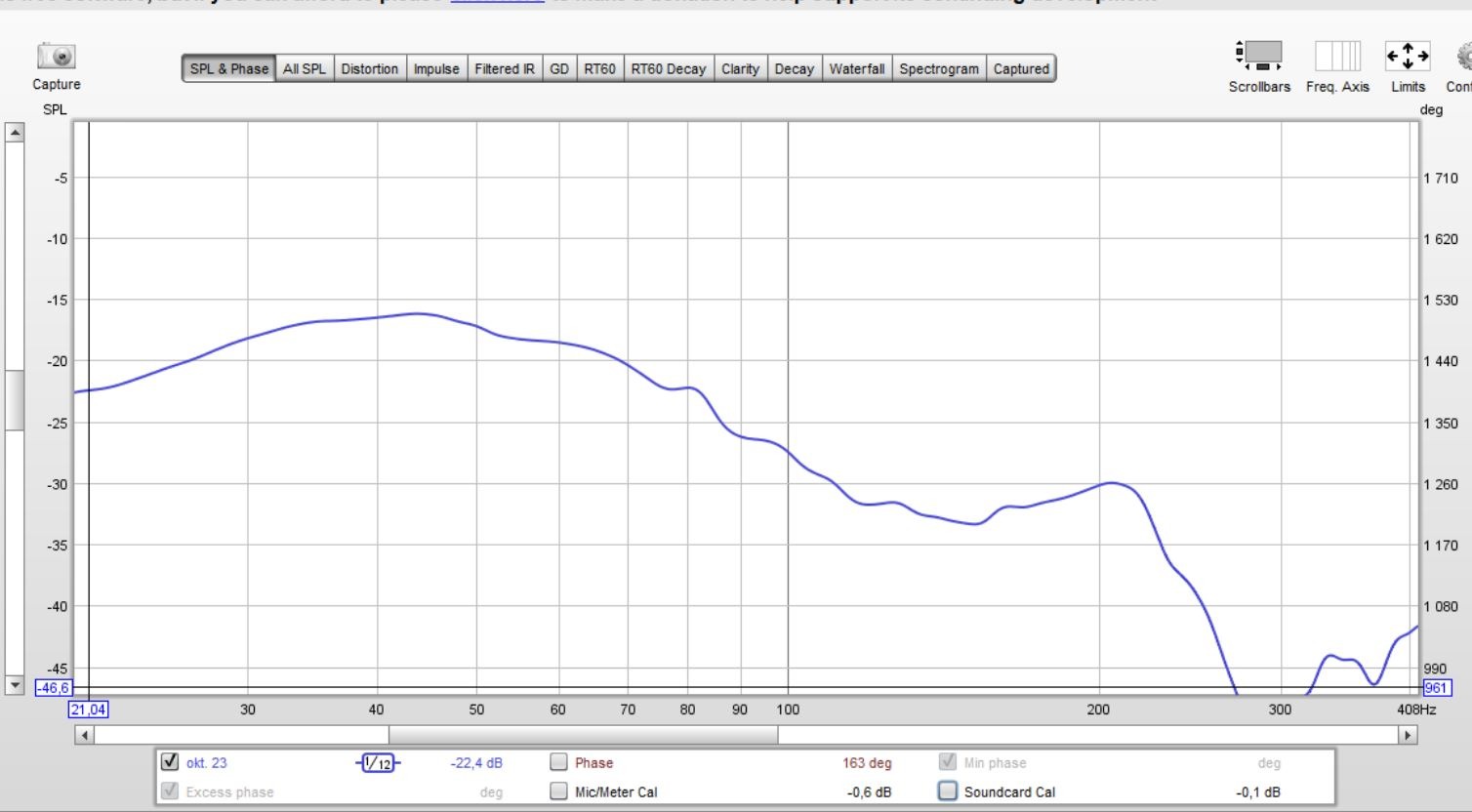

1cm in the reflex port View attachment 1007528
1cm from the bass port
