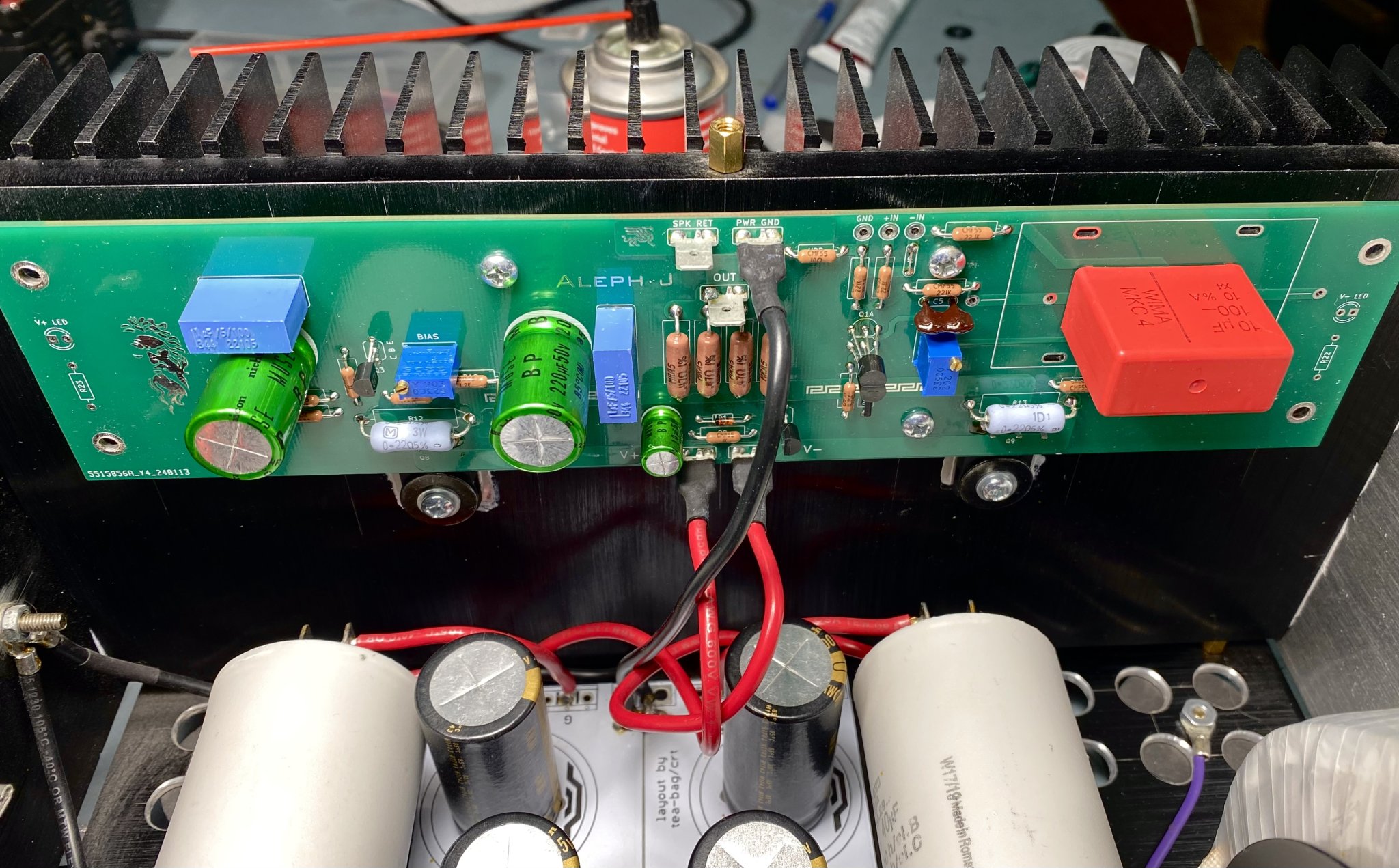

So the powering up of the first channel is a success. Everything is rock stable at 1.45A at this moment. I’ve decided to follow Tungsten advice and put back in the 0.22 source resistor for the SS Jfet. I will listen to this configuration before trying mods. I have also replaced the 100k bias pot with a 20k one since it seem to be enough to bias up to 2A with this Aleph J Semisouth/Irfp150 configuration. I also have a 600ohm resistor parallel with the 2k bias pot.

Good job!!

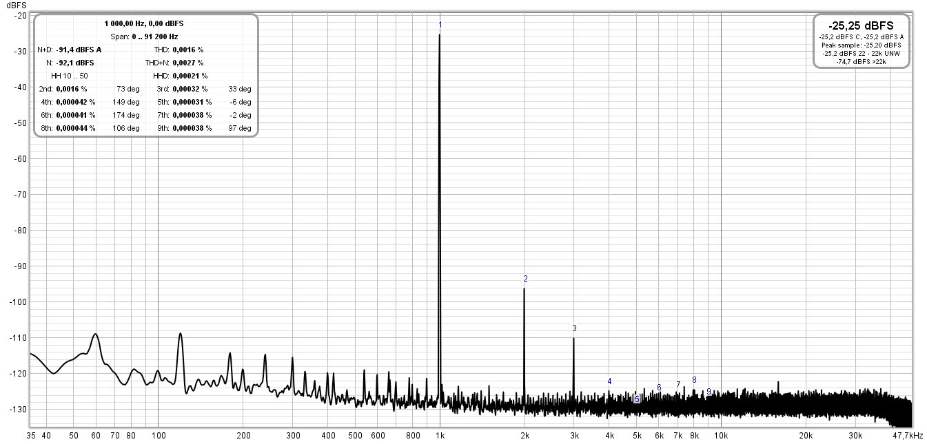

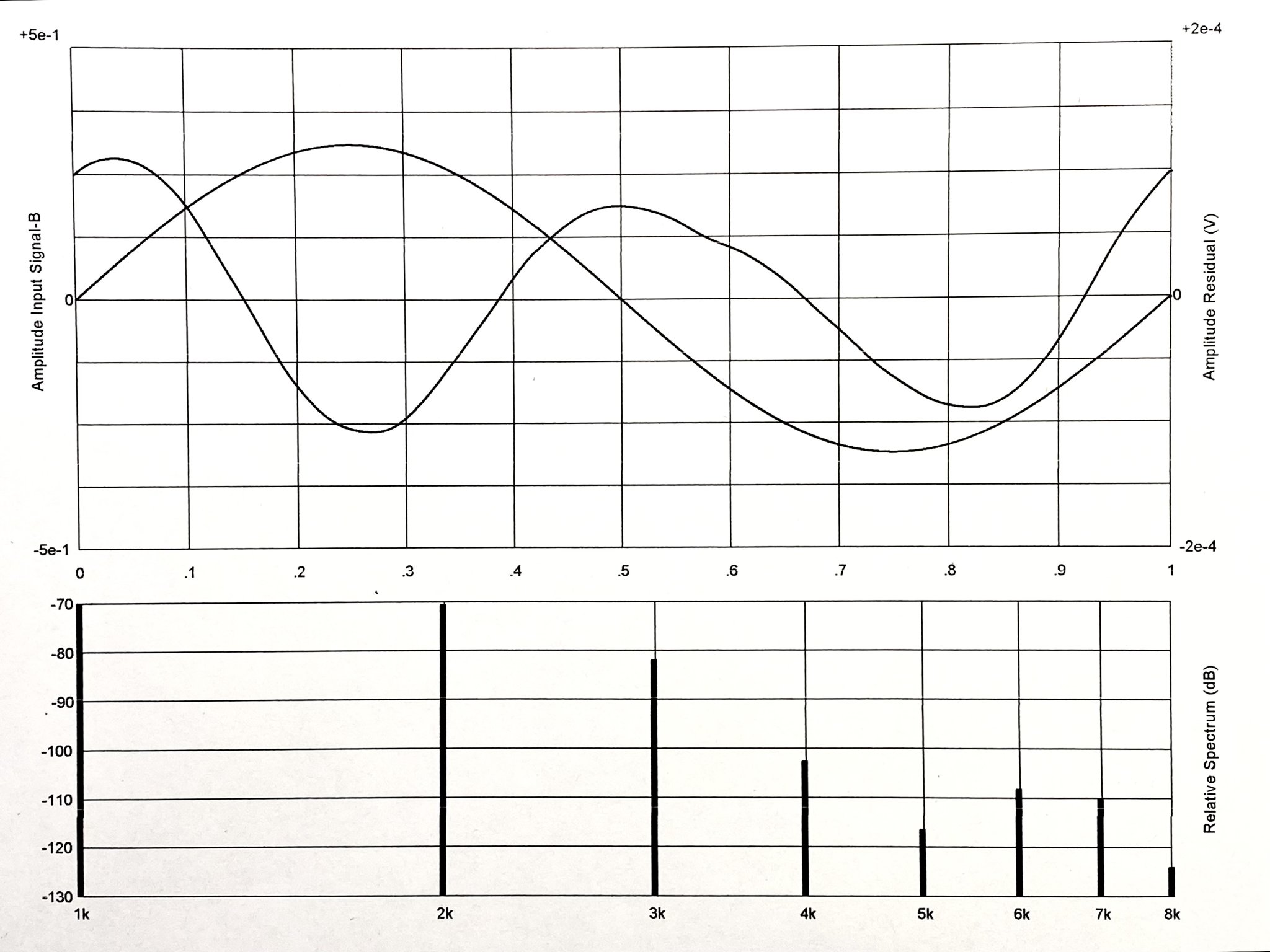

My pair of Aleph mono blocs have been playing music now for maybe 12 hours and they sound great. I’m running them at 1.6 amps with 0.22 ohm up and down and everything else as original schematic. I have been running some test too to confirm that everything is ok, distortion at one watt is really low and negative second harmonic it is.
Prior to this amp I have been listening to the vfet lottery 2sk82 amp for a year maybe. The Aleph sound a little bit darker/less bright and less 3D compared to it at this time. For those who have built this amp, how do you find that the bias change the sound? Or what is your bias sweet spot
Hubert
