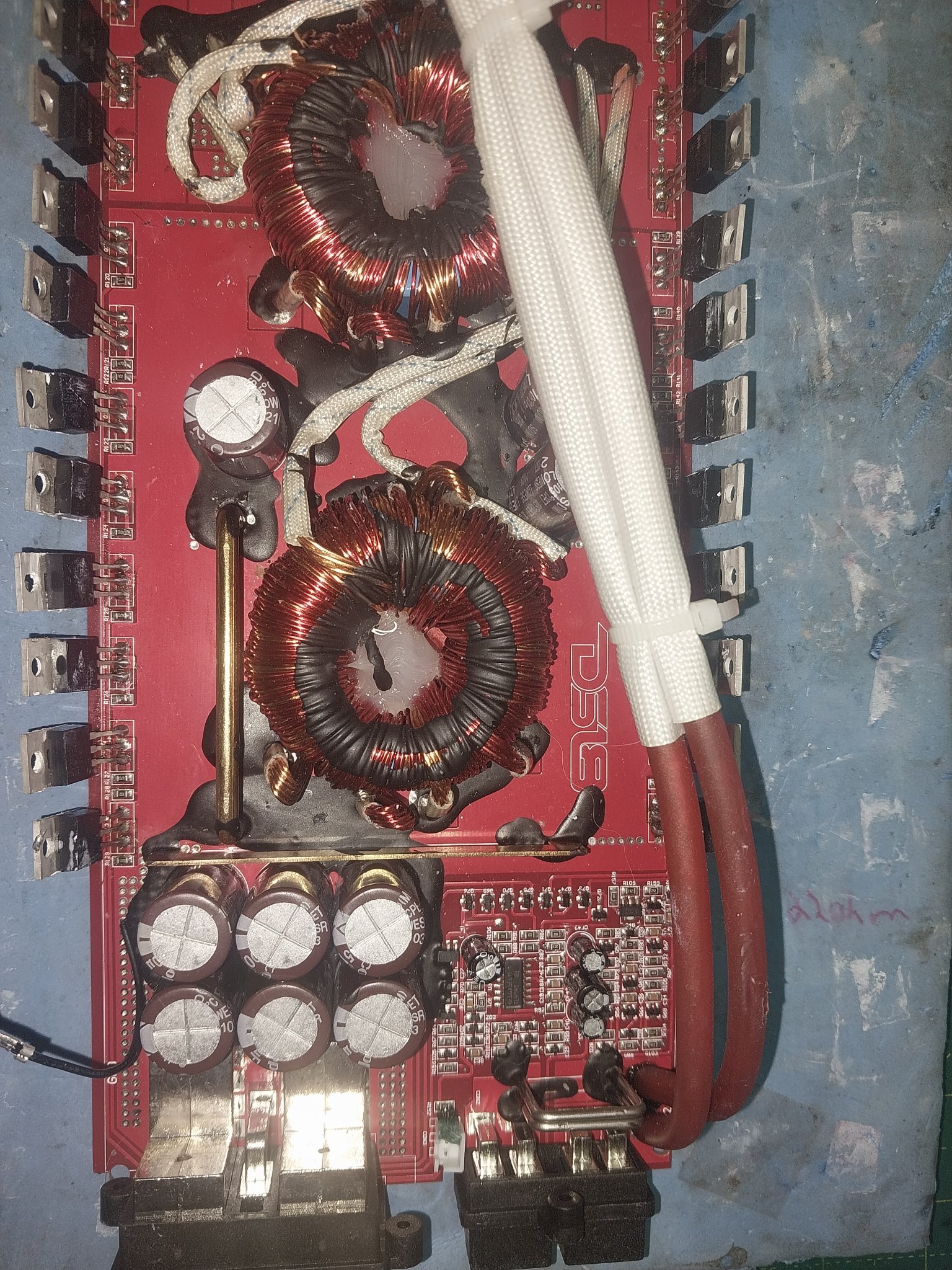

Working on a DS18 ZR2000.1D: Power pulses
Amplifier had blown power supply - Fixed
I removed all Mur rectifiers and power supply works great.
When i installed the rectifiers I get a power supply pulse, like it's trying to start but shorts out and goes into protect then starts over every second.
It starts pulling .680 then pulls 10amp then .680 then 10amp and so on and LED goes green red green red.
I removed all output irf640n and still shorts with rectifiers in.
No shorts on output but on 10ohm gate resistors I read 20ohm.
Can anyone point me where/what I should be looking for.

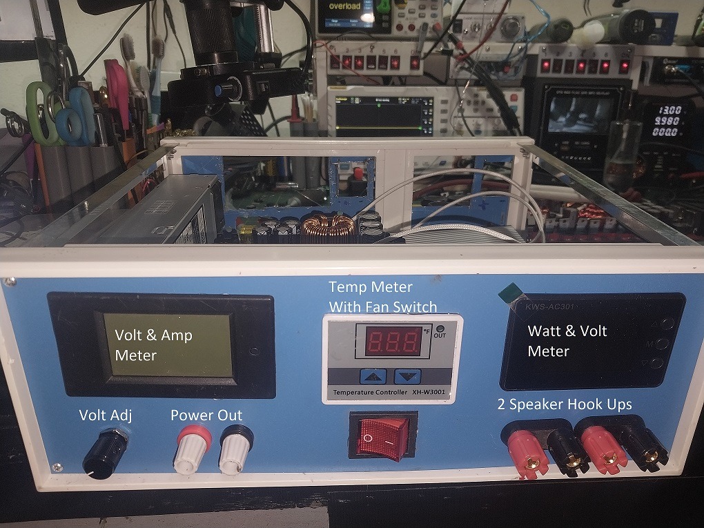

1. 12v - 30v 10amp (This one)
2. 12v - 90v 100amp (custom built dell PS with 2 of these.)
3. 12v - 5amp (old radio shack)
I used the first one for testing because I can limit the current.

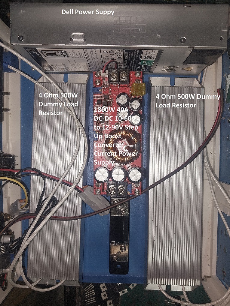

I don't use 90v for amps, that’s the only step up converter I can find that can handle that many amps.
The Dell power supply only has 12v. I wanted to test amplifiers at 13.8v so I use that step up converter.

Current limiting supplies are the bane of my existence. A series resistor (especially with a buzzer across it) is better. No one will use them.
No matter what you use, you look at the gate waveforms to confirm that they're acceptable and note the heating of the PS FETs. Then go to direct (unlimited) power (except a 10-15 amp ATC/ATO fuse). If the current draw immediately goes really high (analog meters on amp meter better), and stays there for more than a second, switch the power off.
To protect the FETs, clamp them to the heatsink. It takes less time to do that that struggling for an hour wondering if things are OK. With a 15 amp fuse in the power line and the FETs clamped, there is essentially no risk of damaging large FET banks (or even single FET banks) from high current draw.

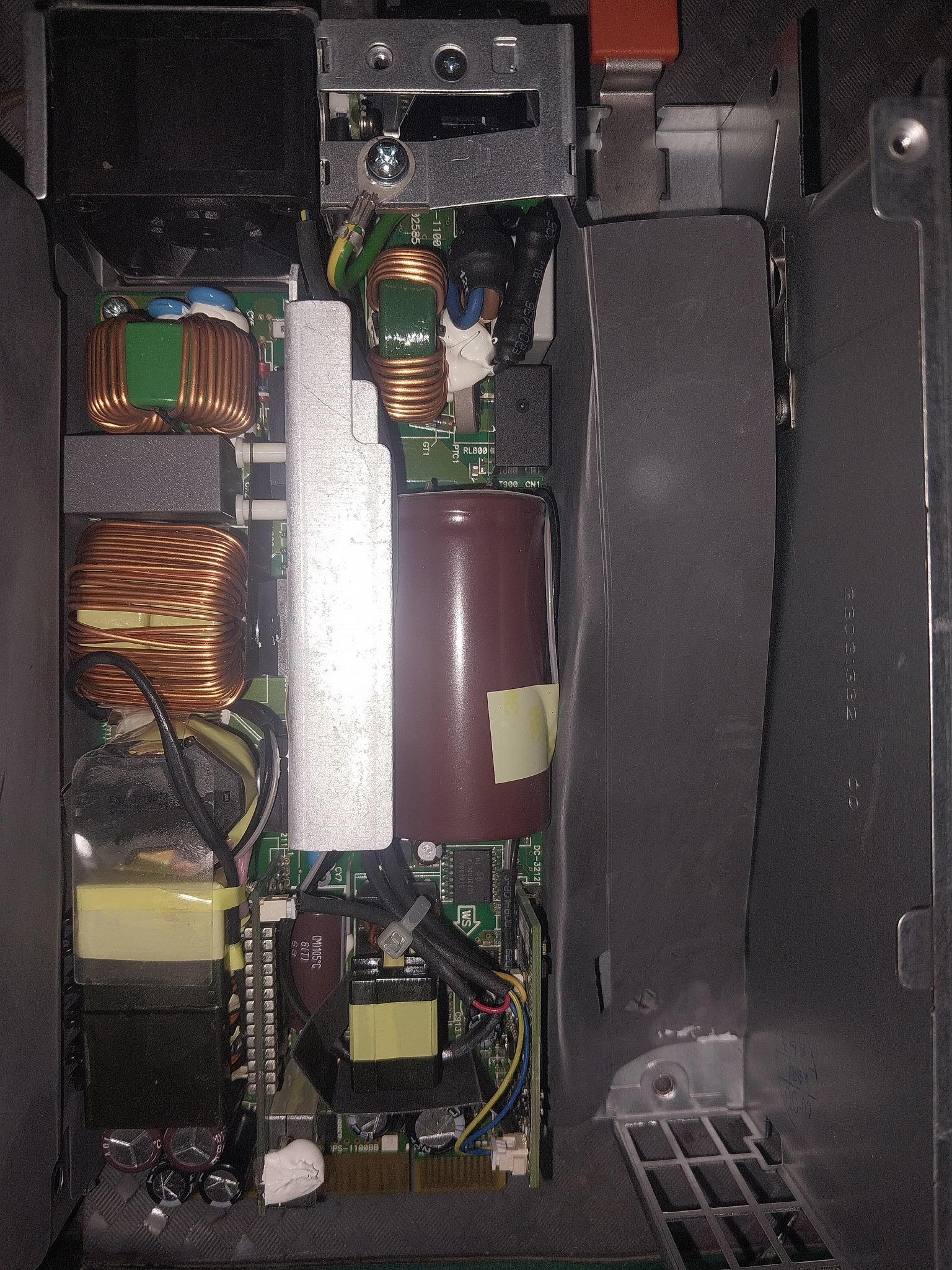

I looked everywhere to find how to adjust the voltage for Dell power supply but with no luck. I did take one apart to see if I could see a adjustable resistor but these had none. I'm not smart enough to wire in a adjustable resister or what needs to be done.

"40 amps isn't enough to test large amplifiers. 250-300w maximum"
I wire 2 of them in parallel to get 80amps, plus use high output fans to keep them cool to push them hard. (no problems yet)

What power supply controller IC is the dell using?
Does this dell supply have external connections to let it monitor the voltage off of the supply? It's like the sense wire on an alternator that monitors the voltage at the fuse box instead of at the alternator's output terminal.

I really don't know anything about these power supplies but I just took the cover off so you can see. (first picture)

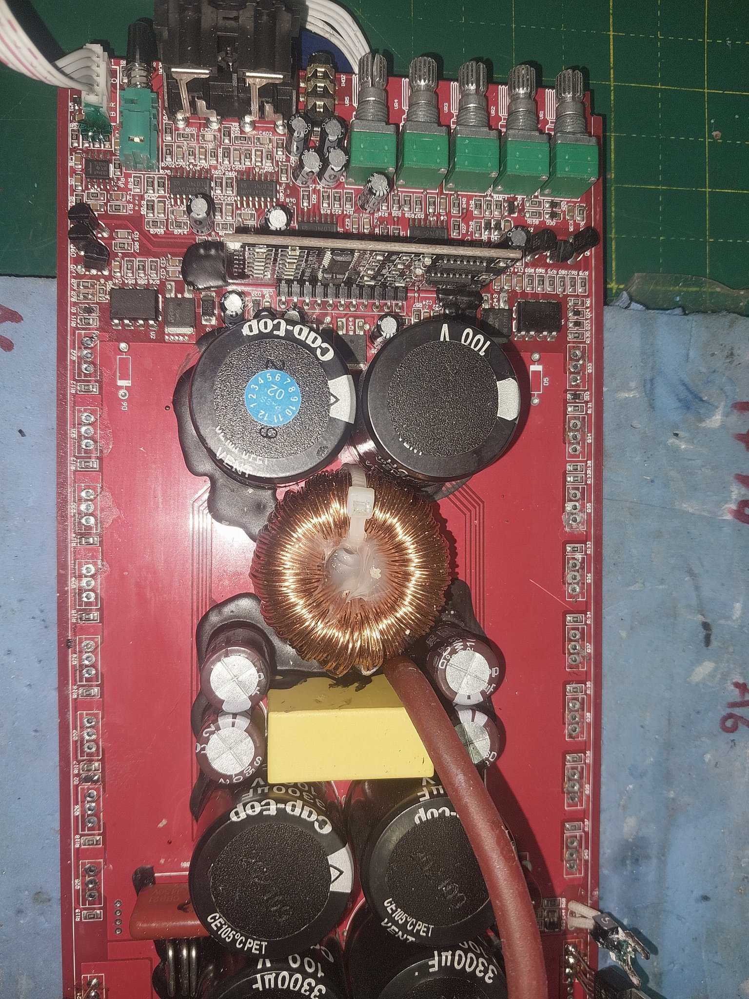

On this DS18 I double checked for shorts but can't find any.
I checked all diodes and resistors and all look good except the 10ohm gates measure at 20ohms.

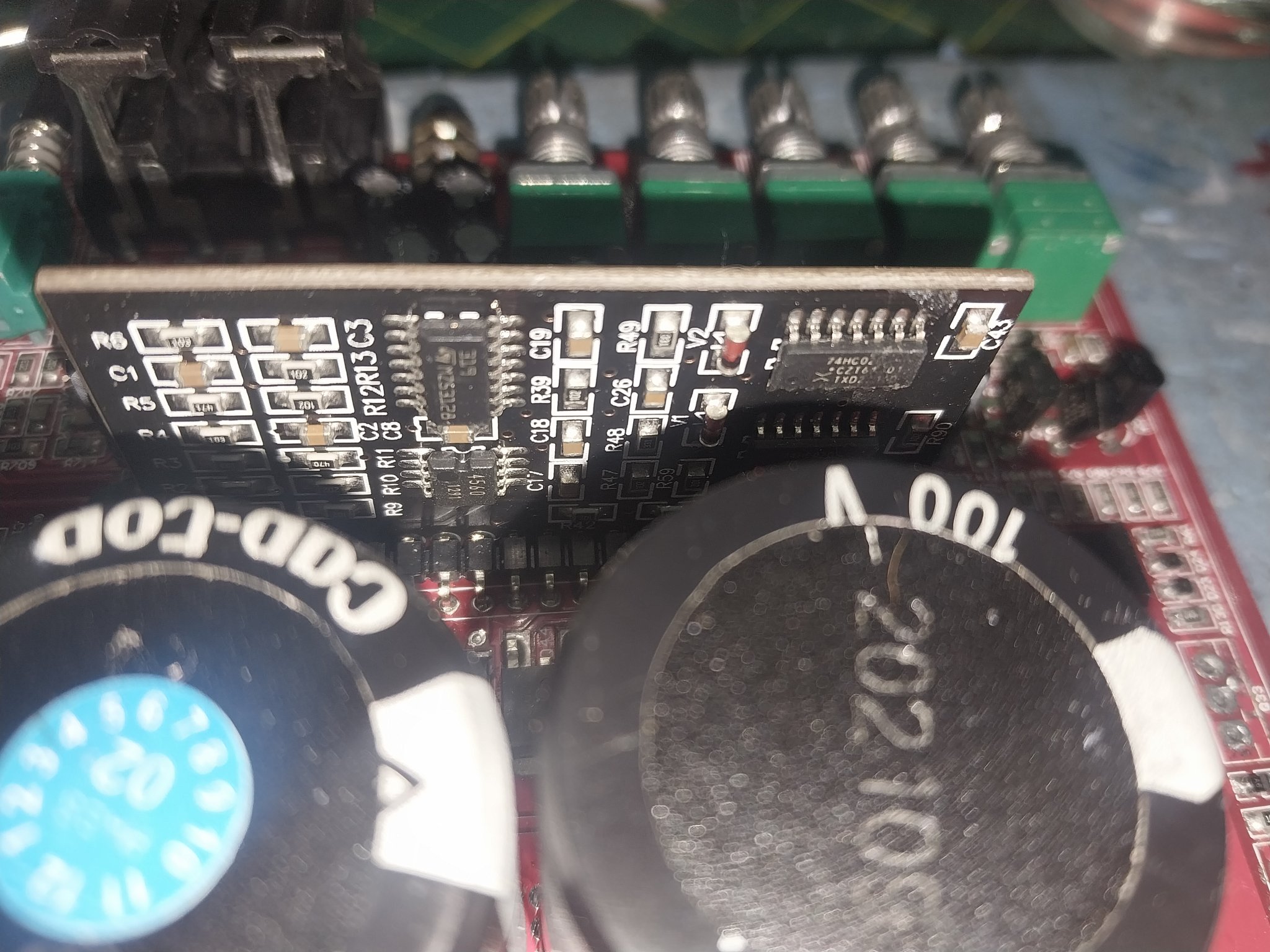

The only thing I haven't done was the vertical add on card. I took a picture the best I can without removing it.
Use a supply that will not limit the maximum current if there is a short circuit with the limiting resistor. 15 amps for the 1 ohm resistor. about 10 amps for a 2 ohm resistor.
The resistor needs to be at least 50w. 100w or greater is better. Use dummy loads if you have them.
Watch the heating of the FETs as the amp tries to power up. If it draws more than about 5 amps for more than a few seconds, remove power.
