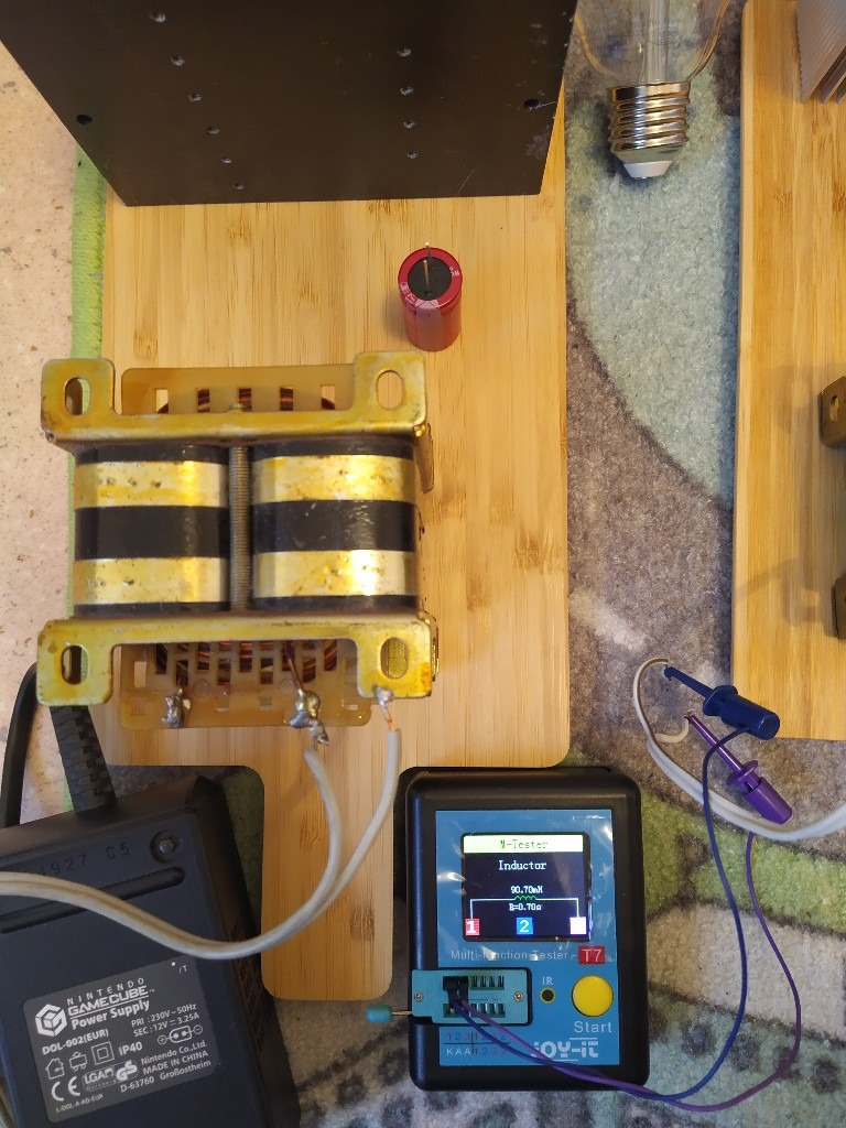

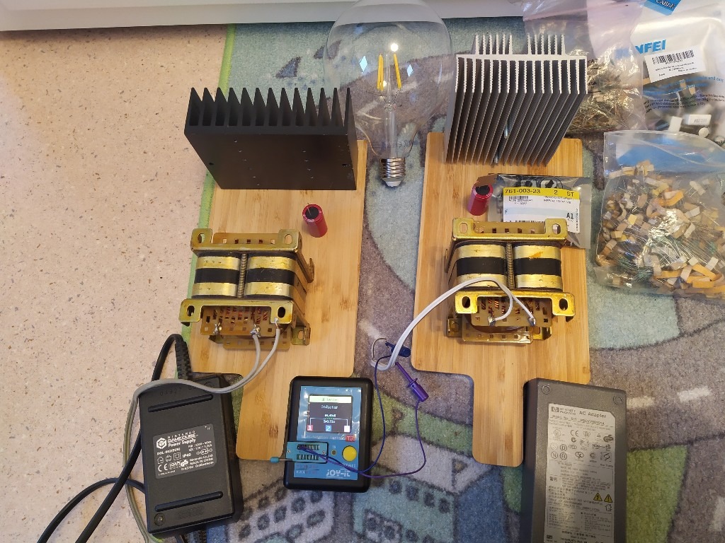

I couldn't sleep. Not because I was thinking about Zen, but I was hungry.
In the middle of the night, I sneaked into the kitchen. Opened up the fridge, took a piece of dried meat. Then, took the wooden board and slowly, silently cut some tiny pieces.
Ta-da!I had a "lightbulb" moment.
I had just realized that I have all the neccesary parts to build the Zenductor :)
This morning, opened up the junkbox. Some heatsinks (too small for "normal" amps, but may be just ok for the Zenductor)
Two 12V switchers that just sat idle.
Two 90mH 0.8 ohm inductors, and a fistful of parts.
So, do I need yet another amp? My reason says NO.
But...
And so it goes :)
Ah, the lightbulb. It serves nothing, but it would look really nice to have a lightbulb (a real one, not LED) instead of the inductors. But then, would need a much higher power supply voltage, and then I couldn't leave it naked...
But hey, I might mount two big, dim leds, just to know that the amps are on.
Why not? :D
