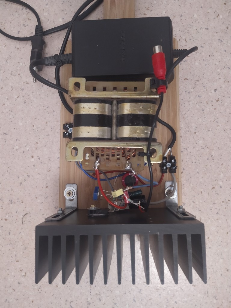

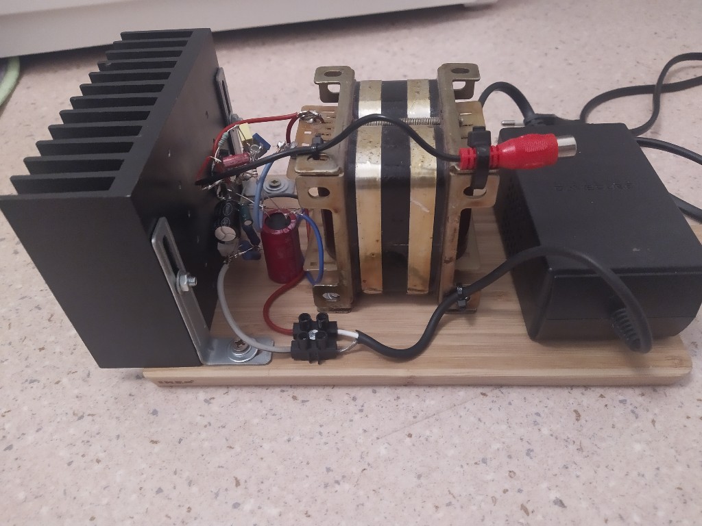

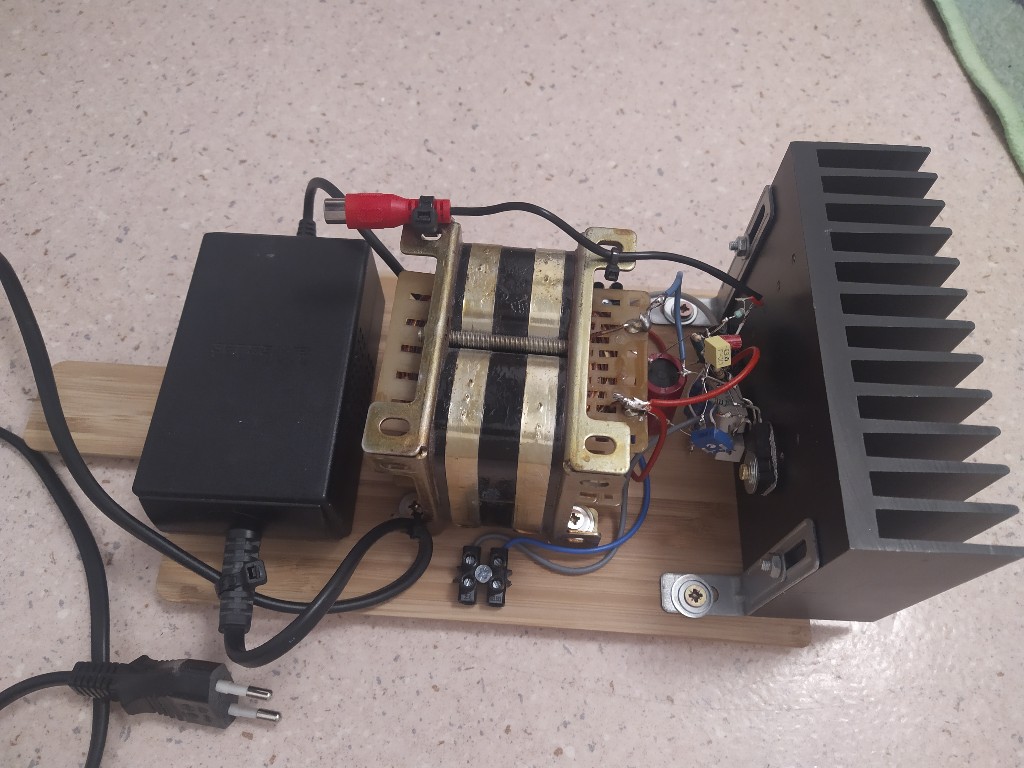

How are you going to slice your midnight snacks now that your cutting board is an amplifier? (Nice build!)One channel done...
Not yet. In fact, I have not fired it up yet. Watching a movie now. I prefer to double check everything the next morning.Have you listened to it?
It happened to me before, in the evening it (she) looks ok, but the next morning, you ask yourself....
So, more about the sound tomorrow.
Also, gotta build the other channel. Unfortunately, it will be uglier because I don't have the same heatsink...
Gee... it works
And it sounds nice too.
I was pleasantly surprised, especially by the bass. A Mini-Zen, sort of.
It gives an impression of listening to a much bigger and more powerful amp, that is, until you crank it up. In the car analogy, it reminds me of a feeling when I was driving a Chevrolet Spark, a small city car. Fast it was not, but had a very nice acceleration from 0-30 mp/h. After that, oh oh. But it was fun to drive, within its limits.
So, I adjusted the bias. Let it to warm up for an hour. Not much drift. Im my case,the heatsink was just lukewarm, even after an hour.
Next, I will try it with a 19V psu and 1.5 A current, because I have a feeling that the amp begs for it
For those of you who are still in doubt, just build it

Update:
I tried the 19V supply and 1.5 A bias. Now it sings!
It was well worth it. I adjusted the voltage drop on the Source resistor at 750 mV. Initially it was around 720 mV, but as it heated up, it climbed up to around 750 mV and stayed there. The heatsink now served a purpose It got hot but not too hot (I could keep my hand on it).
So, if your inductor and the heatsink can keep up with the higher voltage and current, I highly recommend it.

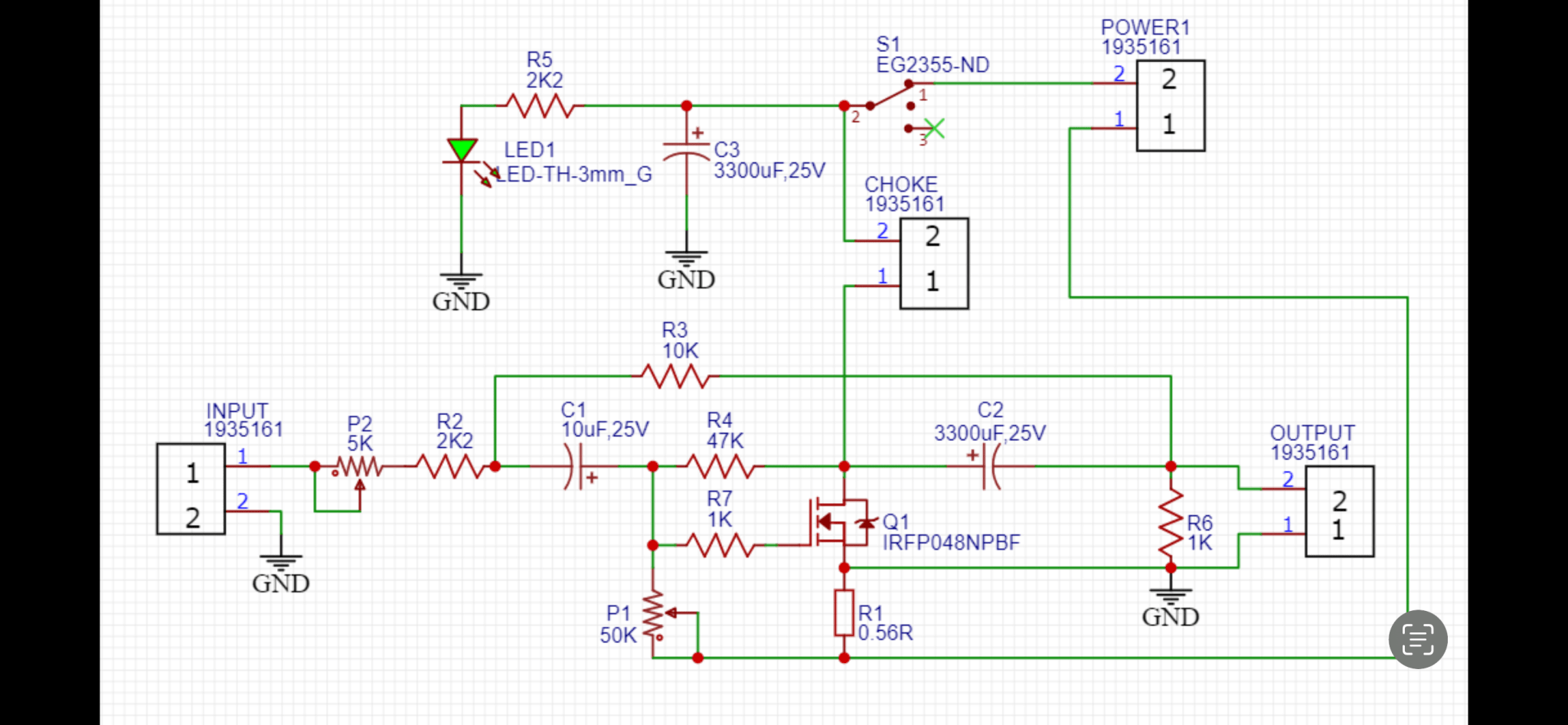

I just have to mention that my version was a bit different from the original (I accomodated the parts that I had in the drawer):
-Inductor: 90 mH, 0.8 ohm dcr
-Bigger heatsink
-IRFP240
-4700 uF output cap
-2.2. k and 7.5 k as feedback resistors
19V supply, 1.5 A bias
While testing, I used my phone as a source, and, as I could not get enough gain (and did not want to alter the feedback resistors) I took out a Frontend 2022 Preamp.
Wow!
I spend the evening listening to mono
Gotta build the other channel. And then compare it to MoFo...

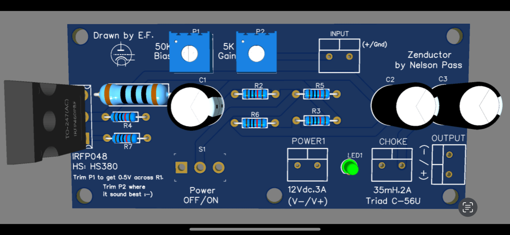

I wonder if the bass response would be different if you would of used the Choke from the BOM (Triad, 35mH, 2A)
Eric
