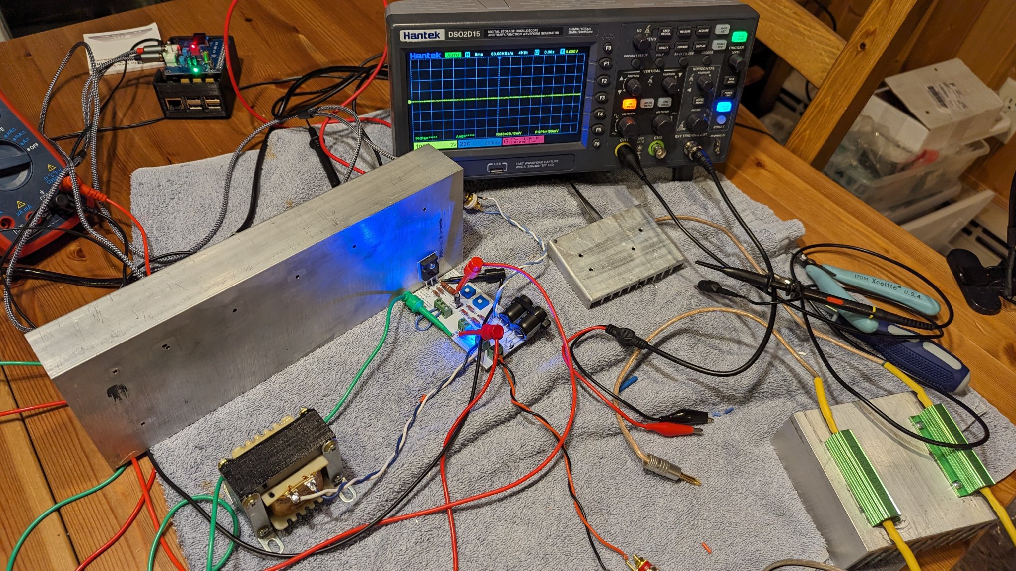

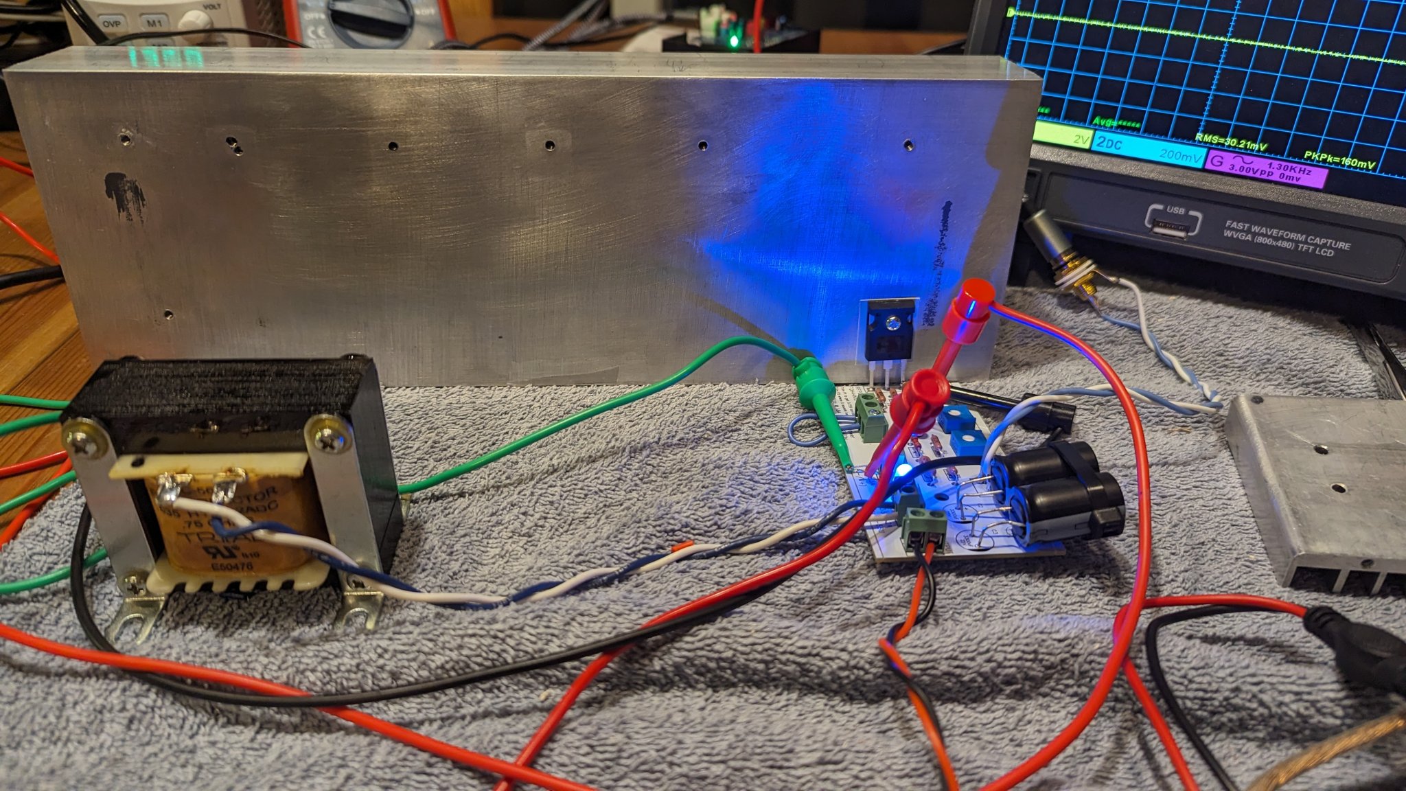

Maybe my function generator is not up to the task…the negative waveform starts to distort at -1 Vpk..while the positive stays undistorted up to + 19Vpk
My output device is FQH44N10.
I have to buy better equipment before I continue testing.
This is what I see with the equipment I currently have, maybe one of these instruments is not working ok.
Something is not working properly if the output is distorting at such a low output voltage.
You can check your signal generator/oscillator by checking its output with the oscilloscope. You can then also check the signal/generator connected to your preamp (if you used a preamp in your amplifier test) with the oscilloscope. If they all check out, then the amplifier is suspect.

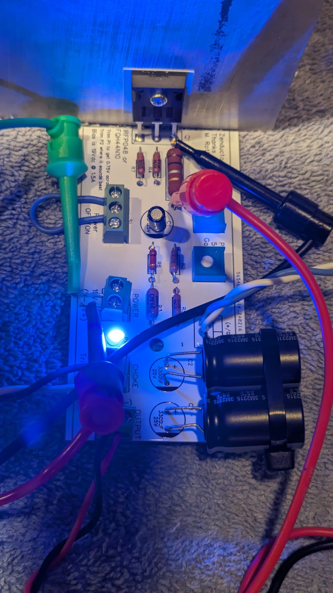

Have you had a chance to measure the output power into 8 ohm (just before clipping) when biased at 19Vdc, 1.5A
I tried to check it earlier but the clipping was asymmetrical (more than usual) the negative part was clipping way earlier, it got better when I increase the bias but I’d rather keep it at 1.5A
Is there anything I can do to reduce such a big asymmetry when it clips ?
